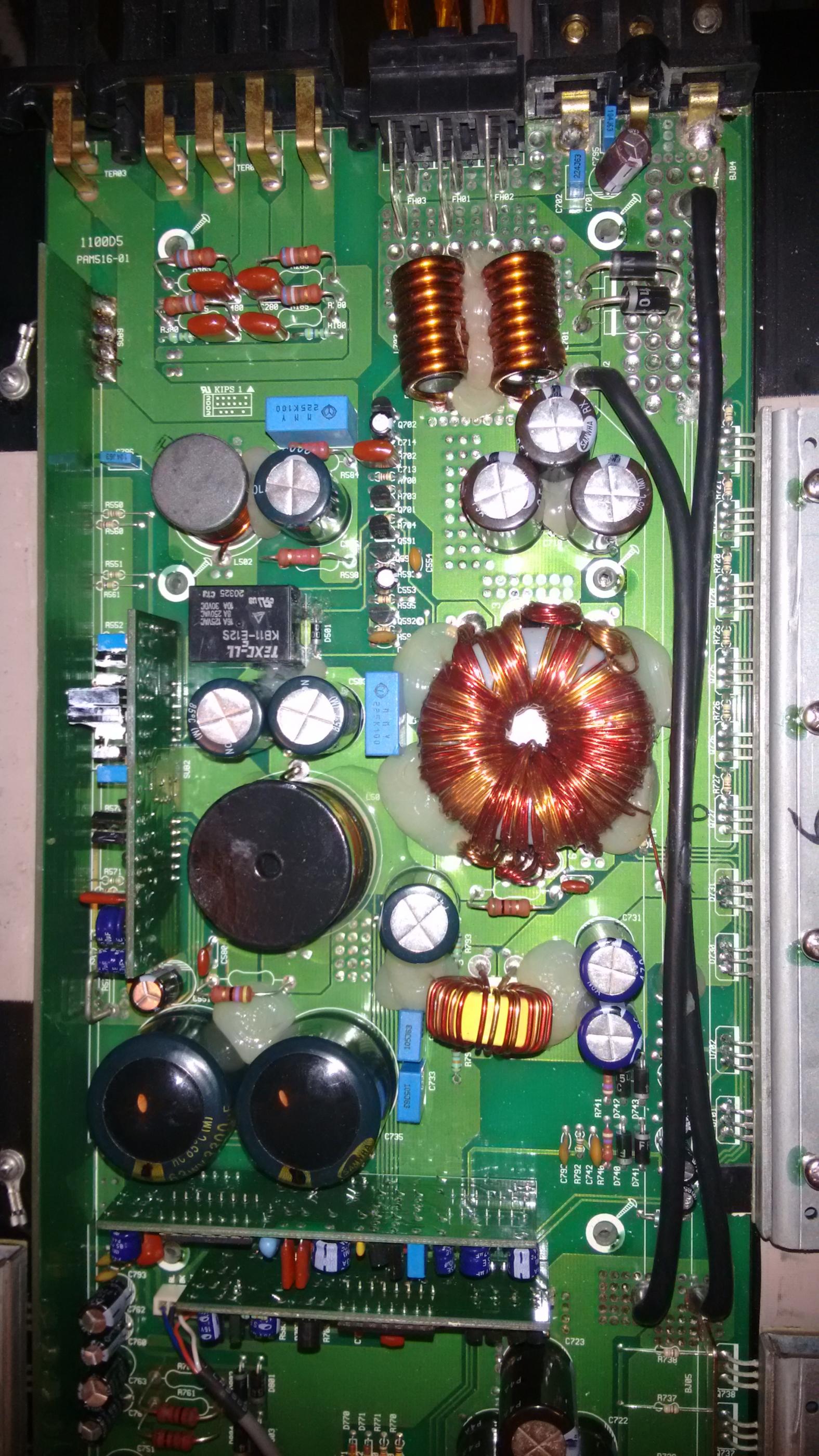

I am in need of help with repairing a Directed 1100d5 amplifier. There is a problem in the class D sub section that causes the amp to draw high current. I have tried to repair it using the Search function but was not able to succeed. I may just need new outputs for the Class D section but I would like to confirm this before purchasing and replacing said parts, just in case they are still good and my problem lies elsewhere.

On the bench, I removed the rear channel outputs (TIP 35 + 36) and the sub section outputs (IRF640 + 9640) and the protection light went out, green light stayed on and front channels played fine. Ended up replacing the TIP 35 + 36 Transistors again which got the four channel section playing again without distortion and the green light stays on as long as the Class D section is disabled in some way. If the outputs, or rectifiers are out of the circuit, she will power up, relay will click on and the green light stays lit while the A/B section operates normally. If the Class D section circuits are complete, the amp will power up normally but as soon as the relay clicks on the current limiting bulb will start to brighten and the green light goes out but the red(protection) light will not light up bright. Both lights however go dim as if the whole amp is shorting out. I currently have the IRF640 and IRF9640 outputs removed and amp is normal except for no bass channel.

It would appear that both power supplies are functioning properly since the amp powers up without protection and produces rail voltages once the Class D outputs are not in the circuit. Can someone please provide some assistance and tell me what to check next. If everything seems ok and should work properly with just purchasing and replacing the outputs, please let me know. I don't want to damage anything else and I also don't want to purchase parts not needed since I have other things that money will be better spent on. Sorry for the long post but I tried to be as thorough and concise as possible. Thanks in advance...

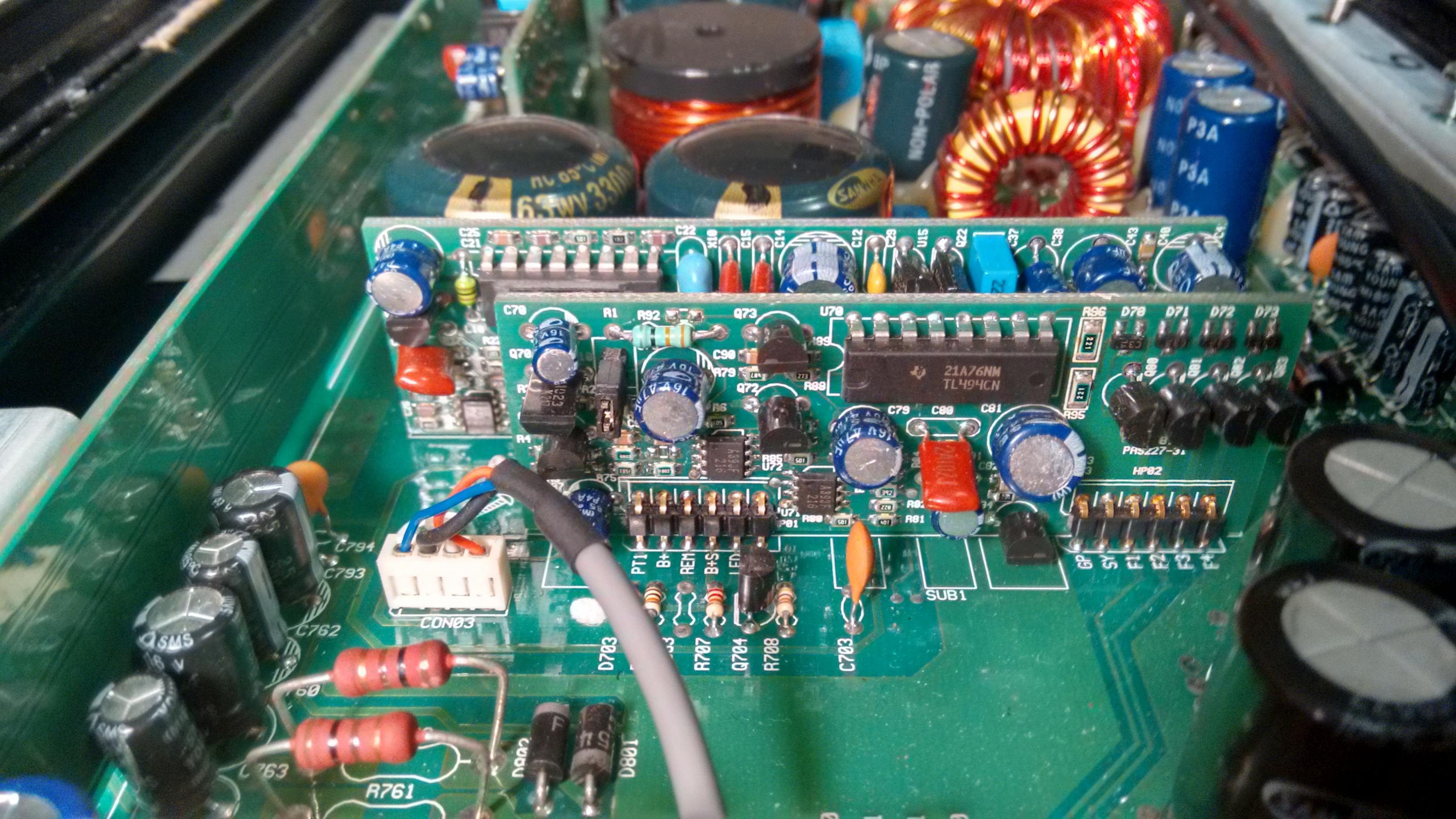

On the board behind the board with the TL494, you need to find the 8-pin op-amp that's the equivalent to U151 on the following diagram. The component values may vary slightly and the circuit board designations won't match but you should be able to find the IC.

OK, would like to update the post for future reference so that others may possibly help their own similar situations. I did test the opamps located on the vertical driver boards and everything read correctly regarding the + and - inputs etc. I then suspected that my problem concerned the output FETs since everything else checked out. I played around with the number and order of the five p channel FETs and was able to get the amp playing continuously using four of them but installing the fifth one would always cause the amp to go into protect and the current limiting bulbs to illuminate full brightness until power was disconnected. So I went down to my local electronics store and requested 5 irf9640s from the same batch with similar specs. It took a while as I tested the FETs with my multimeter until I got 5 identical transistors much to the growing annoyance of the sales staff. I ended up with readings of 750, 752, 753, 754, 754 which means they are much closer than the previous ones. I put the new ones in and bench tested the amp. It now makes bass with minimal illumination of the current limiting bulbs and they no longer stick at full brightness and amp no longer goes into protection. Amp has been put back into the vehicle and no problems at present. The lesson that I have learned and would like to share is the importance of components with similar specifications, especially in class D amplifiers since it was working at low load but gave trouble when the load increased. Thanks for the assistance DIY...
