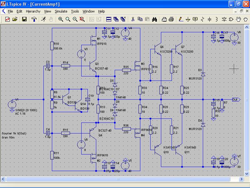

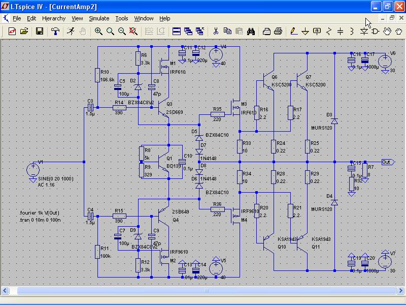

Hi all
I come to this forum because here are more kind to me.
I need to know which is more stable circuit, DC offset, and thermal.
It's for a 25W Class A amplifier.
Thanks a lot

Thermal stability depend of the low frequency gain between the thermal sense (Vgamma multiplier) and the output transistors, and the thermal coupling. The bigger the last, the better stability. Appear that circuit #1 has more DC gain.
Hi Osvaldo
Thaks for your feedback, but cicuit #1 has the Vbe multiplier at the base of the transistors, can it helps with DC offset?

It seems unnecessarily complex. I think you could eliminate the Q4 Q4
stage altogether and just use the Mosfets to driver the output followers.

Hi Mr. Pass
I am honored by your support, but I attempted to do so a few months ago, and the square wave response was so bad.
Note that cascodes are yours.
What do you think about DC offset stability? +/- 40V come from a regulated power supply.
