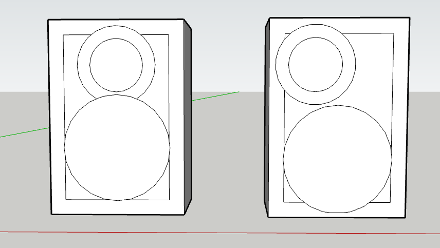

...I need to buy a decent circle jig. I am in construction and own a roofing company, so tools and working on projects with alignment and plumb are not foreign to me. A side note parts express, said that I could for making room just set the tweeter slightly off center if I cannot get the speakers to fit.
The Jasper jig is so convenient, and while its not really expensive it is still a waste if your only going to use it once. If you Google search, there are a lot of simple DIY circle jigs out there. You could probably get by with a hole saw and maybe a rabbet bit if you had those on hand.
Pictures below show the overlapped drivers and the "slightly" off center tweeter. While offset tweeters can have some advantages (and some disadvantages), this doesn't look very good to me. Also, a waveguided tweeter like this isn't really going to benefit. If you can get the overlapped drivers to work, I think you will like it better. In this screen shot with the overlapping drivers, the tweeter is centered 1 1/2" from the top and the midwoofer 2 1/4" from the bottom.
Will you round over the sides with a roundover router bit? You can see that there isn't quite enough room on the edges for a 1/2" round over, but you could do 3/8". This would be more for looks, as (1) a small round over doesn't really do much for diffraction and (2) roundovers also make less difference for a waveguided tweeter.

I will be going for the overlaped set up. I get my boxes tomorrow 😊 excited!!! I also received my xovers and port tube today. So we are a go this weekend to start the cabinets.

The reason I suggested a 3/8" roundover is that you can see in the pic, the width of the FE85 doesn't quite leave 1/2". BUT...sometimes a 1/2" roundover doesn't quite go a full 1/2". So once you have the driver holes, you can drop the FE85 in and see if you can pull off the 1/2" roundover or not.

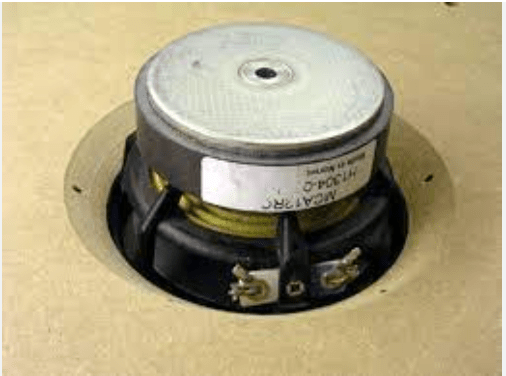

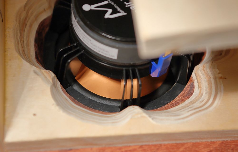

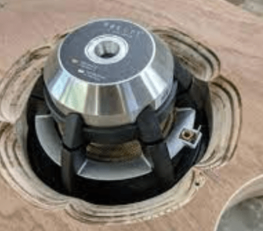

I usually use a 45 degree chamfer on the inside of the speaker openings. Typically, I leave a little material where the screw holes are which creates a "scalloped" look like the picture below. With a tiny 3" driver that may not matter as it doesn't weigh much at all. A cove bit also works. A roundover might work, you'll just want to drop the driver in afterwards and see - does it look like it can "breath"? It's usually pretty obvious if the driver looks like it is sitting in a "tunnel".
