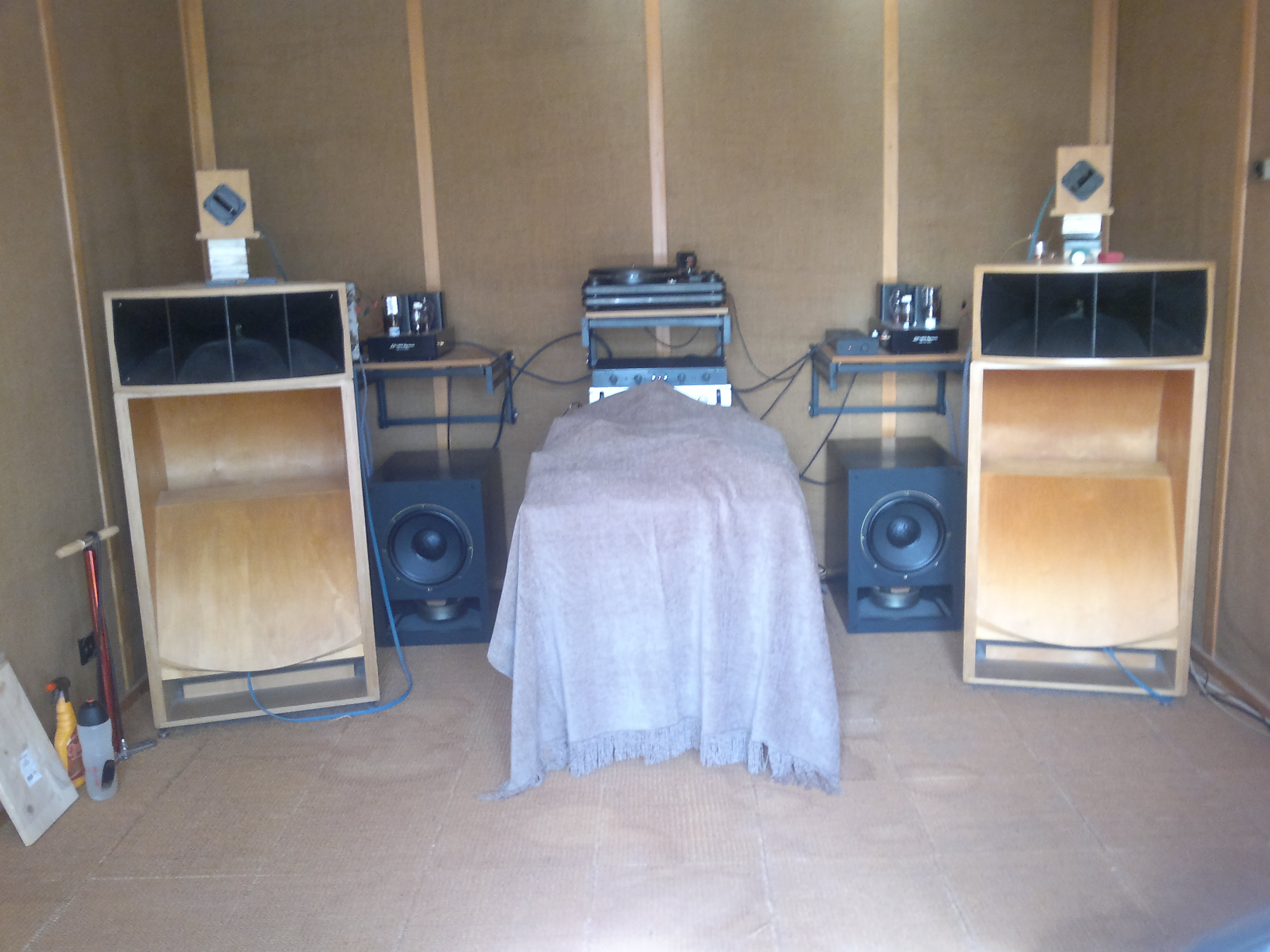

hi everybody, maybe somebody is willing to help me!
right now i listen to a scaled down version of the living voice air partner.
(if somebody is interrested in the dimensions, sorry, i promised to the guy who helped me years ago not to publish it. please dont even ask)
bassdriver vitavox mm300, 12".
midrange vitavox s2 with rh330.
treble jbl 2405.
500hz, 10khz
source:buff III, s&b tx103 transformer, choke loaded 5842, diyhihisupply 300b, lady day(310-300b)
no phono at the moment, working on the dac and needed the stepup.
room is small, 3,5m x 5m x 2,5m.
ft:10 x 16,5 x 6,5.
one thing:never trust somebody who says you cant listen to a horn like this nearfield, its sounds wonderfull!(3m, 10´away).
i´m quite shure it would sound better in a larger room, but even in my listenining room it is fantastic!
you may wonder why i would change the bass horn:
got 2 gpa 8hp woofers for a very good price and searched the web and of course this forum.
515 midrange should be very good.
my horn is folded, a straight one like the exemplar horn could be better at higher frequency?
listening mainly to acoustic blues and jazz, sometimes 70s rock.
something like the exemplar would bring the rh330 down 6-7", would be good i think because i am listening that close. the rh330 would be on ear-height and this sounds definitly better in my room.
the horn should go down to around 40-50hz, low enough in my room. i have 2 m&k 5000 subs, but they are not connected, dont integrate well.
tried the subs with active xover and software, did not like it.
(btw, i dont like to touch the data anywhere, convert pcm to dsd or something like this.... for me it sounds best as it is, playing pcm as pcm and dsd as dsd)
i´ve build the "air partners" but i had a plan.
just downloaded hornresponse, but i have no plan😱
IS IT WORTH EVEN TO THINK ABOUT A CHANGE?
thx, klaus

Klaus,
The Exemplar horn looks like it may be a better match for time aligning the compression driver to the cone driver.
Straight horns are generally a bid better in the upper mid range, but you certainly won't convince anybody that has heard a spiral horn like the classic Western Electric horns that they did not have a good midrange.
Those horns used one driver, which eliminates the time alignment and crossover filter issues that multiway systems need to address for accurate sound reproduction.
If the horn outputs don't line up in phase at the acoustic crossover points, they simply will lack the coherency that is possible.
The wavelength of 500 cycles is about 69 centimeters, to be within 1/4 wavelength requires the path length difference to be no more than 172 mm.
Have you tried moving the 511s back so they are in time alignment with your present mid horns?
Acoustical time alignment also may require a polarity swap depending on your crossover, and may not exactly correspond to the physical path length difference.
The reason the subs did not integrate well could also be a time alignment issue.
Anyway, unless you are just itching to make some sawdust, I'd suggest working on time alignment before you EVEN THINK ABOUT A CHANGE in cabinets.
One other detail- if the unused subs terminals are not shorted, they may presently be acting as bass traps, further reducing the output of the folded horns.
Art

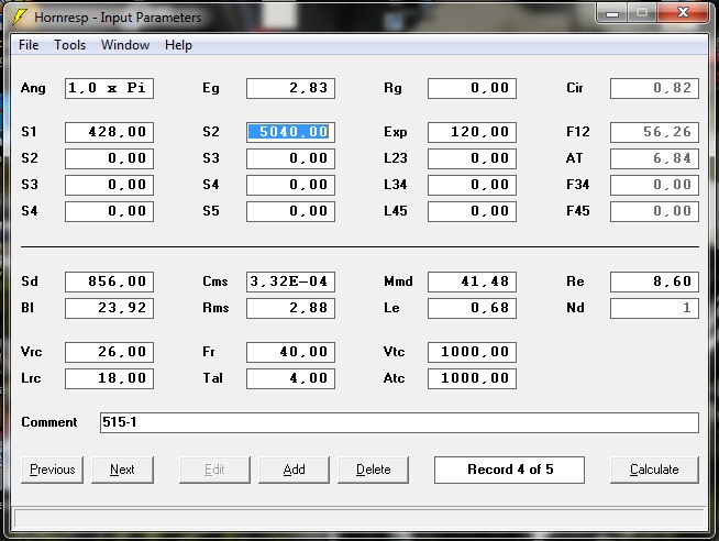

i played around on horn response, got the results in the attached pics(maybe somebody could the check the input parameters for the 515-8hp?)
i have no equipment to measure my speakers but i listened to some test tones last night.my speaker rolls of earlier than the horn in the simualtion, but the rolloff is not that steep(the open rear chamber?). 50hz is way down, maybe i can get the same lf-response with a straight horn(and it should be way better between 70-100hz)?

Chaos,
one thing to remember is that all horns have a downward slope to the curve above a break point in the response curve. Depending on the curvature of a bent horn this will come about earlier in the response curve than a straight horn but if it is a simple smooth curvature it shouldn't be a severe difference. I can't comment on how much a difference there is between a conic horn and an exponential horn in this regards, but because of the improved loading of an exponential horn at lower frequencies it could be greater with this type of design.
I would definitely go with an active crossover, it will be easier to get things right and a delay function should be easily implemented with that type of design. The only problem is you will need multiple amplifiers rather than a single amplifier using passive crossovers.
