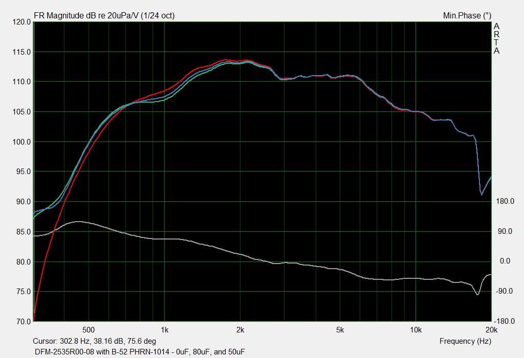

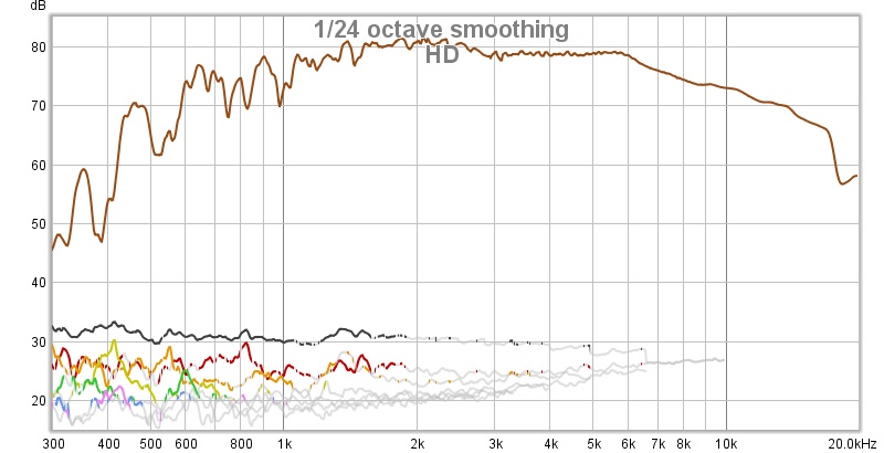

1) When taking measurements of the WG + driver, is there is a need to include a series capacitor to protect the CD? I'm not measuring at loud volumes on anything. I should have asked this question before, but I ended up taking a few measurements already.
2) If the answer to the above question is "Yes" - would it not impact the measured phase? I'm currently measure using ARTA's semi-dual method. If I use a 50uf or 80uf - it seems to impact the response (albeit slightly). How does one typically account for the impact of the protection capacitor on the measured response and phase, when one gets to the crossover design stage.

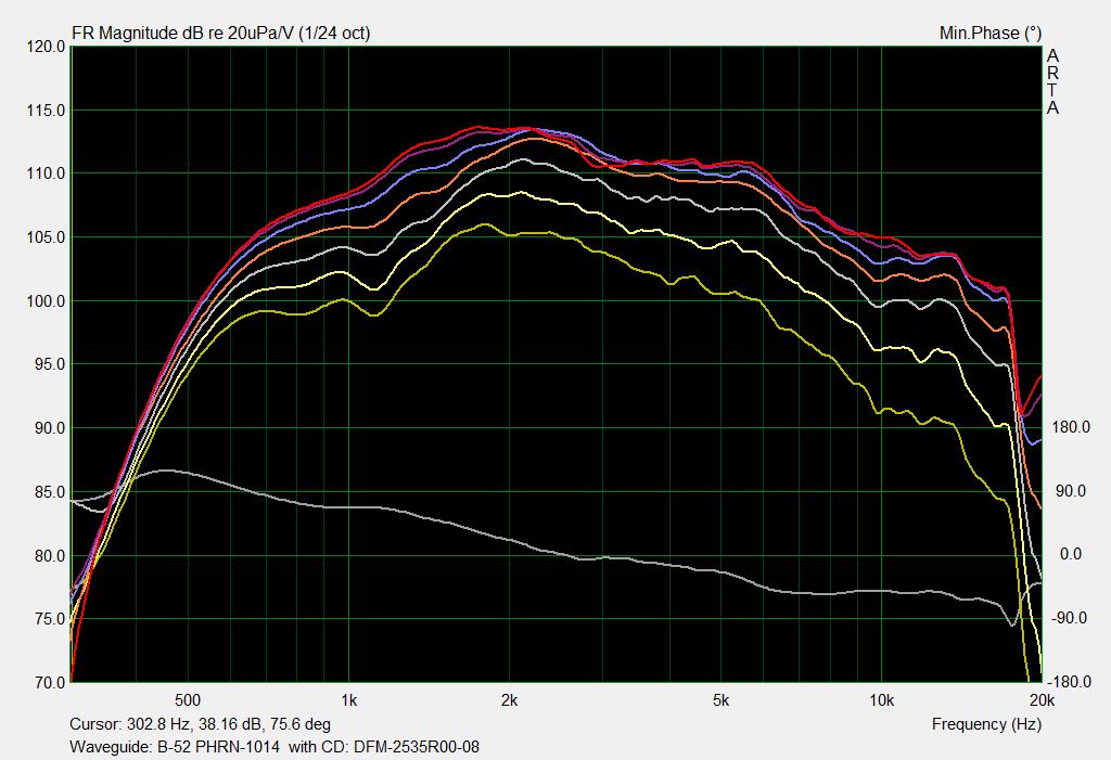

I've attached a couple of measurements, one showing the impact of including a protection capacitor, and the other showing the off-axis response to 60 degrees. - Please disregard the SPL Magnitude - I didn't take these measurements at 110db.

I'd personally aim initially for about 1.1k or 1kHz as crossover, but exactly where will depend on the measurements you make of the drivers in the cabinet. You can make measurements of a CD without a protection cap but, of course keep the level reasonable. I even do it at the 2.83Vrms standard level, which is quite loud. Ask my wife!

DK,
I'd think very carefully whether or not to trade this raw response
for this one .
That second curve will require a bit more tonal shaping ( iow; 2 to 3 PEQ notchs ) to hammer into a flattish response ( though it's eminently do-able ).

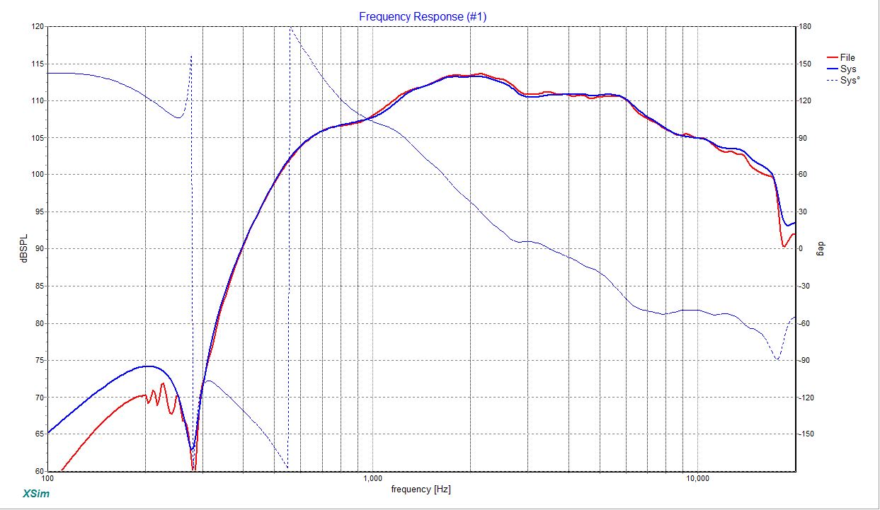

The ( proto ) introductory thread ( created over at TechTalk called Impressive New Compression Driver where we put the Tymphany DFM2535 through it's paces also produced a pretty consistent opinion that the driver would be easy to EQ & HiPass due to it's quite linear response and low Fs .
Here are some examples :
and
and
and
You'll recognize the 4th pic in the series as an XSim prediction .
The point of all my XSim predictions was to show how easy it is to get good looking HF curves using the Tymphany 2535 on the PRV ( 152i clone ) .

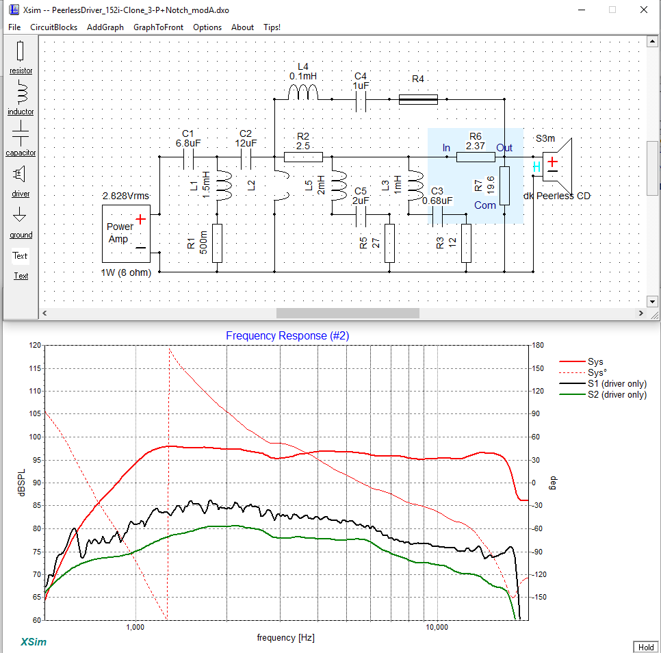

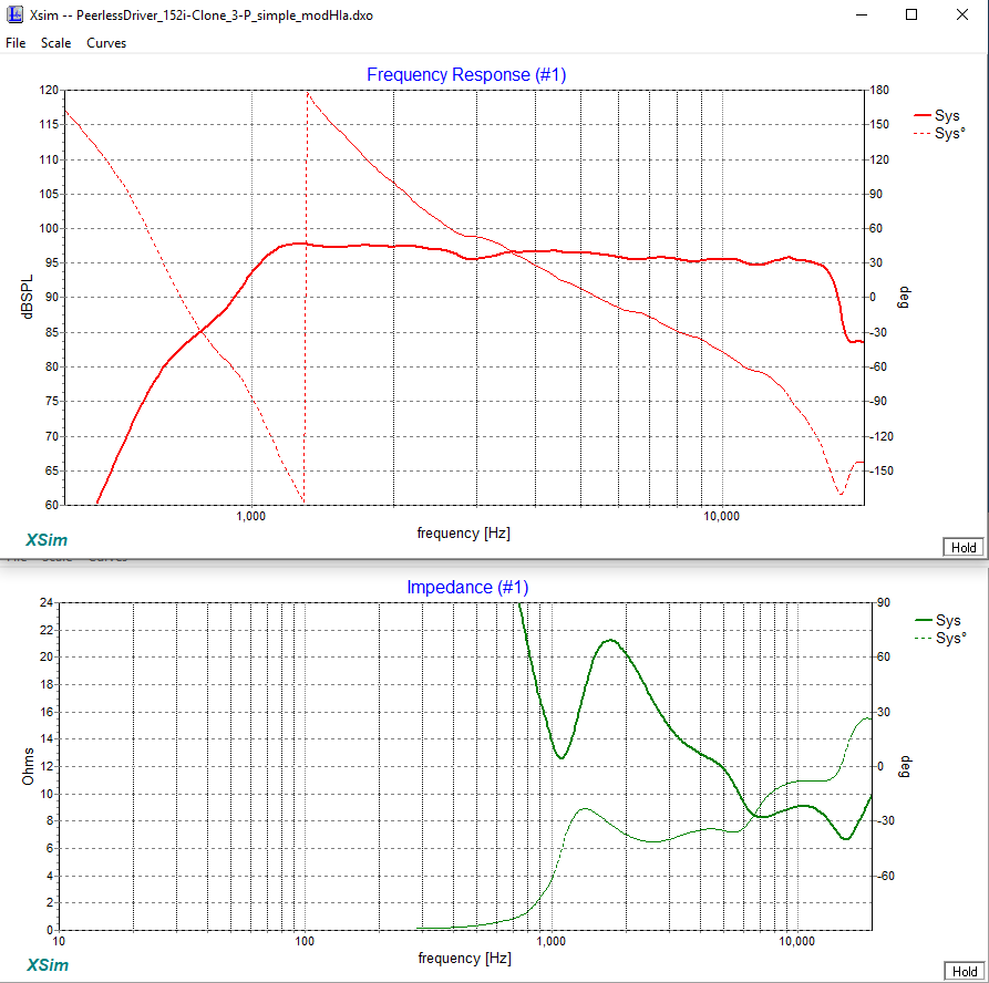

That XSim prediction was produced by this simple HP network;

Earl,
Thanks for the link and measurement curves.
I measured with the pairs of divers on the pair of horns and they measured near identical (only slight difference above 18Khz).
I don't know why I'm getting that bump centered around 2Khz (or maybe 2Khz fine and I'm getting a dip around 3K-4K?).
Don't know what's going on?

Even though you've measured both drivers on both new horns there may be something wrong with each driver ( such as a poorly fitted diaphragm ).
I would remeasure ( at least one of them ) using REW this time and then have a look at the drivers distortion profile.
The notch at around 3K ( which I find quite abnormal ) could be caused by a rubbing diaphragm.
- If that's the case you'll see a dramatic spike in 3rd Harmonic distortion ( corresponding to the notch area ).
You'll need to re-seat the diaphragm(s) to minimize the problem .
I would return those drivers if you can't fix their response anomalies ( and bring them closer in response to the graphs that I previously presented ) .

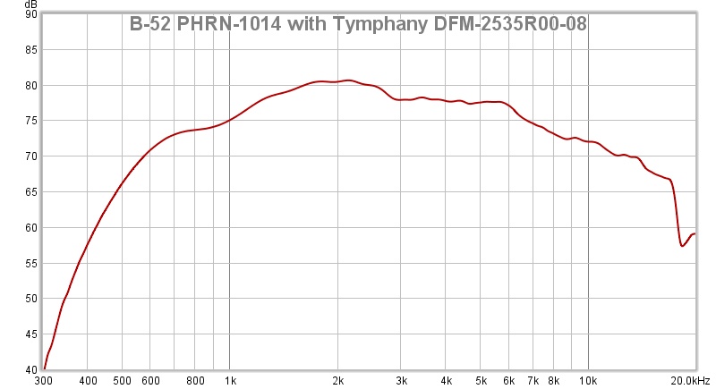

With Umik and Room EQ Wizard
Earl,
See attached pic. These measurements were taken with REW and Umik, 1-meter from WG, with 100uF cap for protection.
I've also included a comparison against the measurements using ARTA.

DK,
Thanks for the pics.
BTW for this exercise, ( using REW to spot diaphragm mounting problems) you might as well not display THD + all the harmonics that are higher than 3HD > as well as that noise floor "masking feature" ).
Can you also post your REW file ( for the above ) as well as a .zma file for one of your drivers mounted on this B52 horn.
I've already created a 1K HiPass ( + contour ) filter for your driver/horn combo ( that I'll post later today ) once I get some real files ( from you to work from ).
Here's a teaser of the possible linearity ( when using passive PEQ's to hammer out a flattish response ).
- This uses a traced FR file ( from your REW trace along with my own .zma file ) > so it's only partially accurate .
Thanks Dk,
Your impedance file ( for that driver on the 152i clone ) was similar to mine .
It hardly changed the network design ( if at all ).
The updated frd file was a bit different ( when compared to my traced version of your earlier file version ) .
Anyways, here's a HiPass design using your files ( it's about as complicated as a typical sota JBL hipass for their current crop of speakers ) .
Obviously all these parts represent just "one way to skin the cat".
I've also included the XSim file for you to play with.
The black ( my 2016 measurement for my driver ) & green traces ( your driver ) are for the sake of comparing the 2016 DFM2535 response to your newer example.
I can see that they are more similar than different.
- They both have a "weakness/notch" at 3K , and peaks at 2K & @5.5K .
- Your driver example has a bit more rolled off UHF, while the above noted similarities are more exaggerated.
Anyways, what I get from this exercise is that I'll continue to recommend these drivers ( even though they do need PEQ to get back to flattish response ).
