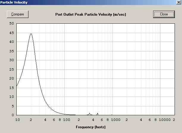

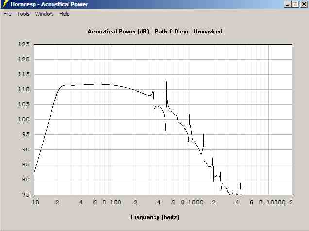

I'll attach a Hornresp simulation for a single 1262W in a 3.7ft^3 vented box @ ~Xmax. The port particle velocity is already too high. Anyway, I recommend you stay w/ sealed for two drivers in this size box.

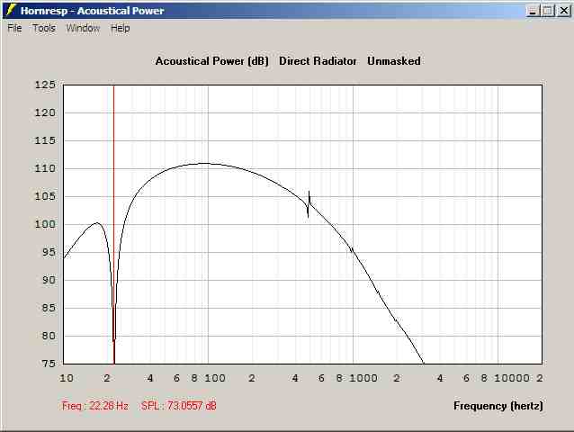

Eq is out of the question. My ports are firing to the rear, so I'm not worried by port noise. But, if I went with two four inch ports would it be better? Since cabin gain isn't a factor I'd just as soon tune them at 23 Hz or lower. The response plot above doesn't look bad. What was the tuning frequency?
Here is the tuning for the single 1262W vented enclosure. Hornresp is really easy to use for simple vented alignments, so is WinISD.

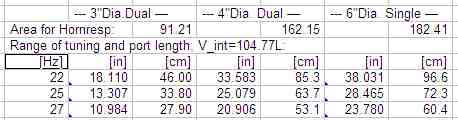

I finally decided to look @ dual 3"Dia., dual 4"Dia. and single 6"Dia. ports using the same Hornresp simulation as in Post #5. As tuning points I picked 22, 25 and 27Hz. I'll attach a list of the respective port areas and length. My pick would be the 25Hz tuning w/ the dual 4"Dia. ports (as stated before, my preference would be sealed, or a larger box.). This should work fine. The 3"Dia. 25/27Hz tunings would work w/ straight pipes out the back, for all others you need to bend the pipes (PVC plumbing Ls...). As an alternative you could elevate the box, e.g.: put feet on the bottom corners, and use straight pipes out the bottom (that works fine too).
Add some bracing to the inside of the box if you can, use ample fiberfill stuffing. Seal whatever corners you can get to w/ some silicone, and seal the backs of the midrange and the tweeter.
