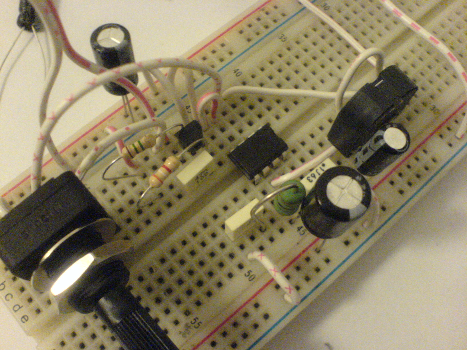

I assembled on a breadboard a small Little Gem amp from Runofgroove, and everything sounded just fine.
Then I decided to build a ruby and things didn't go so well...
Thing is I get lots of crackling noise when playing at lower volumes, I think the noise is still there when playing louder, but it's less noticeable.
Removing the gain bits (pins 1 and 8) does not help.
If I keep the ruby circuit and connect the guitar input directly to the 386 chip (ie not using the jFet, like the little gem), every thing sounds fine! 😛
Because of this I thing the problem is on the Jfet chip.
Is it possible that I got a bad jfet?! its a MPF102
Thanks 🙂
You didn't link to the schematic. If you have an input or output coupling cap, it can cause this, especially if tantalum electrolytic. Cold solder joints can cause pops and crackles. At higher voltages, rosin flux on the pcb can cause this.
I tried that, seems the oposite is happening, if I ser the guitar knob louder I think it sounds ok (it's midnight here, cant try louder as the folks are asleep 😉).
When I play the guitar at lower volumes I get no sound if I play soft, if I play a little harder I get sound but it's terrible, gets a little better the harder I play 😛
Will try again tomorrow at higher volumes, might as well try a better breadboard 🙂
Regards!

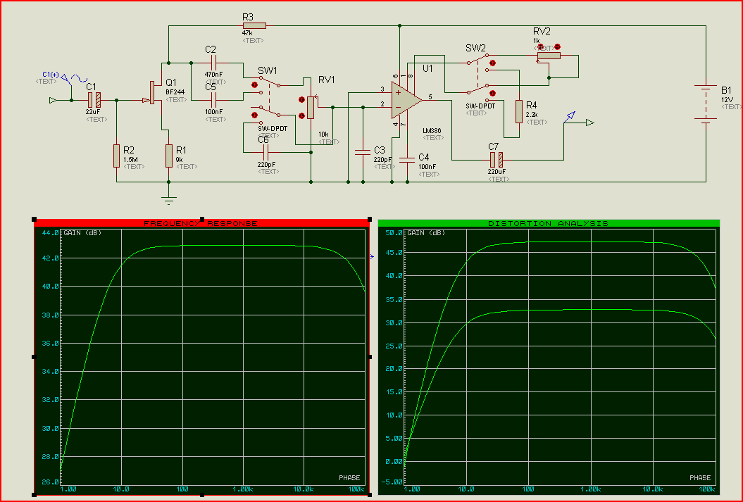

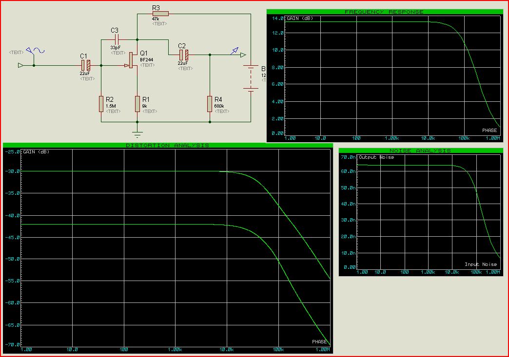

I had similar problems with this amp. I thought that JFET circuit was wrong. So I designed and simulated this little thing below. On diagram there is BF244, but should be BF245C. R4 is for simulation purposes only. Also you should add 220pF capacitor between opamp's input and ground...
AVE...
R4 simulates both 386 input and components before it (like potentiometer). I haven't done it yet (lack of time), but I made some simulations...
My complete design is below. I added some extra parts for normal/bassman mode of operation. And I removed the capacitor connecting JFET's source to drain. It's not necessary, since the capacitor between 386 input and ground works better. R2 is very important - determines the input impedance. It can range from 1.5 Mohm to even 10 Mohms. But be careful - this preamp has pretty big gain, so higher R2 might cause it to be overdriven...
The simulation was done in bassman mode with maximum distortion settings applied - that's why distortion is so high...
