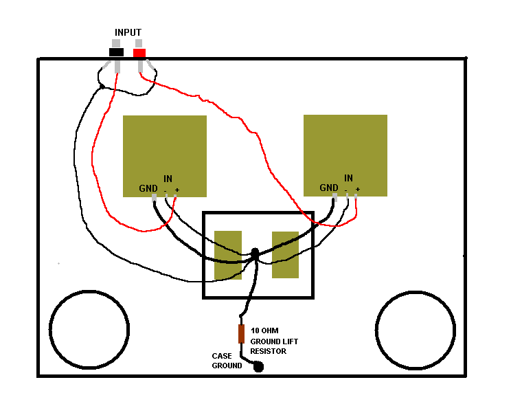

Hello atenolol50
You should do the way I draw on my image.
The input plug ground tab are connect together and that's goes to the star ground.
The pcboard input ground should NOT be connect to the input wire ground, it's should be connect to the star ground.

Ate,
Gaetan is not quite correct but he is very close. Signal input ground on the RCA input plug should be connected to signal input ground on the pcb, not to star earth.
If you have hum issues, connect a wire as Gaetan has indicated between chassis and star earth, with a 10R resistor and back to back diodes (A to K, and K to A) all in parallel spliced into the wire.
The signal input ground is already ground lifted with 10R/2 x diodes on the pcb. The additional ground lifting connection from star earth to chassis should fix your problem.

Hello Hugh
Yes, I forgot that in the Aksa the signal input ground is already ground lifted with 10R resistor on th pcb, so that's why I've suggest the ground connection and a 10r resistor connected to the star ground. Because wen I don't use a ground lifted resistor in a amp but one star ground for all including the input ground, I do as I draw in my post.
Sorry, my mistake.

ta da! fixed 😀
did as told.
rollback to original - Signal input ground on the RCA input plug connected to signal input ground on the PCB.
Connected the star ground to the IEC earth with a 10R.
No more hum. (ok, just a wee bit ... need to put my ear on the driver to hear it)
