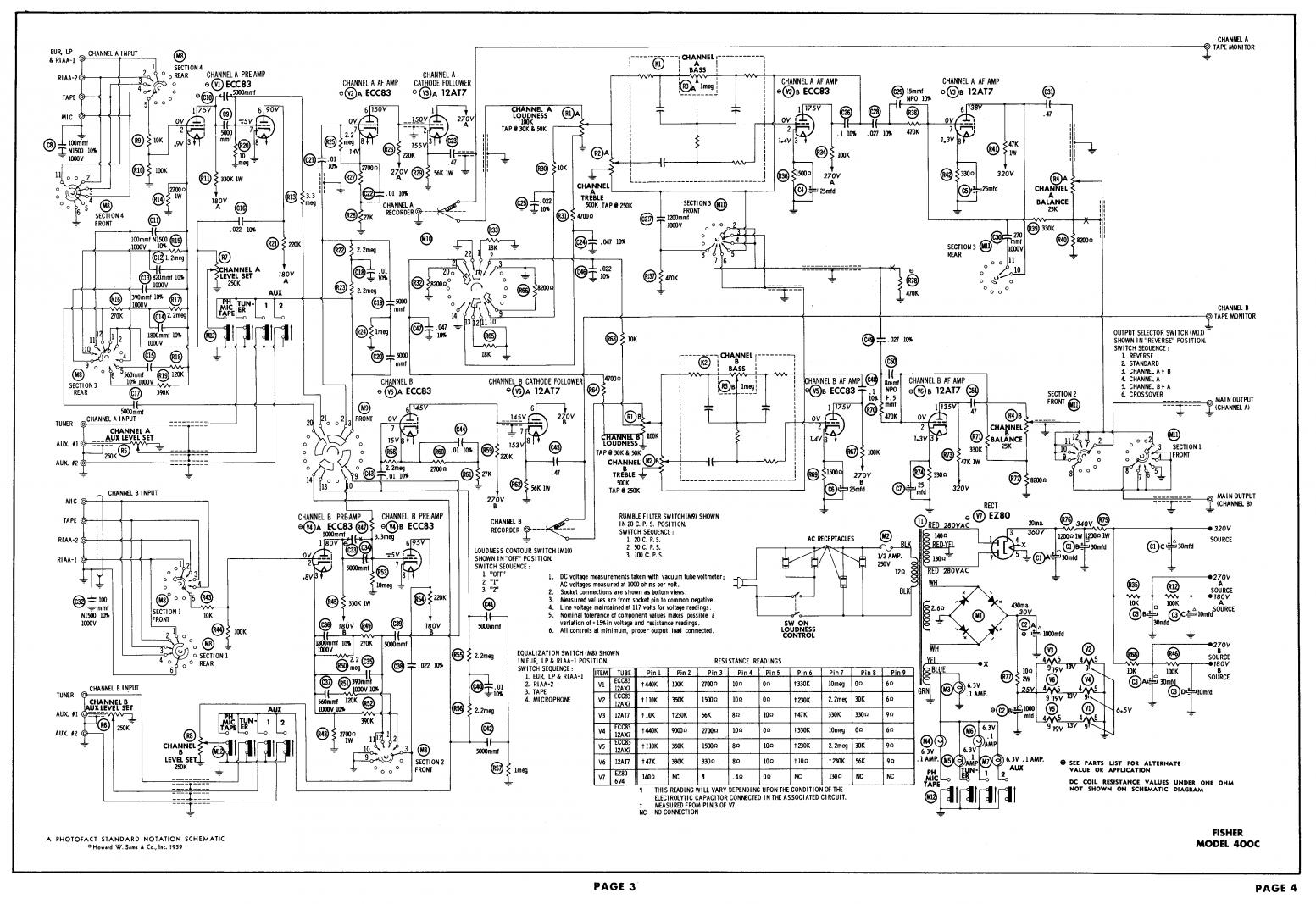

I have the hiss issue on my clone CAT SL preamp. The power supplier have been changed to 80 rectifier tube with EL84 and EF86 for stabilizer.
Everything going well with it but the very noticable "hiss" from the tweeter. I can hear the "hiss" from 5 feet distance.
The heater of the ECC82 and ECC83 have been grounded, and the 6DJ8 have been hanged at 150Vdc.
This kind of "hiss" noisy never happend when I replace the preamp with a passive preamp so I petty sure that it was came from the preamp.
Can someone help to advise where is that kind of "hiss" noisy came from and how to fix it...

Circuit diagram? Hiss can mean a fault, or just too much gain. If you were previously running with a passive preamp then too much gain is quite likely.
The additional gain always comes at a price, if things were OK gain wise with the passive it is likely the active stage has too much gain. Most of these clones are relatively suspect wrt design quality.
Be sure that series regulator is not oscillating. This oscillation can be radiated and pick up by the first stage. An oscilloscope will be of great utility to this task. In such case. add grid stopper resistors in the EL84/6BQ5)
I assumed the root cause is the too much gain on my system. I believed the problem is came from the high gain of the power amp.
See the schematic and what will be the best way to lower down the gain?
remark : there is a 100K resistor at the grid of the input stage (6SN7) connected to the ground

I would install parasitic suppressors (grid stoppers) to the first two stages. If nothing more than precaution, but I would suspect an RF oscillation problem. I will not comment on the design or changes to lower gain.

I honestly don't see an issue of "too much gain" in this circuit, because it's a low gain circuit.
However, you can install a capacitor, about 7 pf 1000V silver mica, between the plate and grid of V1A (between pins 1 and 2). Install this directly on the tube socket...
This produces a small amount of negative feedback which may help kill the hiss.
Also, selecting the correct tube for V1, there are many ECC83 (12AX7) that will hiss because they are high gain tubes, and you can select one that is low noise (7025), that has much less hiss.
Also, you can install a small capacitor, between the input, pin 2 and ground. I suggest you try a value 39 pf or smaller, and I suggest you use silver mica capacitors, which have much less noise than ordinary ceramic disk capacitors.

The reality being that the hiss may actually be coming from the preamp, and is being amplified by the power amp.

are you referring to the preamp circuit.. the schematic that I post is the power amp.
the preamp have the ECC82 input stage and the SRPP ECC83 driver for the 6DJ8 cathode out.
You suggested about the 7pF silver mica, should it be at the ECC82 input stage or the ECC83 dirver?
I using the Mullard long plate square gitter ECC83 and all resistors are RMG 1W, the feedback from the cathode of the 6DJ8 to the ECC82 (cathode) is a 20K ohm 2W RMG as well.
I did tried lot of different tubes at all stages but did not found any signficant improvement... The Brima 13D3 replaced to the ECC82 seems the best so far.
Thanks!
I suggest the 7pf at the first stage of the power amp input, between plate and grid. You can reduce this value, to provide "just enough" and not too much feedback.are you referring to the preamp circuit.. the schematic that I post is the power amp.

Too much sensitivity = too much HISS.
Whet level sine wave applied to the input will produce a "full" clean output?
This is the sensitivity of the amp.
Now, Electric Man knows what he's talking about. Thumbs up.
... when I disconnected the interconnect from the input jack of the power amp., everything alright. However, there is lot of noise when the interconnect plug in, but the other end of the cable not connect to anything... is that caused by the over gain of the amp so the cable picked the noise? (the cable is 1.5m lenght only).
Are you saying that when the input cable to the first stage is disconnected, then there is no hiss ? Does the input to the first stage use a socket that shorts the input to ground when there is no plug inserted?
You cannot test the power amp noise until the input is grounded.
Any unterminated wire to the input will cause hum and noise.
Seems like the hiss only occurs when the preamp is plugged in?
Then the noise is in the preamp and the power amp is amplifying the preamp noise.
Seems like we should be looking at the preamp, not the power amp.
Plug a CD player directly into the power amp input.
Don't use the preamp.
Don't play a CD, but just turn on the power amp and the CD player.
Do you hear HISS?
I thought you would not.
It's the preamp that's hissing.

Hsssssssss could be oscillation
Hi
The Hsssss could be the triode in stages going into high frequency oscillation as the fat cathode bypass caps make them unstable, and triodes have a tendency to become high freq sensitive or peaky when bypassed.
Another reason why I never bypass cathodes.
Solution A. Add about 56 to 330 ohms "R" from each cap to the cathode. Also use 12K to 33K grid resistors, all line stages. This adds a tiny bit of linear negative feedback, and makes the triodes stable.
Solution B. Take the caps off and run free of the puddle effect, and the non linearity of the cap. A resistor is much more linear than a big cap, and the transit response of a cap is pretty bad, varies with waveform and frequency.

Look at the channel A AF amp and Cathode follower in the schemo. The AF amp is a great classic design, and has great tone.

Change the 12at7 to a 12au7, and drop the 56K to 12K for lower impedance out.
