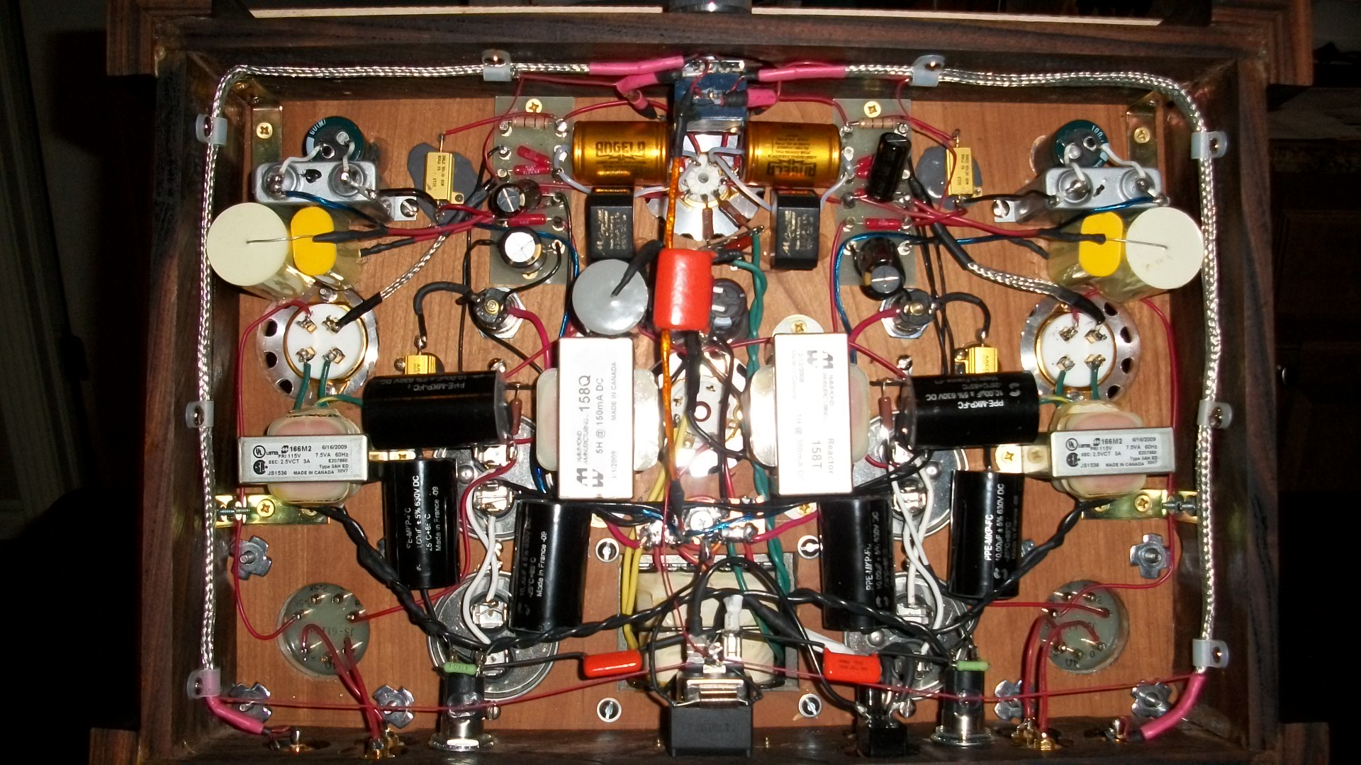

I just finished wiring up my most recent build, the Hagtech Clarion 2A3: http://www.hagtech.com/pdf/clarionarticle.pdf
There is something wrong though and I am unsure where to start.
It by nature is a fairy low sensitivity amplifier requiring 4vrms to drive to clipping at a stated 3 watts. I did however bypass the driver cathode and estimate it is now somewhere around 3vrms. The problem is it plays very quiet, like the power is being held back somehow. The reason I say it this way is b/c the strangest thing happens when I power it down with the signal still running to it....the volume increases to what I would think is a normal lever for just a few seconds then fades away. If you power it back up while the volume is coming up it immediately dampens the volume back down to almost a whisper. I have powered it on and off several times and as best I can tell it sounds truly great as soon as you power it down for that 2-3 seconds the volume rises. Anybody have any ideas what could be going on here? Did I wire a cap up backwards or something (don't think I did)?
I have never heard of something like this but I'll bet there is somebody on this post who has. Any help greatly appreciated.

Do both channels behave the same way? If you have a DMM take readings at the grids and plates of each tube. That should be an easy way to identify the problem.
What is the combined DC resistance at output tube's cathode ?
It is supposed to be 680R plus whatever the #47 bulb puts into the path.
It does behave this way on both channels.
I have not yet had the time to put a DDM on it with the tubes in it. I did do some voltage checks without the tubes but they were way off b/c there was no current running through the system. I did a sim on PSUD2 without current running through the system to see if the voltages would behave the same way and they did. The B+ rises to 410v without the tubes, exactly what PSUD2 showed with a 1mA load on the system. So I am pretty sure they are correct but, again, I haven't had a chance to put the voltmeter on it yet with the tubes in and warmed up. I am thinking one of the bias points is off and when the power falls the bias point falls, or something like that.
Another idea is the bulbtype on the cathode of the 2A3 might be the wrong one, I am not home yet but that might explain it, if the bulbis wrong than the cathode resistance would be off and the 2A3 not biased at the proper point, when the power falls off the bulb filament cools a little causing the resistance to drop and the bias point to come in line to where it should. I could just bypass the bulb altogehter and see if that works. Besides that, what else could cause the output to rise as the unit is powered down? I have never seen anything like this before. I am confident that it will sound great once I get it corrected as it sounds really good for that brief period of time when it is powering down.

That is the first thing I would suggest you do.I have not yet had the time to put a DDM on it with the tubes in it.
I'm taking a long shot here, but how bright is the lamp?
Anyway, if my calculations are correct, you should be able to (temporary) bypass the lamp. 680 ohm and a current of 56 mA should give you approx the wanted 40v bias.
To be sure, measure the cathode voltage, if its about 40v when in use, leave the lamp.
If its much lower or higher, try the bypass.
gr. Paul
gr. Paul
After some reading: the lamp should be a 2V 50mA type. Its only indicative that there is running current. Definately try to bypass it!
gr. Paul

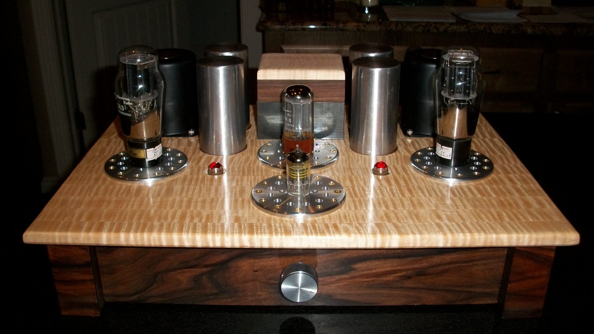

Did you check the filament voltages for the 2A3s are correct?
If its not, then the filament tranformers are broken. You can see in picture nr 2 that they are 2.5v CT/ 3A, which is perfect. I suspect that the CT goes to the power-resistor, and then to the bulb. Looks also good to me.
And indeed a beautiful amp! He shure knows how to build them.
