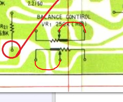

ok thanks, its just two ~125K resistors from left/right to middle per pot (as it is dual) isnt it?

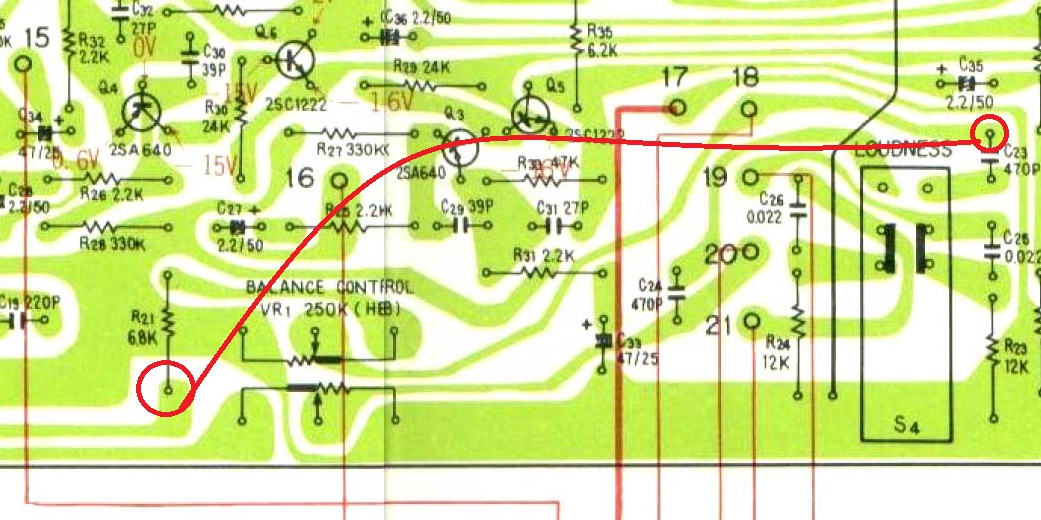

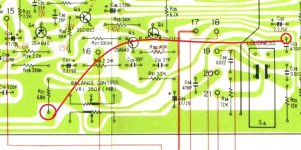

Is it 🙂 I don't know without seeing a circuit. The output is often taken from the wiper so it would involve linking the centre pin of the pot to the "input" side.

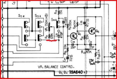

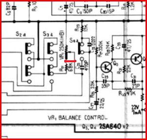

Done that wrong... keep the resistor in circuit. Can't make it out. 68 or 6.8K ? Link to the other side of it.
with this method, can I leave the pot in its original position? After bypassed like this does it still have any effect on the circuit?
i've done it following the picture above(your drawings only) and the pot still functions. Any ideas?
Hmmm... yes I can see you would have to take the pot out to stop that although leaving it in should be no detriment when the pot is centred. If you look at the pot symbol the solid bit is "non resistive", in other words a short as the wiper moves along it. The two gangs are mirror images, as one becomes "short" the other side becomes resistive as the pot is turned. In the centre both are intended to "short" so you get a direct signal. That's what the added links ensure if the wiper contact were intermittent for example.
It shouldn't be detrimental although the way it works now is slightly different in that it shorts the signal to ground as the pot is turned using the 6.8K and the pot as a potential divider rather than the pot itself (if that makes sense 🙂)
I was busy for last few days but now that I've read your last comment it makes perfect sense 🙂. Thanks for the help, I'll leave pot in coz it looks much better this way. I never really use the balance anyway so this project is finished until I find a perfect replacement pot.
