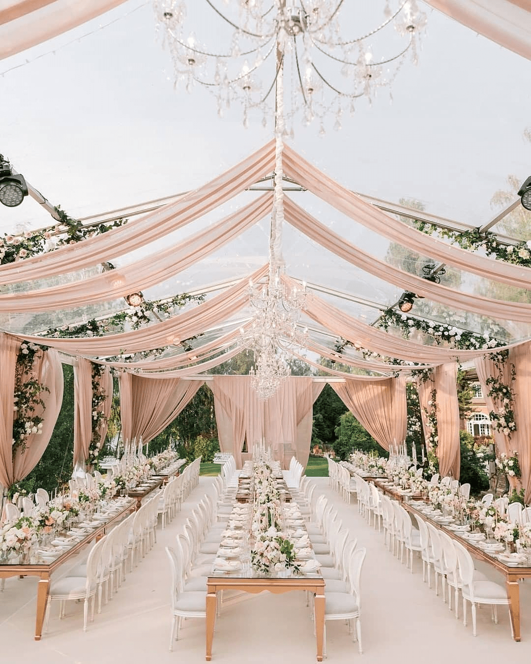

Thanks for the answer. How much would it help to put foam sound absorbers all over the ceiling and cover with wedding drapes? Something like this:

Vertical baffles hanging from the ceiling will be most effective, I think. Baffles as in: sheets of sound absorbing material (melamine foam or covered mineral wool preferably because of fire hazard). They’ll need quite some of them, so it’s an investment. I had a close look at the ceiling: amazing the owner didn’t already address this issue, I’m sceptic about your chances to convince him (or her).

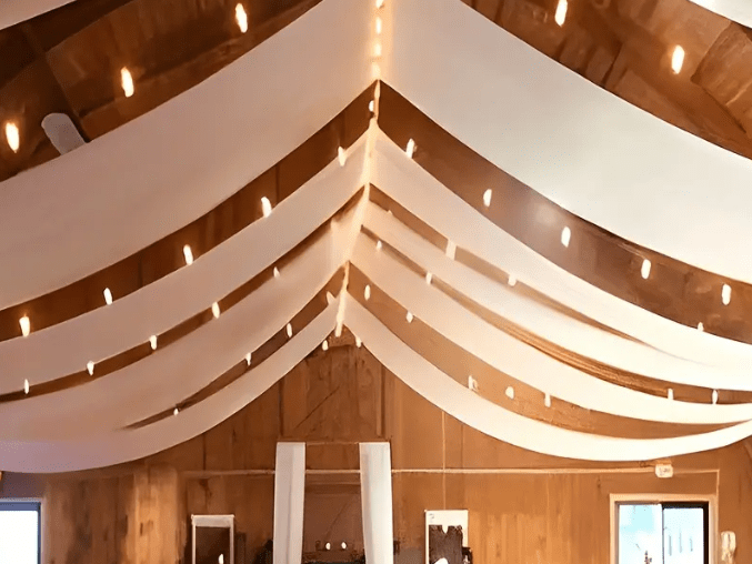

The difference is very light fabric is used for wedding drapes
so if a heavier drape is possible.
Ceiling and floor are largest surface.
So carpet might not be a option on the floor.
Upside down or not, sound doesnt care.
So at least the ceiling can be heavy with drapes.
Since floor and ceiling is your largest area.
Less spacing between drapes have the ceiling fully draped in.
and have simple drape designs in the corners.

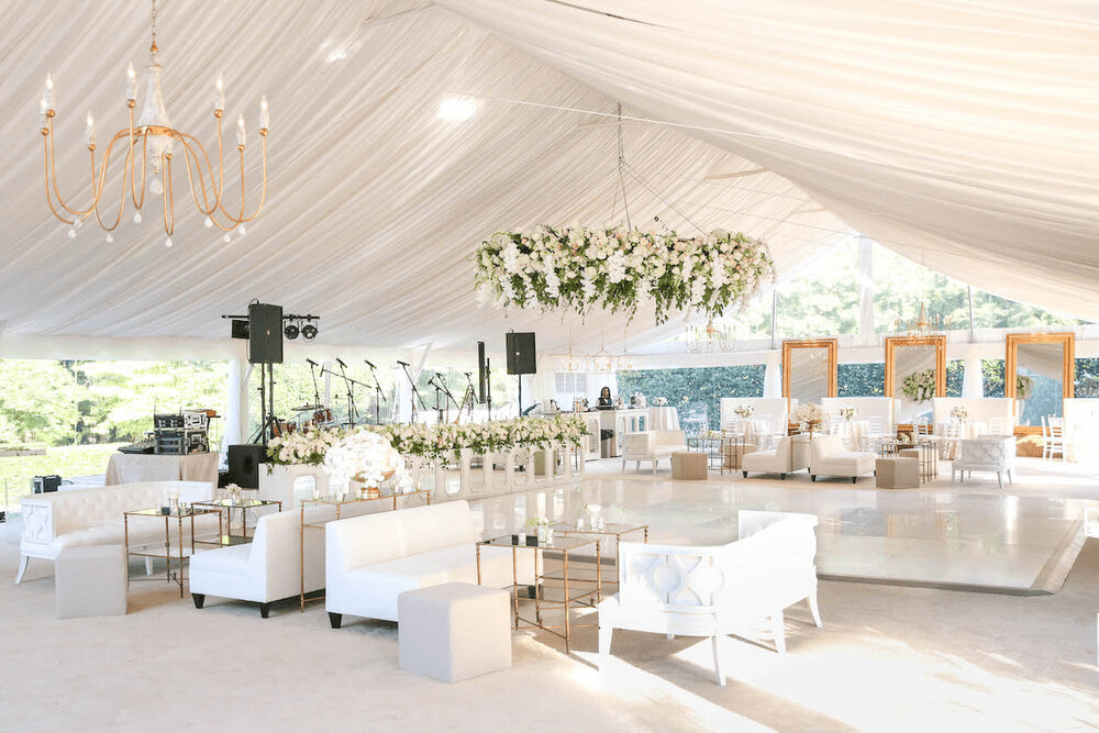

For example this room has no spacing fully draped ceiling.
Which looks ok. Consider that your first layer.
Trying to block and cover all the reflective ceiling glass.
Then add second layer for pattern and open spaces.
Such as the typical more open pattern look and vines.
Its nice to use white for the full drape, then the second accent
layer be different color drape.
For the longest distance wall the speakers are facing
do a very heavy pattern multilayer.
