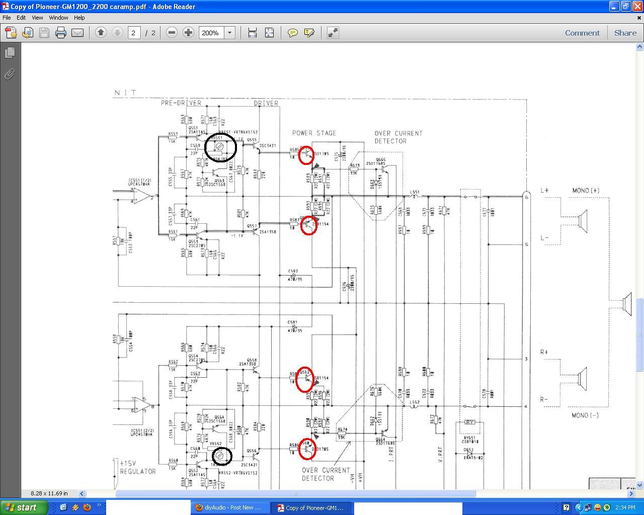

Problem : I made the rem_bridge, it receieves 12v, the LED lights up, i can hear the rellay clicking on/off (ofc when i power it up, and when I turn it off).
Problem no sound in speakers.
The following : i have checked the tranzistors as in the previous pioneer model (gm-2000a ) and they all are in good order.Nothing is "fryed".
The thing is that I have 2 switchies in the amp somebody can tell me about them?
theyre highlited with black , and the reds are the final tranzistors.
Plese help.
Thx a lot !
p.s. 1
thers a single volume know in the form of a hole in the amp case, wich leds to a screw, turning it from 400mv to 4V, rca level input. if it helps
p.s. 2
i`ll attach documentary needed

The components circled in black are the bias potentiometers. They are used to set the idle current for the output transistors.

Generally, turning the bias post clockwise will increase the idle current. Turn them slowly to prevent excessive current flow through the output transistors. Have all transistors tightly clamped to the heatsink before attempting to adjust the bias.

If you turn them fully clockwise, the output transistors will likely overheat and fail.
You adjust them and let the amp idle (no speakers connected, no input signal) and re-check it. You have to do this to make sure that the bias doesn't drift and remains very near where it was set.

If you don't have an amp meter on a 12v supply, measure the DC voltage from the emitter of one output to the emitter of the other transistor in one channel. Set the DC voltage (with the bias pot) to about 0.002v DC. I'd suggest installing a 10 amp fuse in the amp while adjusting the bias to provide additional protection in case you set the bias too high.

and where should I instal a dc fuse in the amp?change the 30 amp fuse with one of 10 amp(i doubt you would recommend this). if this is not the case then where should I install it?
The amp is supposed to have a 15 for normal operation. A 30 offers absolutely no protection. Install a 10 in the fuse holder on the amp while adjusting the bias.
You measure the voltage between the emitters of the output transistors for each channel.

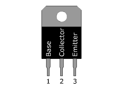

ok.n00b question.get ready for it.
looking at the tranzistor fromt he front (writing part towards me)
B E C ?
I put the red probe (multimeter probe) and the black where?
I have checked the tranzistor in diode mode. but to be honest i checked each combination for results.did not know wich was wich at the tranzistors pins.
I think I saw it up somewhere on the internet when I did it.
There is only one emitter per transistor. There are only two output transistors per channel. Place one probe on one emitter and the other probe on the other emitter.
Correct me if I`m wrong.
one probe on the emiter pin on one of the tranzistors.
the other probe on the other emiter of the second tranzistor.
