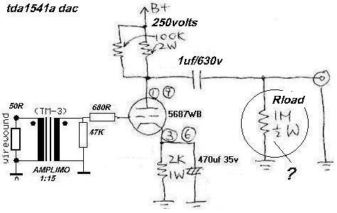

hi all,
experincing cracking sound at high volume...the tube stage has no Rload resistor on it..try to connect a 1M resistor but only getting distortion..any idea?
pls advice..
thanks in advance..
