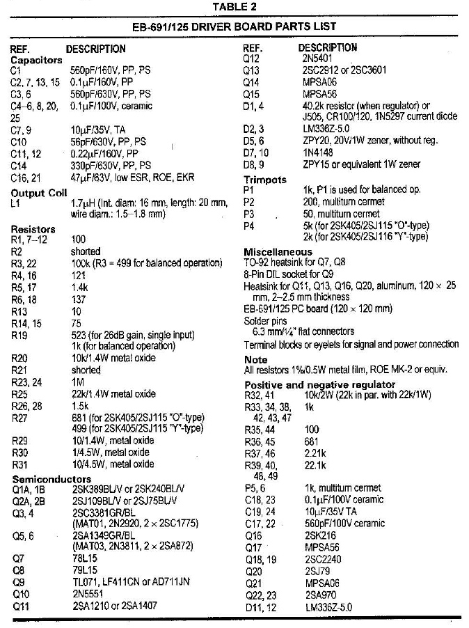

I am trying to repair an amplifier which has damaged input front-end (Q1/Q2) pair. The schematic suggests BL/V grade of 2SK389/2SJ109. What would be the pro/cons between low Idss and high Idss here? Thanks in advance.
PS. Schematics below.

Higher Idss devices could tend to overheat cascode bipolal trannies but provide higher bandwidth due to lower input capacitatance from real bias.
7 to 10 ma worked well on my Borbelys. I have some with 12 ma working well too.

Thanks for the info. I found matched pairs with Idss=7.x ma. They are quite expensive (but genuine), but I got to fix my amp. Those jfets were probably damaged by shock-off noise from preamp. I forgot to turn off my amp at first... Lesson learned.

I see. There isn't much choice. Those jfets were discontinued long ago, and the stock is very limited.

A pair of 389/109 could be easily replaced with matched quad of 170/74 jfets.
It looks like Borbely Servo.
It's supposed to be biased to 2mA per device.

Yes. Despite they are slightly different, they can replace 389/109 if properly matched.

You're right. It's Servo-50.

If I remember correct Vdrop over R5, 6, 17 and 18 is supposed to be 2v8. If one can't adjust high Idss devices to the right spot Mr Borbely suggests that R13 be replaced by a wire.
I have made my own PCB'S for the Servo with SJ74 and SK170 mounted together. I will try LSJ689 and LSK489 later.
The cascodes use KSA992/KSC1845.
As outputs I use 6 pairs SJ55 and SK175. I had to change mos drivers source R to 39 ohm.
I have a slight overshoot on square wave, but after first tests it seems to work fine.
