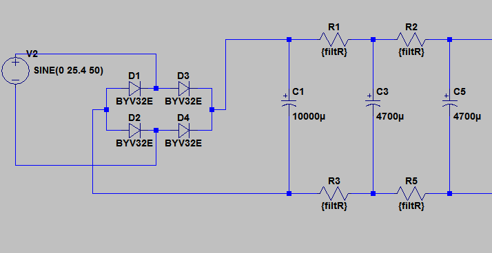

I don't see any Resistors in there. for an example of how much effect on the ripple having a CRCRC circuit makes have a look at the below pics. edit: sorry just realised I was missing the point, and the RC was referring to the last resistor/cap in the circuit, oh well, I'll leave my irrelevant info below anyway 🙂
the attached image (at the end) is the circuit these measurements were made against (which is the filter stage before my reg circuit). I think from memory the load was around 160mA for these shots. The R's in the circuit are 3.3ohms and the input voltage was around 18V ac RMS.
The picture below is the ripple across the 10,000uF cap, scope set on 20mV/ div
Next is the ripple across the second cap scope set at 5mV / division
last is the ripple accross the third cap, scope set at 2mV / division.
Note that there is a penalty, The higher the current draw the greater the voltage drop will be across the resistors, smaller resistors mean a smaller voltage drop and for higher currents either higher voltage (inefficient), or smaller resistors (not as effective ripple reduction) will be required. You have to choose your tradeoff. However I think the above shows the difference that adding a few resistors can make 🙂 Also you need to take into account the dissipation in the resistors and size them appropriately (ie high enough wattage).
Tony.

Yes sorry I realised that after I posted (hence the edit). As far as the second diagram is concerned I don't see a lot of point of all the extra parallel caps, IMO you will get far better value (assuming you have the voltage to spare) but also putting in small series resistance (if you are going to add extra caps), even something as low as 1/2 ohm will make a difference.
Is the output of this circuit feeding a voltage regulator? I've just looked at the values of the caps in your first diagram, I'd originally assumed that they were 22000 uF but now I'm wondering if that is 22uF Only reason is that it says they are nichicon FG's and they don't come in sizes that big (biggest is 10,000uF at 6.3V only).
With respect to the 2nd diagram, By paralleling multiple smaller caps the ESR will be reduced, but at the same the inductance will be increased. I'm not sure why each big cap would be paralleled by a small film cap, I can understand one being placed at the output to the supply, but this is something that is often debated as to whether it does more harm or good. Having one accross each big cap in the supply seems a bit strange.
The final small cap with resistor is something that caused a huge debate here on diyaudio a few years back, it was coined the snubberised supply, (which I think is a mis use of the term snubber). It was claimed to make all sorts of amazing transformations to the sound of the amplifier used on. I've not experimented with it, and don't have enough electronics knowledge to comment on it from a theoretical point of view. Certainly it wont require any significant expense to try it 🙂 and you could do so on your existing v1 without adding all the extra caps of V2.
My circuit that I attached is overkill compared to what people normally feed a regualtor with, but my reasoning was that the lower the ripple on the input to the regulator, the easier its job is, and the lower the ripple should be on the output... this certainly seems to be the case in the sim. I need take out the 2nd and third caps and measure on the real circuit to see if there is a measurable difference in real life.
Tony.

I just checked the difference on the output with only 10,000uF filter and then again with only 4700uF filter cap compared to the CRCRC before the reg. Whilst the filtering makes a big difference to the pre-reg ripple, it is either not making a difference post reg, or the resolution of my scope (and the noise pickup problems I have) is not good enough for me to easily see a difference (any difference seems to be in possibly lower spikes visible when the trace intensity is increased significantly (rectifier pulses?) with the additional filtering, but I'm not sure about that.
So the circuit I posted (when followed by a regulator) is definitely overkill, but that was the original idea (go with gross overkill and see if it actually made any difference) and it was intended to be a learning experience for me 🙂
Tony.

Nounours,
Don't go higher than 10000uF on the caps directly connected to the rectifier bridge.
More will put too much stress on the transformer and rectifiers. (Horowitz page 330)
If you want lower ripple add extra RC section(s) as in Wintermute's schematic.
I agree on your findings about musicality. Did not dare to post it

The 'snubber' network may reduce resonance problems caused by the small capacitors bypassing the big ones. The proper place for a bypass is not at the PSU cap, but on the amp circuit board. The resistance of the cabling then helps damp any electrical resonance between the capacitance of the bypass and the inductance of the big electrolytic. Uing high ESR caps will also damp the resonance.
BTW putting identical caps in parallel reduces their inductance, not increases it. It also reduces ESR, which may make resonance worse.

Welcome back!
"Horowitz" may be a reference to the standard textbook by Horowitz and Hill.
For a CR section the DC voltage drop is given by Ohm's law V=IR.
The AC filtering is given by b=1/(2 pi f R C).

Nounours, do you know the actual current draw of your preamp, if you do (or can measure it) then just plug in to ohms law as given by DF96 to get the voltage drop across your chosen resistor value.
The resistor value I was using was 3.3 ohms. This is fine for my circuit which I don't expect to draw more than about 180mA.

Hi N, I wish you good recovery from the surgery.
The trick is I am using only CRC filtering in my power supply; no voltage regulators or shunt regulators. Many forum members will think I am crazy but my ears don't lie.....
As already explained you can calculate the voltage drop across the resistor by Ohm' s law, knowing the current consumption of your circuit.
