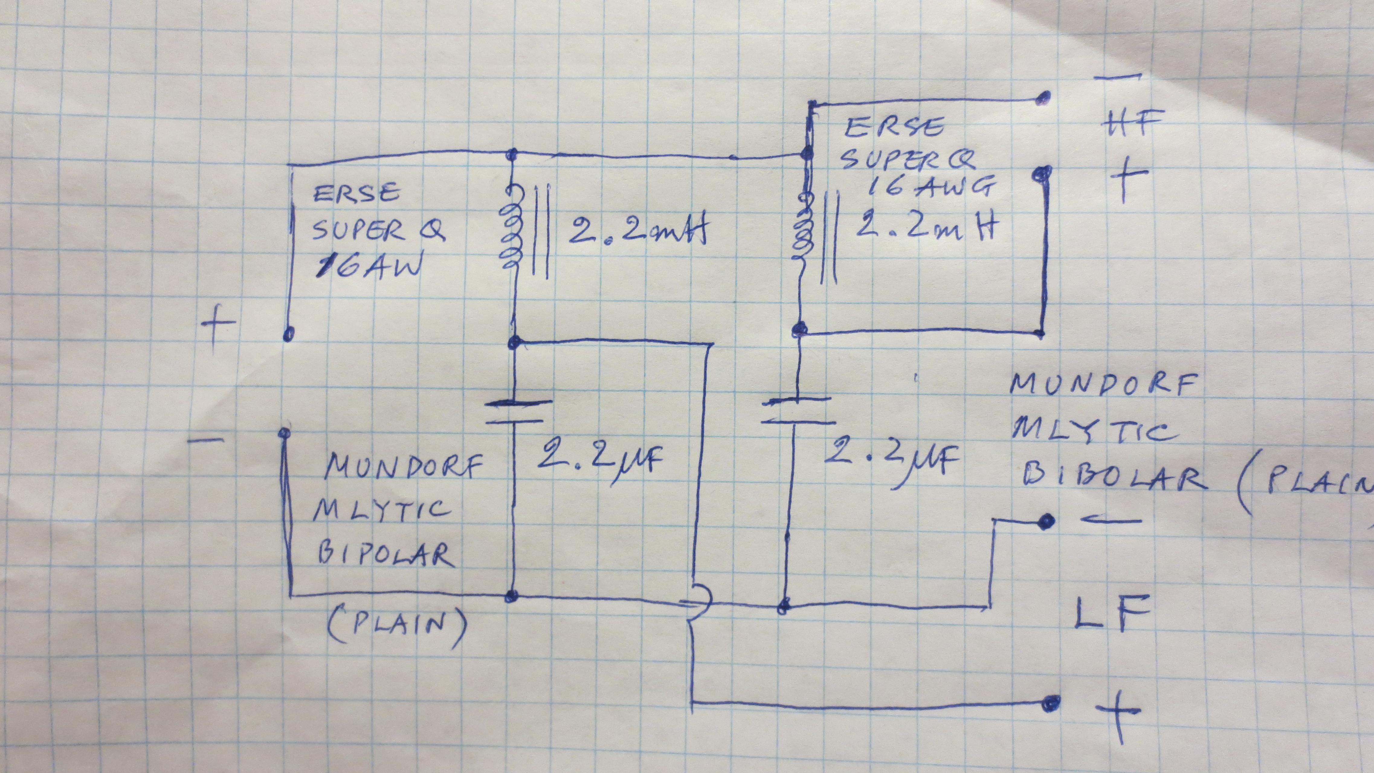

Thanks for your diagram.
Do you also have the Jensen H222 and applied these crossover?
With my limited knowledge, I understand that this is a LR connected in series. I just wondering if you have tried the more common parallel connection. If so then do you found much difference in sound? Also is that the overall impedance would be different between connecting series and parallel?

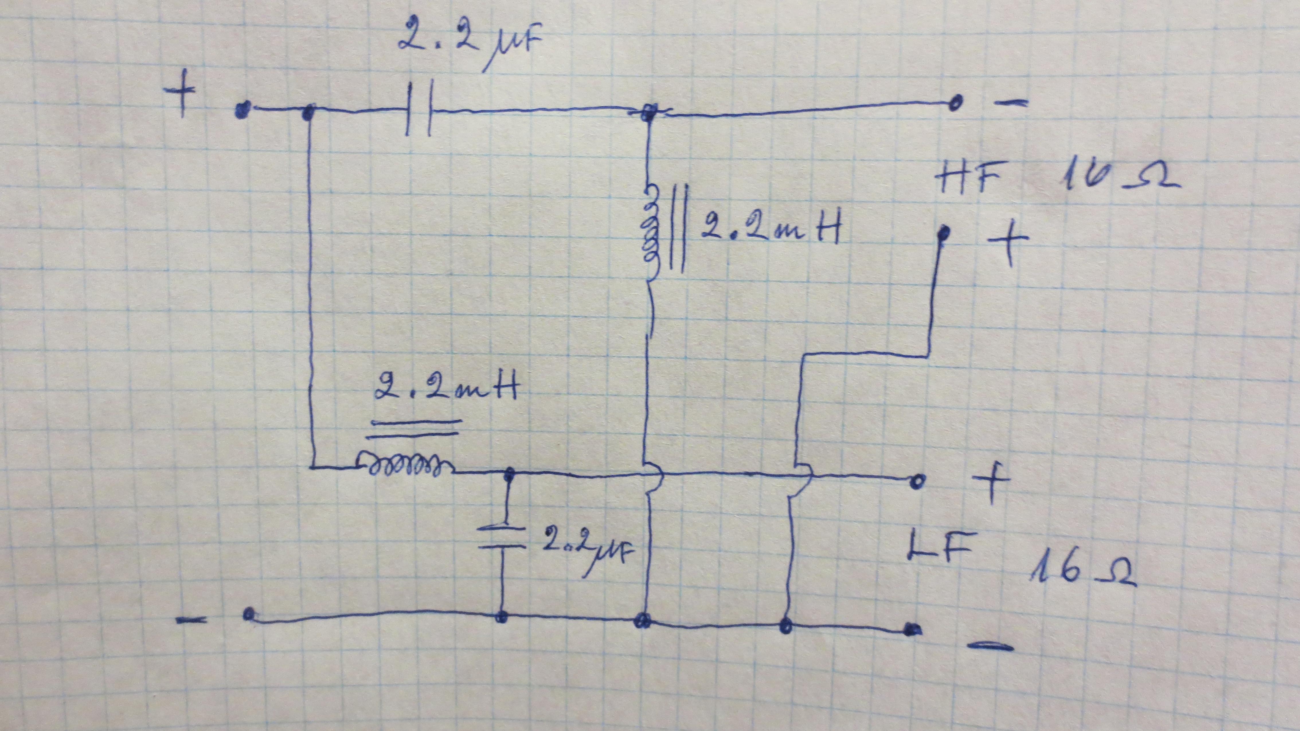

I don't have the speakers. The schematic of the crossover is the second order Linkwitz-Riley at about 2250Hz. The frequency response is flatter than the frequency response of the crossover you have. I draw the schematic of the crossover again. The first schematic and the second schematic are the same crossovers (just different ways to draw it). That means they will work exactly the same. The inductors are 2.2 mH,16AWG laminated core ERSE Super Q inductors. The capacitors are 2.2uF Mundorf MLytic Bipolar capacitors. You can use 2.2 uF Clarity Cap ESA 250V (my favorite capacitor) if you like it. I am always have good result with my design. Good luck!

I didn't try to repair it. I bypassed the original and built a new crossover for them. I work out great. I probably spend too much money on the parts as I moved on to other speakers. I still keep them as they sound great but just not using them most of the time.
