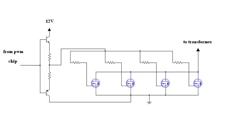

It is not possible to tell if the SMPS is going to work or not by just checking the schematic, the PCB layout is quite critical too. So, I guess the only way to tell if this is going to work is to build the circuit and test it!
If you want to check the basic circuit (i.e. switching characteristics, loop stability) , I can recommend you to use Spice for circuit analysis( like LTspice, make a search on google).

One more question. Knowing that the MOSFETs are IRF 1405, how much power can I achieve from this power supply ??
the limits wont be in the mosfets. more likely the toroidal transformer and/or (if used) output inductors

u are using 10 pairs of irf1405 ??? those are rated at 169A each 🙂 🙂 🙂
3 pairs will be enough for 500W smps
u cant just add million paralelled transistors to get more power , u gotta use 2 or more transformers if u really want to make a 2000KW + amp , is this what u are trying to do ???😀
plus :
i didnt check all the schematic but u allready got a serious problem !!
this is not the right way to connect the base transistors to the power mosfets !!!
R10 to R18 should be connected to the emmiters of Q9 and Q10 and not to each other !!
and Q9, Q10 , Q31 , Q32 should have emmiter resistors .
i guess there are more things wrong with this schematic , u better look at other circuits to see how its done
cheers

thanks sss for the reply. can you draw a little schematic on how to connect those resistors pls so I can understand better? I would appreciate your help.

DFI said:can you draw a little schematic on how to connect those resistors pls so I can understand better?
here it is 😀

sss, thanks. I understand now what you mean.

if u got 4 toroids and lets say 12 pairs of outputs then use 3 pairs for each transformer , dont connect all the transistors in paralell the way your schematic shows
sss said:if u got 4 toroids and lets say 12 pairs of outputs then use 3 pairs for each transformer , dont connect all the transistors in paralell the way your schematic shows
That's exactly what I wanted to do.
