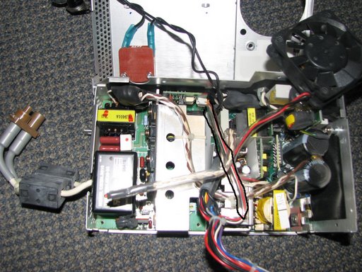

Thanks Shorin, thanks for the detailed reply. It really gives me an idea of what I'm going to do.
I have took the PSU apart and found the ballast there, below is the link to my on-line photo album where u can find all the photos about the projector.
I've go through an post about use opto-couplings to fool the projector, but the funny thing for me is I even can't find the optos. I do find 2 pairs of 4 legged chips on the PSU board which can be found on my web album.
Still going through the PSU, but need leaving for the university soon
Ok to sum up before leave.
The PSU have 2 PCBs, one is the power supply for the main board(the right half), the other half is for the lamp I guess. There are 3 wires form the left half goes to the main board which u can see from the attached photo. So according what you said the 3 wires should be the ones doing the trick.
Thanks for advance any help will be appreciated

I think I'm nearly there after reading this post http://www.diyaudio.com/forums/showthread.php?s=&threadid=29735&perpage=25&pagenumber=1
I think all what I need to do is to shortcut the red and black wires from the ballast board to the main board, but before I'm doing that I'm worried about the lethal voltage from the ballast. Anyone reckon it will still doing the trick without the power supply to the ballast board?

You're almost there.
If you read alot of that post, you would have learned that all that stuff about optocouplers. Optocouplers are apparently a way to get a "signal" without being connected to the circuit. There's a light inside those chips and half the leads connect to one circuit and half to another, and there is no connection in between. This pretty much means those 3 wires are probably not part of the ballast PSU circuit, but electrically separated because of the optocouplers.
Don't worry about the voltage here, those 3 wires should be safe. Large amounts of current (amps) is what is deadly and high current needs thick wire.
Either way, get yourself a multimeter so you know what you're doing.
You can do your tests with those 3 wires disconnected from the ballast PSU, or just disconnect the ballast board from the main PSU (look for the big wires, I think it's the 2 twisted ones that go from one side of the board to the other).
Ideally once you get this working, it would be good to leave the ballast disconnected permanently. This would prevent wear on that circuit, and decrease heat I guess. I heard that it could be bad for a power supply (the main one in this case) to not have a load on it... You'd have to put some sort of resistor (or a crap load of resistors) on the old ballast line to remedy this.

warning
I wouldn't do this. Running current/voltage to a place where it shouldn't go sounds like a pretty bad idea to me. I might try it if I didn't have anything else that worked, but I would rather hook up a small amount of voltage to it (a.k.a an itty battery grounded to the case) to try to signal it. Another way would be to somehow vary the current or volts across the jump.
It wouldn't be a big deal if the other wire was DEFINITELY ground.
I would try the grounding method first. It would probably have the same effect.

Thanks for all the replies man.
I'll try to ground the +5 wire tonight after I back from the University. Wish it works.
Did that tonight but still can't tell if it works or not. I have put a led camping head light into the lamp housing, before the pj get started I can see a bright square area on my wall,after I turn on the pj about 5 seconds the bright area turning dim and I can't see any words and whatsoever on it. Don't know if I just screw the whole thing up, I think I suppose to see a pure green picture.
It getting dim without you turning that light off means the LCD screen came on. Your lamp may not be bright enough to illuminate the thing.
What I did was i pointed the open bulb chamber at a house light and looked through the lens. That worked well enough, even with my 3-LCD version.
Hook up a video source or a VGA signal to confirm a signal.
I really already knew it was working by the indicators and fans coming on instead of the bulb light blinking.
OH... did you put a resistive LOAD on that ground? It didn't work without that for my projector.
Man I did it, it works right now. I was watching the daily show on my wall last night that is so amazing.
What I did is simply ground the +5 red wire without any resistance, it works fine right now what I need to do next is looking for the lighting source. My options are the CREE led maybe 6 of them, or just buy a 20w led which gonna cost me AUD$50. I think I might go for the 20w led one need to mail order it from China.
Thanks again for all your replies man!! I can watch the Olympic on my ceiling now😀
