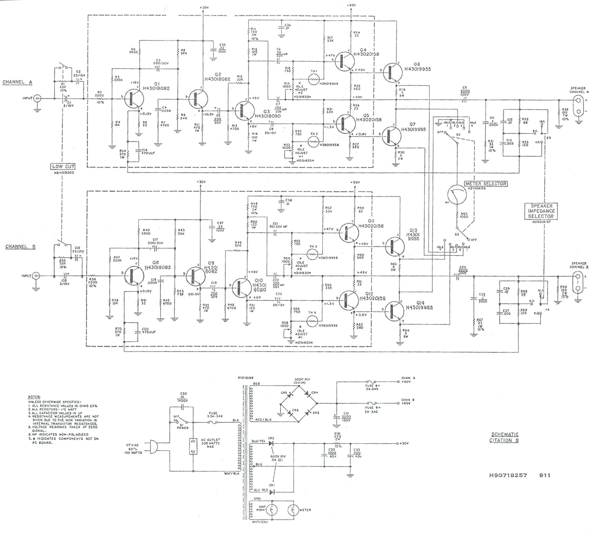

I am trying to use a Citation B power amp (circa 1964) in place of my Marantz 9 tube amps as my "summer" amp here in the desert.
I noticed the sound to be good, but the sensitivity is less. The Harman Kardon is rated at 1.6V input for rated power. Curiously, I can't find the input sensitivity specs for the original Marantz 9's. It is not on the brochures I've seen from the company. The reissue from 1996 does list the input sensitivity as 1.3V into 100K ohms.
Looking at the schematic (attached), I see R2 (left channel) and R36 (right channel) in the input part of the circuit which is 2200 ohms. Would this be a good place to start? What value resistor should I use? I may install sockets on the circuit board to experiment with different value resistors.

Thank you Craig. I set it to 16 ohms and did notice an increase in sensitivity. But still less than the 9's. For what it is worth I installed Khozmo shunt type attenuators on my Marantz preamps so I don't know if this may play a role. The are just right for the 9's as they are. But I noticed when I use other power amps I have to increase the volume on the preamp significantly more. The 9's do have a cathode follower gain circuit at the input that's absent on my other amps...
What you actually want is to make the gain of the amplifiers the same, not the input sensitivity.
About the only simple and safe way to do this, is to add an attenuator at the input of the "louder" amplifier.
Sensitivity (in Volts) means how much input signal is required for full rated amplifier output before clipping.
The gain (in dB) means how much the amplifier increases the input signal level. The gain is not the same as the sensitivity.

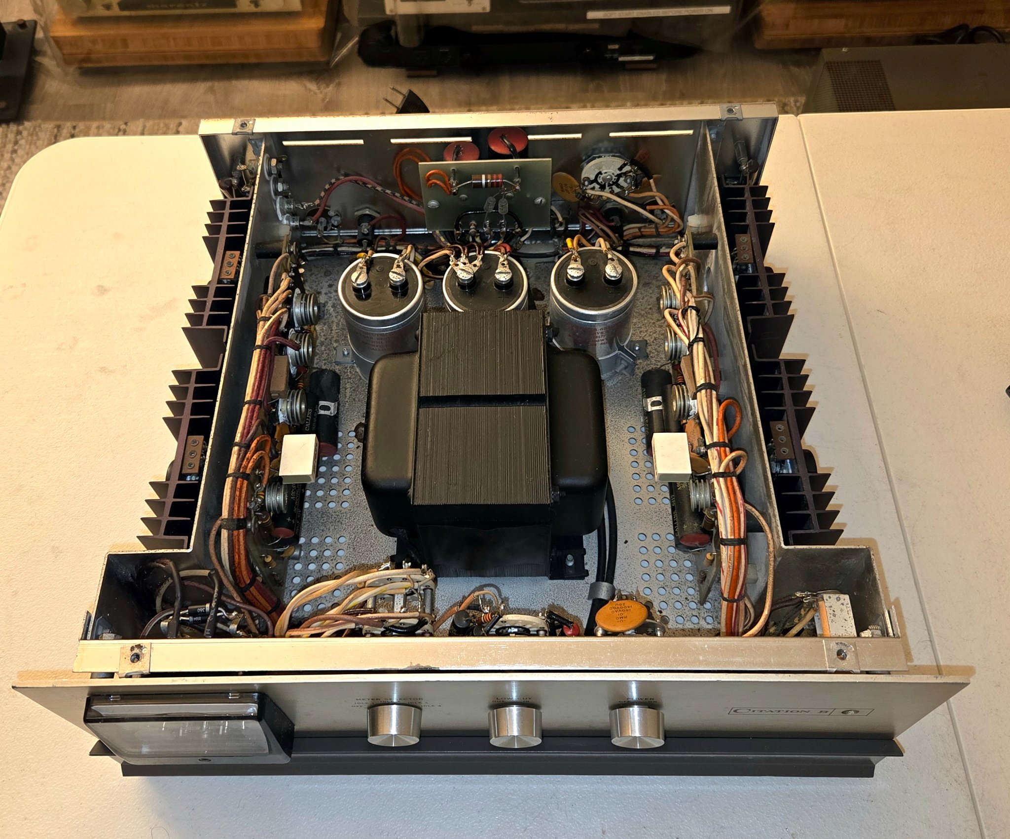

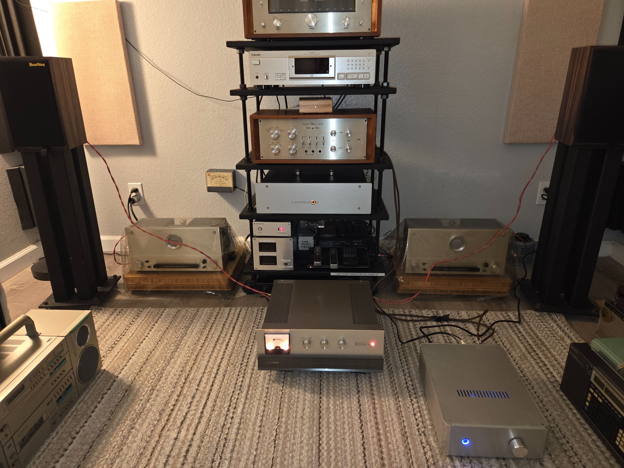

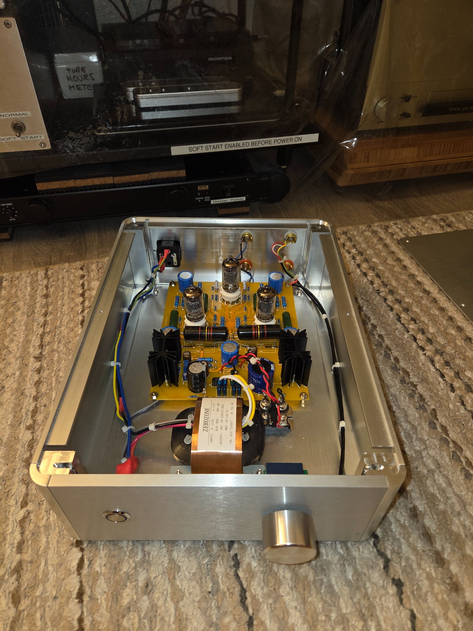

Plenty of gain with the Chinese Marantz clone preamp and no perceivable bass rolloff. So impedance mismatch is not an issue. I'll do some measurements of output voltage at different volume positions using a 1 kHz signal and compare them to my Marantz preamps later...

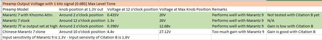

Ok. So I listened to the Citation B/Chinese M7 clone combination for a few hours. Plenty of punch in the sound. Great imaging and bass response. Given the M7's generous output I could hear some loss of clarity when pushing it, which is likely the onset of clipping.
Attached is a table I compiled of the relative voltage output of different preamps I've used. Like I said before there is no official input sensitivity of the Marantz 9 original version, only the reissue. My pair, made in 1962, seem to have a lot of gain. So much, that many preamps give very little usable area in their volume controls. Examples are the Audio Research SP-8 (had to install gain reduction resistors), the Dynaco PAS-3 and the Conrad Johnson PV2. My Chinese M7 clone is pretty much unusable as well, although it performs superbly with the Citation B.
Also note the Marantz 7 with the Khozmo shunt attenuator has less output that stock.. This applies to the 7T too, as I have a Khozmo attenuator installed on it as well.. Perhaps the Khozmo works good with the high gain of the Marantz 9 but no so much with other power amps...
