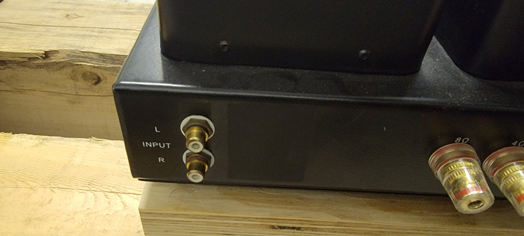

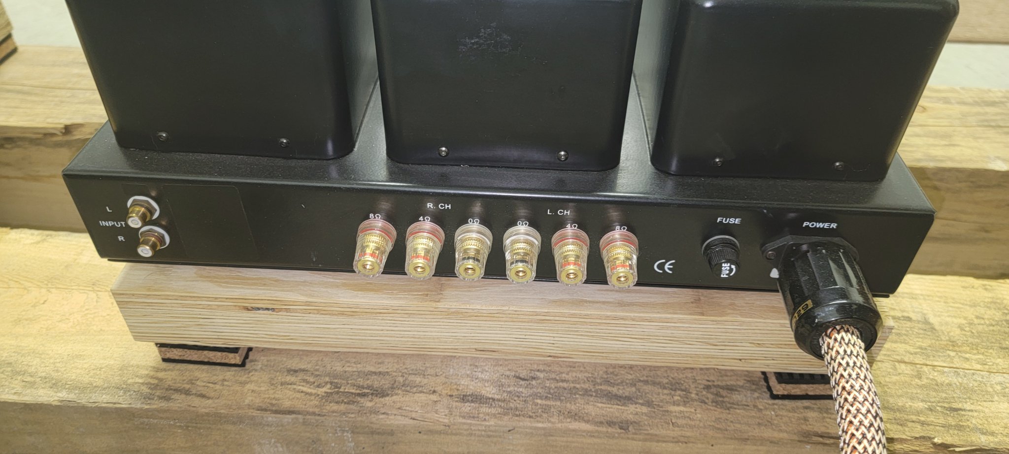

Mine is not an integrated amp. Had a flat silver faceplate that I took off because it was bent. You can see two of the inputs on mine are covered with black tape. I am wondering if some other company made amps only off of the integrated platform? Could i turn mine into an integrated one? The guy my buddy bought it from said he got it from a very small company that made custom amps. trying to find any information i can.

To me an integrated amp was always one that had a phone stage included. However in today's perverted market simply adding one or more inputs plus a selector switch to choose between them magically upgrades it to integrated. Anyway, after taking a good look at yours and the Bewitch and TrueHarmonix, yours looks like a modified version of one or the other. Meaning someone removed the controls and extra input jacks and installed a different front panel. Not very hard to do. Could you make it an integrated amp like the others? I suspect yes. You would have to add the missing jacks and controls (selector & volume) and the needed wiring. It appears it was left without an on/off switch.
BTW, I recognize the isolation pads under your amplifier platform and believe me the blue ones are way superior.

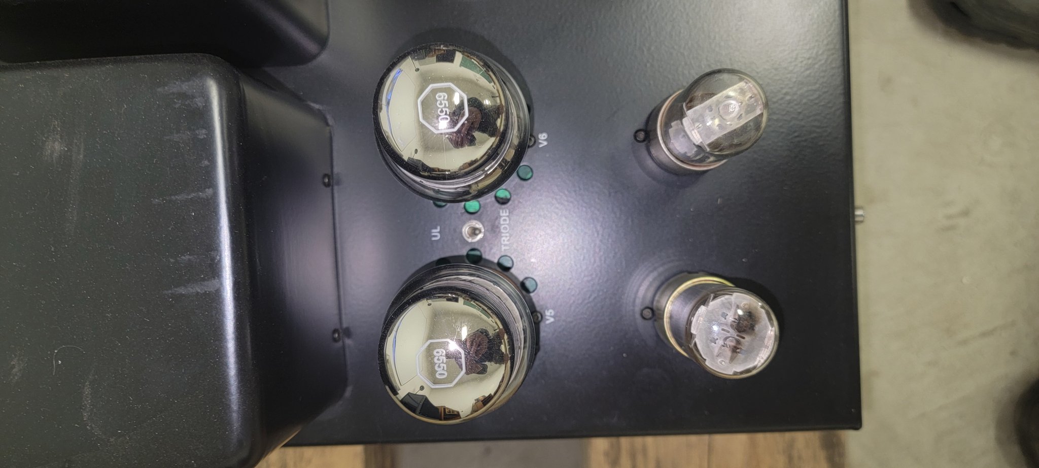

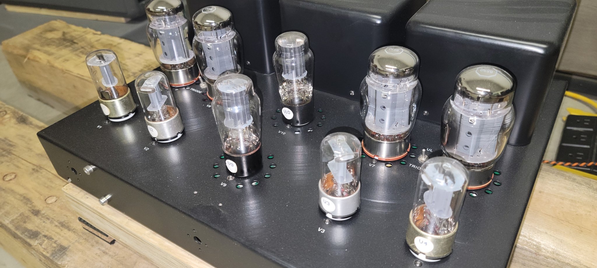

Looks like the Lampizator Bewitch modified to remove the volume and selector switches to be only a power amp. If someone claims that was a custom amp, they didn't do much work, except to remove those components and make some minor changes to the circuit. You could put the RCA jacks, selector switch and volume control back in. The problem is that they changed the input tube from a 6SL7 to a 6SN7 so it probably doesn't have enough gain to be an integrated any more and probably needs a preamp with a healthy output.

The problem getting an amp "from a very small company that made custom amps" is that you're not likely to find anyone who knows much more about it than you do, especially if it comes from China. If the amp is similar to the ones in links you posted, it would be 2 x 6550 in cathode bias. As someone who works on Leslie amps that use 6550s in cathode bias, 40 Watts is about what you can get, maybe 45. I don't see a bias adjustment on yours, but I suppose it could have non-adjustable fixed bias.
You may just have to get under the hood and sketch out the circuit. I've had to do that before on obscure gear. At least it's just a tube power amp, which means it can't be that complicated. An afternoon's work. Interesting hybrid tube/solid state rectifier bridge on one of those schematics. You don't see those that often. At least I don't.
