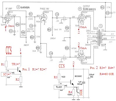

Need Help for Improving HEATHKIT AA 151
I want to change the cathode resistor to IC or Tr as CCS. I need more suggestion. Can I do the below circuit.
