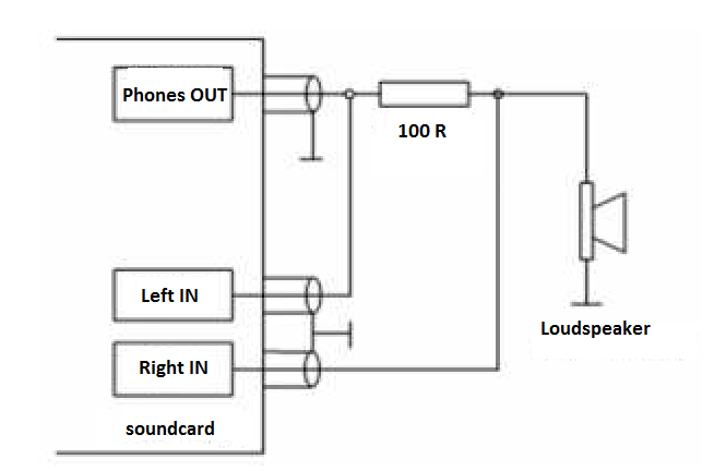

The 1k resistor converts the voltage source (the amplifier or signal generator) into a current source.
Then the current (in mA) into the speaker is equal to the voltage (in volts) across the 1k resistor.
The volume level is not critical for measuring the impedance if the readings are accurate.

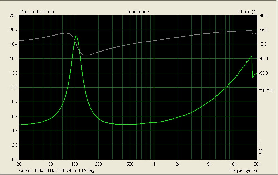

ARTA software package from artalabs is free and the LIMP module will measure impedance. The jig is very simple and even ancient not particularly good sound cards will do fine.
