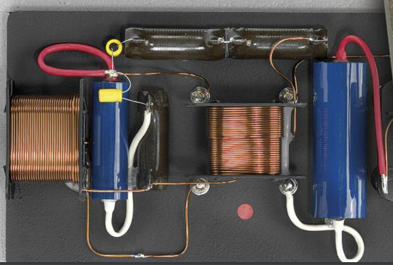

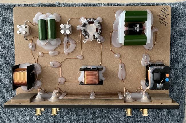

So I would like to replicate the crossover shown below, but having a hard time understanding it.
Partly because I'm a newbie at this and partly because of all the glue!
I think left inputs are negative. Looks to me like a second order filter, and I know there is supposed to be a notch filter for the HF.
And possibly an RC filter for the LF? Speaker has biwiring, so two sets of inputs. Lower half is LF circuit, and upper half is HF circuit.
If someone is able to make a schematic from this, that would be fantastic 🙂 Not looking for component values.
EDIT; here's another pic I found of the same crossover that shows the component in glue better.
Conserning the component with a questionmark (hidden in glue) in the first pic, it looks like this (and the one between the two bottom inductors) is an Ohmite wirewound resistor;

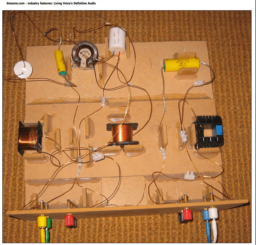

I found another pic where I think the mysterious component (?) from the crossover above is shown.
The brown components shown below. I wonder if they are capacitors or some exotic resistors?
have a roughed in XO for the second, there are 2 wires heading off to the right (actually the top?). Do these have terminals for bi-wiring?
The first xo is a mess. I know it is painful to do but can you pull off a bunch of the hot glue?

I don't have access to this crossover, it's just a photo published in an online review. So there will be some guesswork involved, I know. Especially the aforementioned brown components completely hidden by the glue..
And yes, they do have terminals for bi-wiring. The top two are for the HF section and bottom two for the LF section.
If you expand your Google searching to include a Living Voice OBX crossover you'll see that all variants seem to have a similar topology for their networks.
which is ;
2-pole x 2-pole with a series LCR strapped across the woofers outputs ( Yellow//Green terminals are for the mid//bass woofers ).

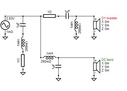

I think the R25A network is very similar, in that it incorporates a series notch filter for the HF and is probably 2nd order for both ways. I say probably because I'm not sure what's going on in the HF section;
I'm pretty sure the notch filter is composed of the components shown. The parallell inductor and series resistor are also fine I think.
It gets literally blurry when it comes to the capacitors. I can't see if the green cap is parallelled to the big yellow cap, but I assume it is.
However the connections in the resistor area is a mess, but it looks to me like the caps are in parallell instead of series? That would be unusual, and the reason why I'm not sure its a regular 2nd order filter.

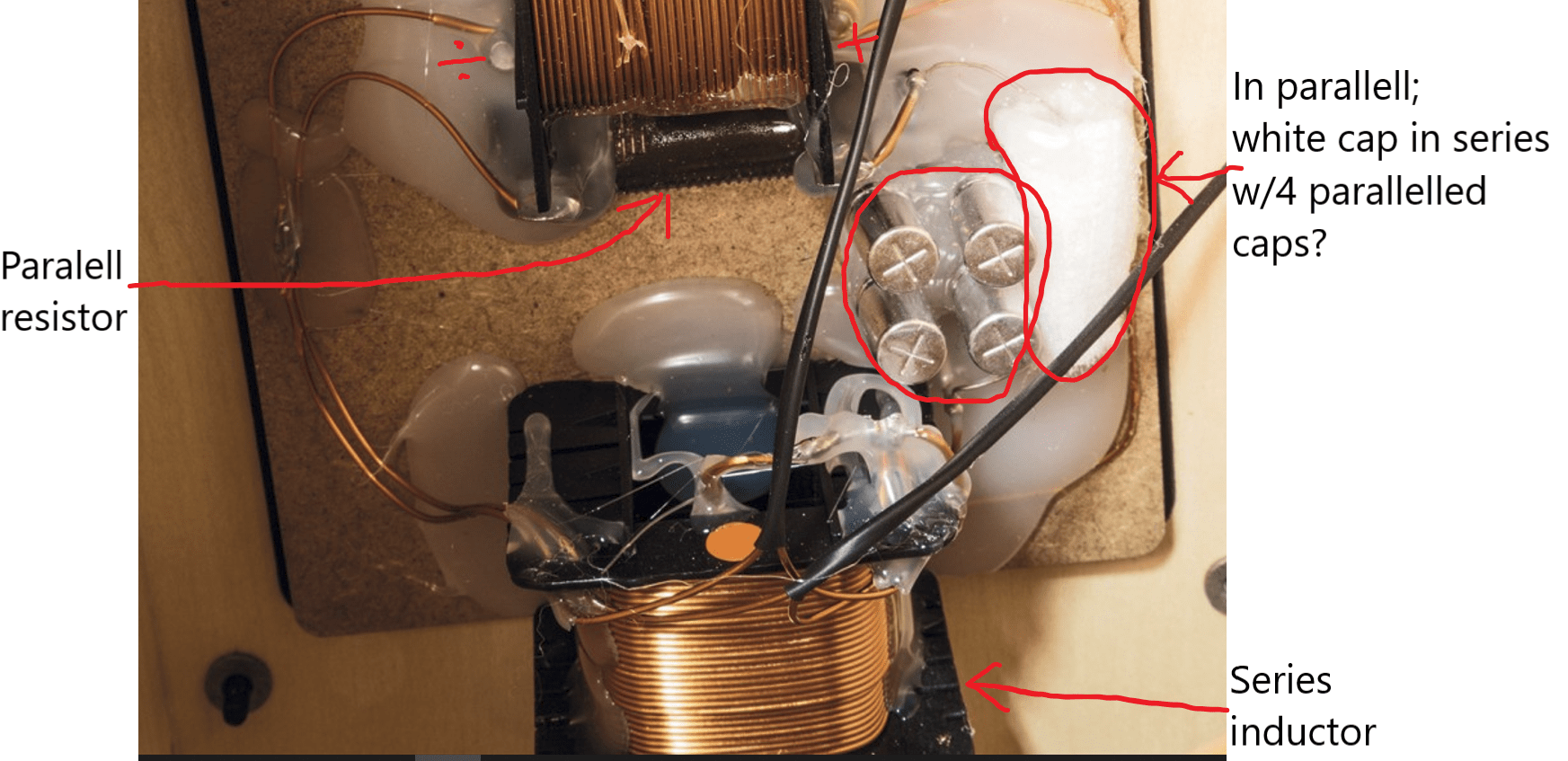

On to the LF network;
The series inductor is fine, and also the parallell resistor I think. But again it gets blurry with the 4 parallelled caps and the white encapsulated cap next to them. I assume they are in parallell with the network but looks like they are in series to eachother, which would be strange..

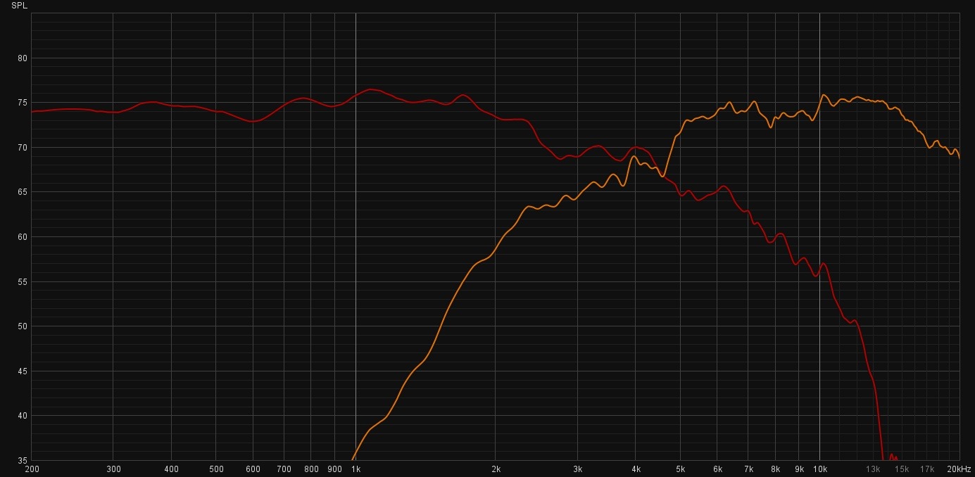

2nd order is correct, but XO is definitely higher than 3khz. Here's my measurement of woofers + tweeters separately, more like 4khz I'd say;

Maybe this helps - this guy upgraded all caps and resistors on the OBX crossover and the parts are not smothered in glue. The bass LCR may be for system impedance correction / tube amps; otherwise optional. Basically a massive mish mash of 6-7 caps in the bass section! 🤣 . Interestingly, the tweeter in the OBX doesn't seem to need a padding resistor.
As the modder only replaced exact values, it can be seen where and with how many bypass caps LV uses.
