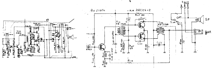

Hello! I have a portable radio tape with both Si and Ge transistors - Craftsman or 'Record O Matic' Record-0-Matic Radio Craftsman; Chicago, Illinois., build 19 . It had some problems on tape, poor sensitivity on AM, overlap on some FM near stations ecc. Hardly I have solved a part of them including new socket for power cable, new socket for batteries, new capacitors. By mistake I broke a pin from the final transistor 2SB364. I can't find this, but can I replace it with either a pair of 2SB324 or a SFT323?
Here is the diagram (taken from the radio).
Thanks. I saw on a Panasonic diagram which also worked at 9V that they used 2SB324. Should it work?
The 2SB324 should be fine. There so many very similar transistors at that time that will work. The EBC pinout was pretty standard too.

Replace both final transistors with the same type number new Germanium. Change the emitter resistors to 10X their present values (to ensure it won't burn-up right away). Smoke-test. Measure voltage on emitter resistors. I would expect your plan to idle at 10mA to 50mA (not fussy). If, with 10X emitter resistors, it idles at 1mA-5mA, all is well. Change the resistors back and it should play OK.

An AC128 is near identical.
The collector on both are the coloured dot or tab unlike the silicon type transistors.
