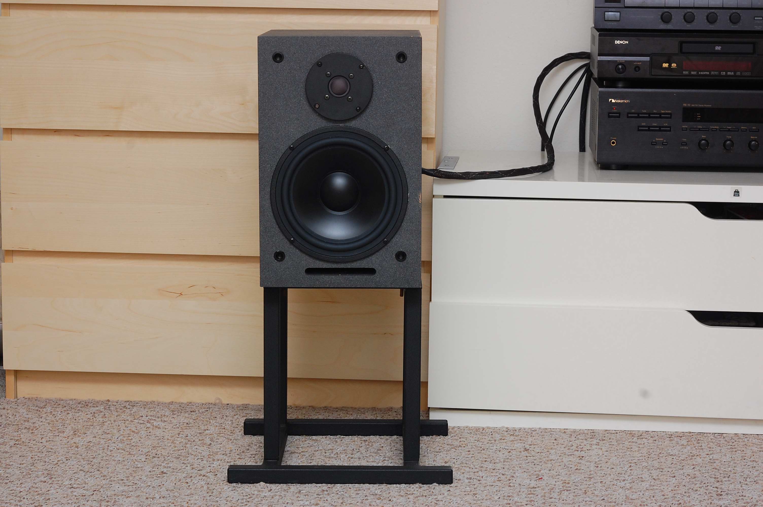

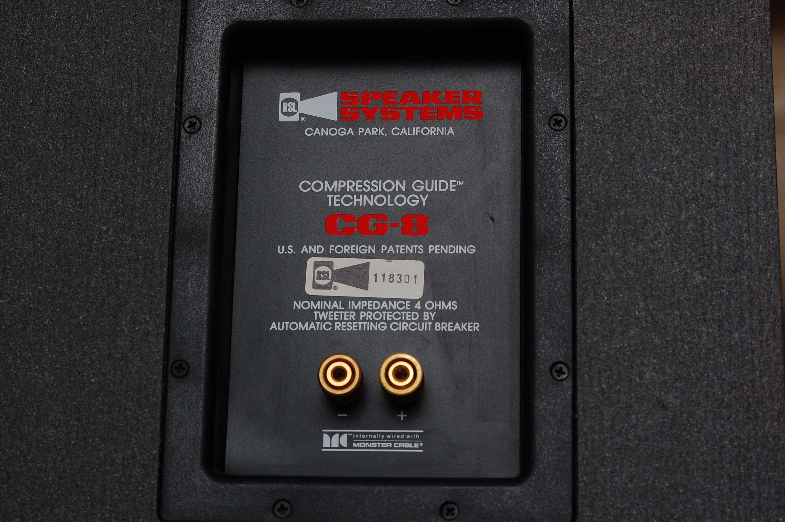

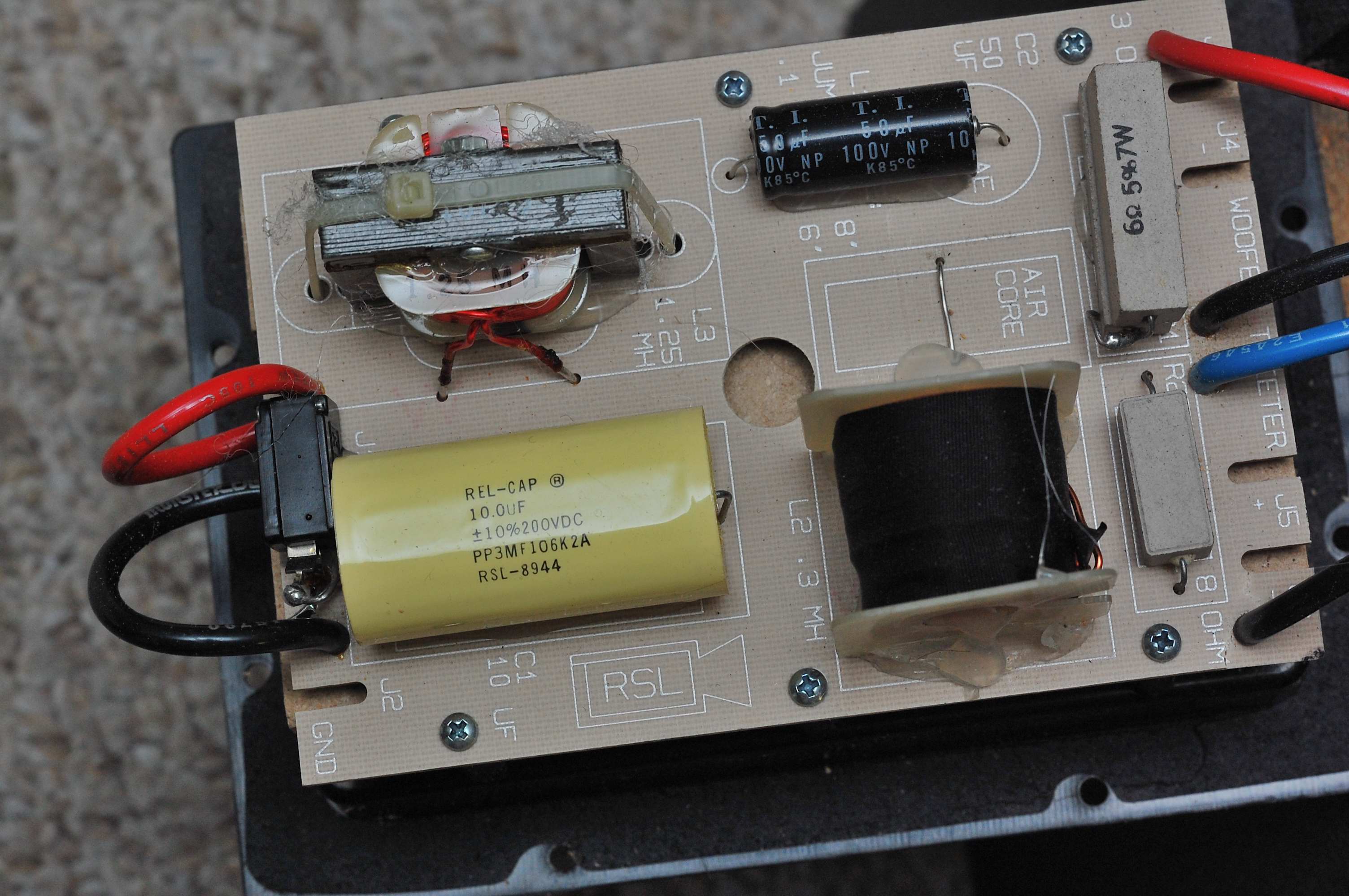

sorry for my limited english and lack of info I thought designing cabinet based only on woofer.The 8" Seas currently in my RSL CG8 and sounds much better from the original woofer but lack of base . I'm thinking of building box with intended design for 8" P21REX seas using the RSL CG tweeter and X-over this might improve the bass if the cabinet is design for this woofer? do you think I can hear difference? if so,what would be the cabinet dimension. some problem I can't find specs of my tweeter and xover

The value for components are all there, only missing is value for the second resistor, not visible.😎

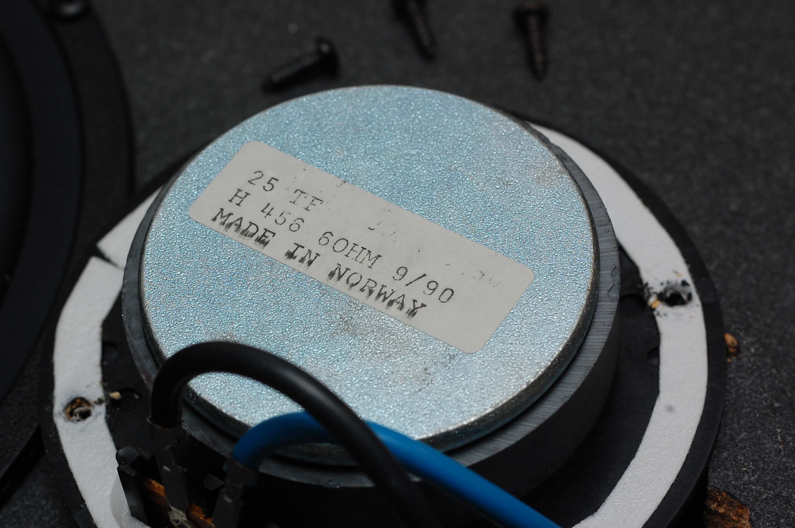

Tweeter Seas h0456/25tf
