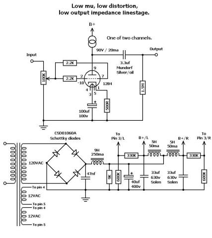

IMO, you need low net gain common cathode topology and the ability to drive a relatively low downstream impedance. There are several ways to get those characteristics, but (IMO) the most economical is circuitry based on 12B4s. Any number of good 12B4 designs are available to you. I [naturally 😉] have uploaded my own design. You don't have to use the pseudo choke I/P filter PSU shown. A well filtered and reasonably well regulated 150 VDC supply of 50 mA. will do quite nicely. Also, a costly, "boutique", part need not be used in the O/P coupling cap. position
BTW, the schematic shows how you "raise" a heater to suppress noise and/or avoid exceeding heater to cathode potential limits. Please observe it's done via a resistive voltage divider across B+ and ground.
