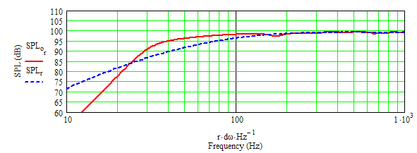

You're welcome! Now you see why I asked about any size limitations. 😉
No, being a much larger/taller cab it only needs a 6" diameter (~28.274"^2/182.412 cm^2) x 1.5" long vent to tune it to around 32 Hz, but in the interests of some extra tuning flexibility, an 8" should be used, which with 2.5 ohms series R and baffle thickness cutout should be ~half space max flat (~41 Hz) with the lowest practical tuning (~32 Hz) requiring a 4.5" long vent (shown with vent centered at 35.5" i.d. down from the top).
Backed up to a wall or near a corner with this low a tuning it should be nominally flat all the way down (except for room modes of course and assuming the amp has what it takes) and able to do all but 64 ft organ pipe fundamentals and some movie, etc., extreme LFE special effects.

GM,
As of my understanding, you prefer the vent 8" for tuning flexibility, and series a 2.5R to the speaker ( is this 2.5R works as XO to cut off from 1,200hz down )
So the vent dimension is 8"W x 1.5"H x 4.5"D and 35.5" I.D. down from the top. Do I mount the driver in between the top panel and top of the vent?
Albert

Correct.
Huh?! None of this has anything to do with an XO point.
Please re-read my #19 post. It's an assumption on my part to hopefully not make the cab unacceptably too small. If the bass winds up being too weak sounding, then use a cheap pot to dial in some more series R and replace it with a non-inductive wire wound power resistor assembly of whatever the pot's measured resistance setting is with the understanding that efficiency falls with increasing R.
?? An 8" diameter (~50.266"^2/324.293 cm^2) hole doesn't convert into a 8" W x 1.5" H slot, but a ~50.266/8 = 6.283" H one.
The 1.5 - 4.5" dims is the range of vent depths I recommend.
Ideally you would use 8" internal diameter (i.d.) pipe lengths to experiment with, but if you prefer to make/use different depth wooden slot vents, then I recommend a 13.625" W x3.6875" H (13-5/8" x 3-11/16") by the different depths centered at 35.5" i.d. down from the top.
Yes, driver at the extreme top front of the cab with the vent down near the bottom to create a MLTL.
GM

'The 1.5 - 4.5" dims is the range of vent depths I recommend.'
is it deeper the vent -4.5"- better the bass?
' then I recommend a 13.625" W x3.6875" H (13-5/8" x 3-11/16") by the different depths centered at 35.5" i.d. down from the top.'
I'll make to exact size.
'driver at the extreme top front of the cab with the vent down near the bottom to create a MLTL.'
So the driver is 15" and I'd put the driver at 9" I/D down from the top.
Is it OK?
Albert
BTW I'm going to make the box 42"H x 27.75"W x 17.75D

If by 'better' you mean it plays to a lower frequency before the box unloads and can't control the woofer any longer, then yes. If you mean the most chest slamming/'thumping' bass, then the higher tuning (short vent) is theoretically what you want, but the room dominates down low, so will boost the LF BW in non easily predictable ways and why you typically need to experiment with at least a high/medium/low tuning, i.e. 1.5"/2.6"/4.5" long vents.
Well, 'extreme top' with a 15" diameter frame = 7.5" down from the top, but I doubt there's an audible difference at 9" down from a strictly driver/vent distance POV. Depending on the XO point/slope you wind up using for whatever mids/HF source you perch on top of the cab though, it might make a difference due to the extra distance between their acoustic centers, so considering this I recommend installing the driver as close to the top as practical, i.e. same as an 825/828 (A7) cab.
Note that all dims are inside (i.d.) and approximate in case you're converting to metric.
Note too that the suggested design is based on the listed dims as being outside dims (o.d.) with a 0.75" material thickness, making the internal dims 40.5"H x 26.25"W x 16.25"D.
GM
