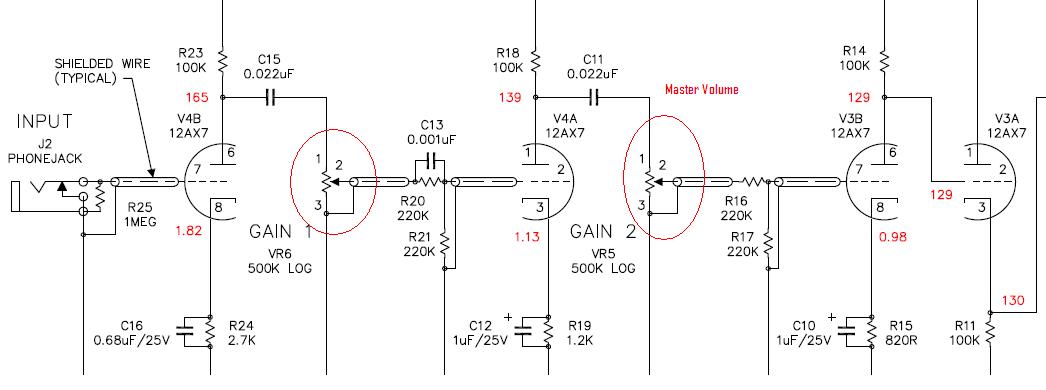

Everything is working. My issue is, I use the control on my guitar to control the max volume, but of course when I change guitars, the amp might be much louder or softer. I would like to add a master switch.
There is no tone stack on this. From what I have gathered, I need to add a 500K audio pot between the first preamp tube (12AX7) and the second preamp stage. I have identified the pin with the signal, and verified with a multimeter it was the correct pin, but I wanted to double check before I screwed soemthing up...

**edit** I think I understand what you are saying. Here is the schematic I am working off of. I know it does not match exactly, but it is near what I have. Same tubes, and same PP setup.
http://yfrog.com/j718wattliteg
With that in mind, should I follow it and try to place the volume where it is in the schem above?

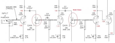

Where abouts in the schematic would I go about putting it after the splitter?
Typically, the first stage is wide open... then volume/gain... then additional gain stages.. then master volume, then output stage. This format reduces noise to a minimum in a maximum gain environment.
In the case of the attached previous schematic, there are 2 gain stages (1 low 1 high) then the volume control. To add a master to this would be simple -- wire in a stereo pot into the control grid circuits of the el-84s....

Could you point me in the right direction here... Should I stick with a standard 500K stereo pot? Ok so I would just wire the control grid from each EL84 into the stereo pot? Makes perfect sense, if that makes sense 😛
Do I have the right idea?
And as far as the volume goes, I should put it in after the second stage? I am just about to solder it in here, thanks for the help

Volume control on a guitar amp goes between the output of the 1st stage and the grid of the 2nd stage. It also acts as the grid resistor for the 2nd stage so you should remove that assuming it's currently there.

I have identified the output of the first stage, and the gid of the second stage. In between them, the line runs to a filter capacitor. (large can one) I did not know the 500k pot also acted as the grid resistor also, (although now it makes sense). So maybe that is the issue. I should remove the grid resistor on the second stage, and see what happens. I will try it when I get home. Thanks for the help 🙂

There are no hard-and-fast rules about where a volume control should go in an amplifier.
Forget the grid resistor in the second stage. A 500k pot should not be loading this significantly but the exact topology might be important. You can't do this stuff by rambling on. Draw a diagram on a piece of paper and photograph it at lo res with a digital camera so there's no confusion about what's going on. Remember pencils?
