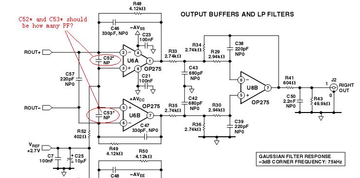

this is common abbreviation for lazy engineers.
NU = Not Used
NC = Not Connected
NP = Not Populated
They all means the same, and in this case, the cap should be 0pF.
NU = Not Used
NC = Not Connected
NP = Not Populated
Could also mean non-polarized, but it doesn't seem to be so in this schematic. They are using symbols to indicate polarity.
Some operational amplifiers don`t like ultrasound signals on input. This capacitors is simply filter for it. Value may be 100-4700 pF range. Use high speed opamp, then this capacitors not needed. Looks like AD812.

I've made DAC on AD1853 (PCM2702-DIR1703-AD1896-AD1853) with the same output stage suggested by Analog. I used OPA627 for I/V and AD797 for filter with great results.
