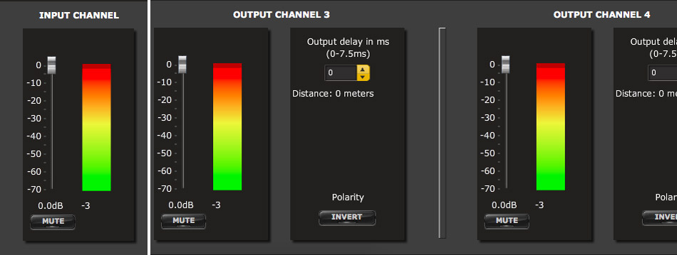

Hi everybody,
I received yesterday a pair of 2x4 balanced and a pair of miniDIGI to stack on.
The output level, on both boards, is very very very low, some mV despite the high level output seen on the monitor.
Same thing on analog and digital input.
-3dB output level gives 10mV.
Any clue ?
TIA
Alain

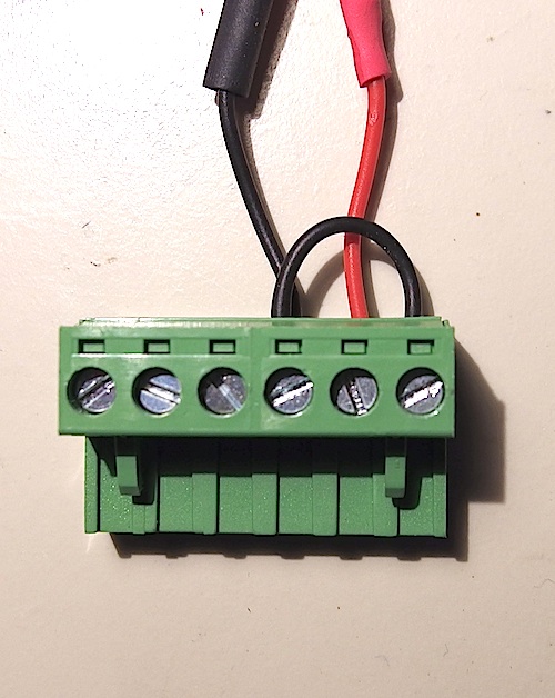

Alain,
Are you sure you don't have a connection issue on the outputs? If using an unbalanced interface, you would utilize the "S" and "+" outputs. Is that how you're configured??
Dave.

Absolutely.
S and - wired, unbalanced signal between S- and +, inputs and outputs
And I also measured S+ and S- of each of the four outputs without any wire
Did it with I2S input too.
I try again 5 minutes before this reply, analog and I2S inputs, same result.
It's very strange that the both boards act as the same.
I am pretty sure that the "unflashing led" board is out, so it should lead to non operational outputs, but the other one is quite a mystery.
My 2x8 is working nicely on balanced outputs.

Since the output indicators in your plugin indicate a good signal, it would seem the issue is external to the DSP chip and located somewhere in the analog output circuitry.
Dave.
