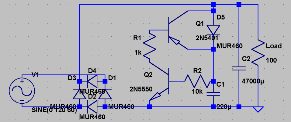

D5 charges C1, wich upon full charge triggers Q2 which triggers Q1 and regulates current in accord with the fluctuations. C2 regulates voltage. I think connecting a 2K resistor between + and Q1's base might help the freakishly overdone voltage... Any suggestions?
C1 can be increased for better current stability and the same for voltage with C2.
I faled to clarify something on my design: when Q1 is triggered, it allows current to flow from C1and smoothen out the current. I am wondering if I could use JFET to regulate voltage in the same fasion for the sake of cost. Actually I haven't the slightest idea about regulators and power supply's, so I do not know any terms. So go easy on me, okay?
Currently the circuit is doing the opposite of regulating current, so I am trying to implement an inverting regulation setup. Please don't be repelled by my lack of experience! I just thought about checking out this design.
I figured out that the over-voltage from Q1 is coming from it's emitter, so I will see if a current limiting resistor will do the trick.

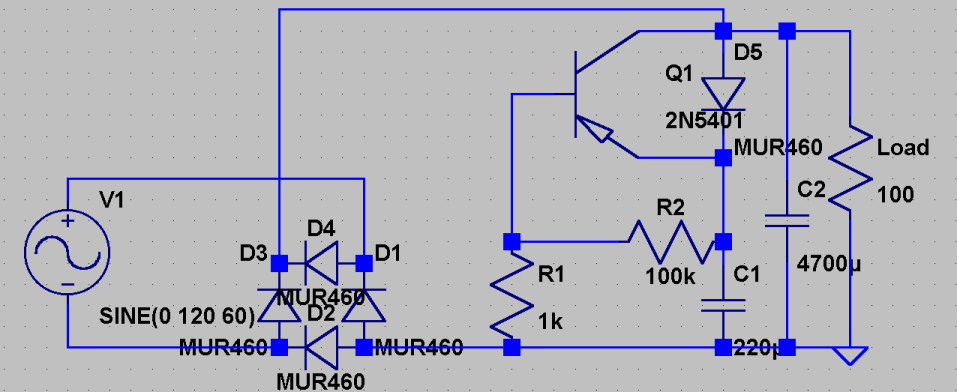

This time I use one PNP transistor and a voltage divider to bias it (of course). C2 is not completely necessary, except to regulate the voltage.
One gain is that it handles 10A better.
I have also noticed that placing a resistor just before Q1's base helps smoothen current but slightly increases voltage fluctuations.
Assuming there is a resistor (R3) just before Q1's base, I have found that:
for 1A-2A R3=1M nominal.
for 3A-5A R3=680k nominal.
for 10A R3=470k nominal (this isn't as good regulation).
If you need more current regulation and not necessarily as much voltage regulation, increase R3. If you need more voltage regulation and not necessarily as much current regulation, increase C2.
NOTE: These values were found on a simulator so expect them to be a bit off.
keantoken,
I do not wish to discourage you, but you really need to take a step backwards and learn the basics about electrical and electronics circuits. It is obvious that you know a lot for a 13 year old, but you should take a course in Basic DC and AC circuits. You need to learn Kirchoff laws and develop an understanding resistance, voltage, current and impedance. Then you should study diodes, and transistor. Once you learn this you should be able to bias a BJT ands get a common emitter circuit to work right. If you have a specific question, I may be willing to help. (Most of the circuits you have posted demonstrate a lack of basic knowledge and are not worth commenting on.) Again, no offense intended.
Rick
Rick
Hi keantoken
I can't see how your simulator is telling you that this circuit is regulating at all. The load is directly connected to the bridge rectifier. The transistor needs to be an NPN for this configuration to work and the load needs to be connected to the emitter. You'll also need something a lot higher rated than a 2N5401 as it's only good for 600 mA max. Then your voltage divider wouldn't be able to supply sufficient base current so you would need another amplifier stage.
BTW, you are not seriously thinking of connecting this to the AC supply without a transformer are you?
Take care.
Rob
Take care.
Rob
I was just going to ask the same question Rob. It looks like this is line operated- directly. keantoken, It's really not worth your saftey to do this without a transformer.

I am definitely not going to connect it directly to the mains, because even I know that anyhting can short out and make in a second worth of time a life and death situation. In reality, I wouldn't dare build my own regulator without completely knowing that it was safe and at least having some promising remarks from my fellow DIY-ans. If that I would probably have someone else build it to make sure that all the solder connections were right so that nothing would short and cause an in-the-wall fire. I am only 13, so I wouldn't want to play around with my life like that. I was also noticing that the simulator wasn't really seeming very smart with this circuit... This is why I don't like simulators. The problem is, I don't have enough resources to build every circuit that I think is halfway promising.
Back to the circuit, I was trying to figure out how to get a steady bias or how to use an unsteady one to my advantage but I think I am getting some ideas... I think I want an inverting amplifier to discharge the capacitor and regulate the current but I would have to put a bias on the output of the inverter which would cause the unregulated current to affect the transistor and I'm not quite sure how I can prevent this or use it to my advantage. As for the transistors I didn't have any better models (except for the whole Q2N**** library which I don't know the specs for any of them). Any help on the regulating transistors? I knew there wasn't something right in the simulation...
