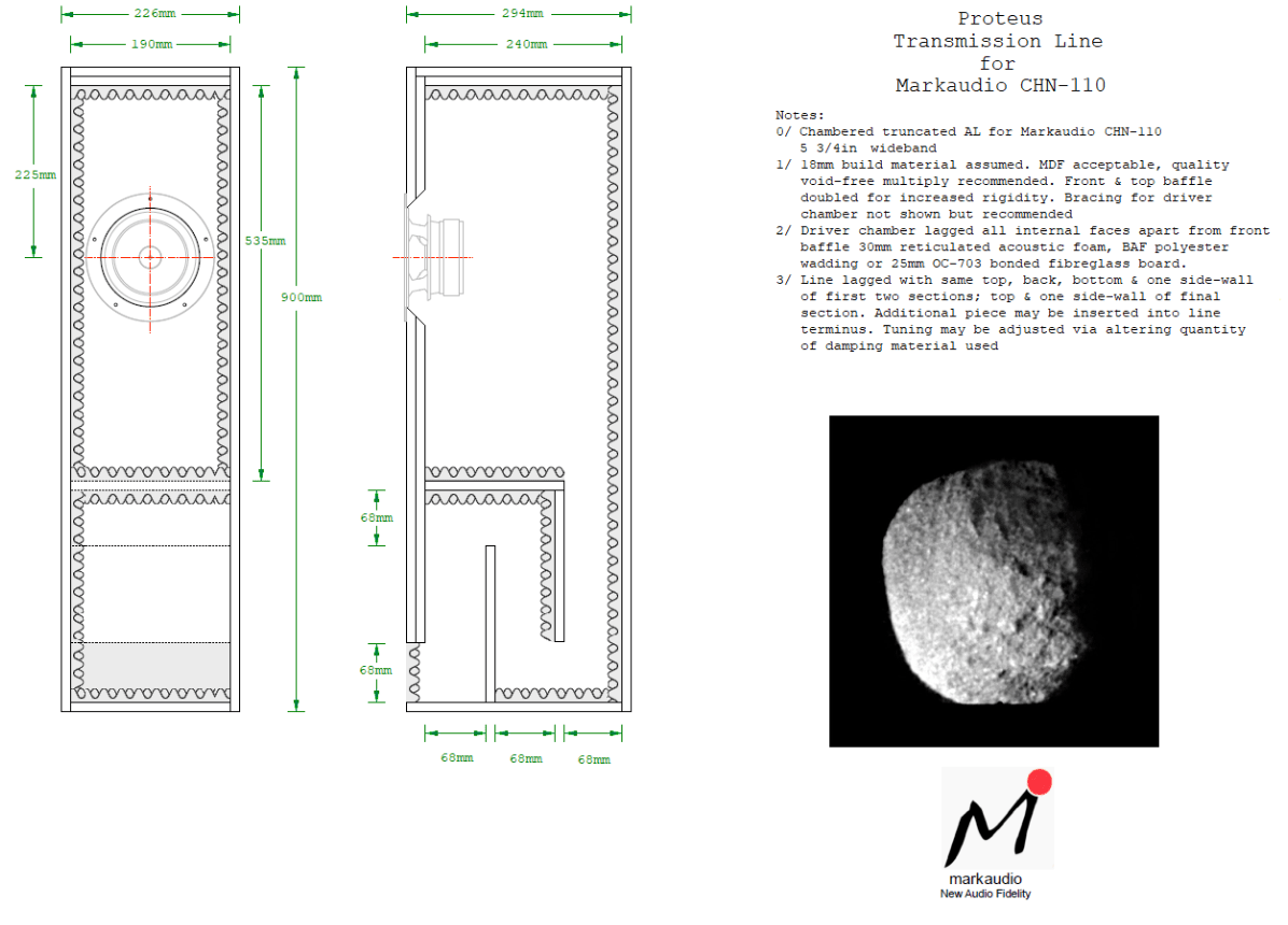

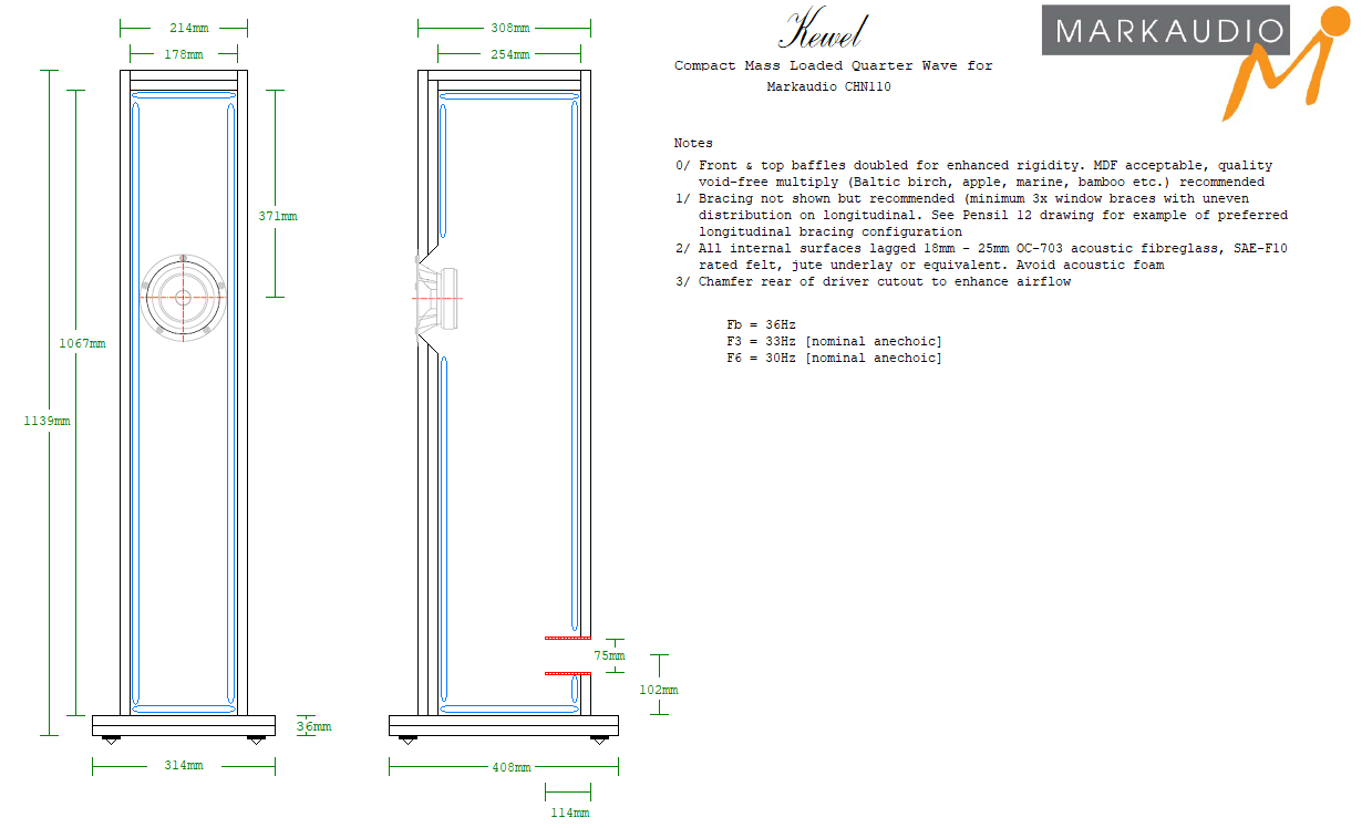

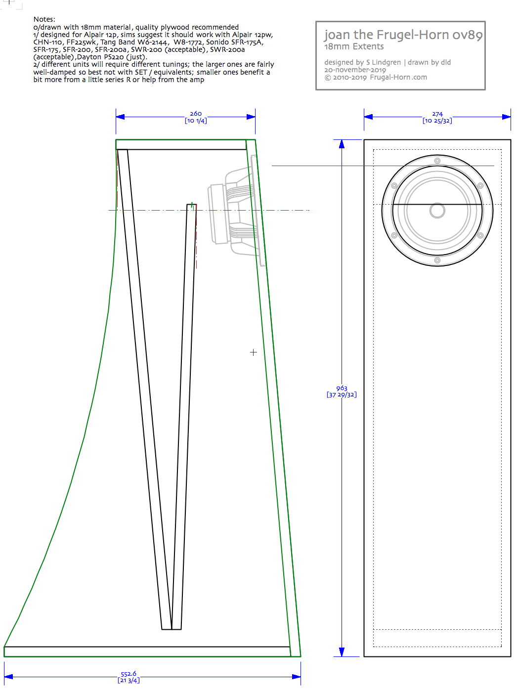

I bought the Mark audio CHN 110 and I need help to choose an enclosure.
I want a box with very good bass extension but with a tight and clean bass too.
I am opened for all sugestions.
I found this 3 cabinets that seems interesting, but J dont know what to expect from each one,
Proteus - TL
https://www.markaudio.com/wp-content/uploads/2022/08/Proteus-CHN110-RTL.png
Kewel- Compact MLTL
https://www.markaudio.com/wp-content/uploads/2022/09/Kewel-CHN110-compact-MLTL.png
Frugal honr XL
https://www.frugal-horn.com/fh3-plans.html
if somebody knows something about this cabinets and can clarify what each cabinet delivers in the end for me it would be great,
so then I can understand more and choose the right one, in the case to be one of these cabinets you advise me to build because its what I am looking for.
Thank you

CHN-110 is a really decent driver, and when price factored in, a real killer.
It is a driver that likes a bigger box.
IK heard it in FHXL where it is really good, Scott suggests it will do better in Joan.
I expect teh response of the 2 ML-TLs will be somewhat different. The horn give smore LF gain.
All are tunable for the room with judicious use of damping.
Which one can your SP live with?
dave

I like the Joan but I read that the FH are room dependent right? Because I dont have a dedicated room and my bedroon where the speakers will be is not big (12m2)
I check the plan of Kewel and there isnt the lenght of the duct only the diameter, do you know the lenght of that?
