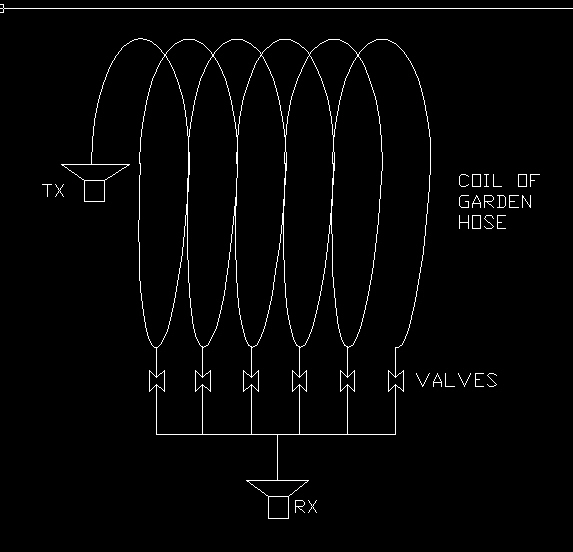

jackinnj said:use a length of garden hose with a pair of transducers on each end
Yes... at 340m/s, you need 68 meters of garden hose for 0.2 sec. delay...
with some valves you could also have a great variable delay echo...
acid_k2 said:with some valves you could also have a great variable delay echo...
Could you elaborate on this?
