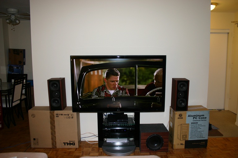

I recently picked up a new LG 55LE5400 and Denon AVR-990, and I'm looking to replace my aging Wayne J. Dayton Home Theater DIY.
My most recent DIY was a pair of CSS ELF 1.0 (Tangband W3-871S) driven with a Sonic Impact T-amp. That was ~3 years ago and they're still serving me as wonderful PC speakers. I decided it may be worth it too look into fullrange for my home theater setup as well.
I have 3 main constraints:
1. Complete complimentary system (LCR+surrounds).
2. Preferably 8-ohm speakers than can handle the claimed AVR-990 120W/ch.
3. This unfortunate setup:
attachment.php
The viewing distance is about ~10' and the fronts of the speakers can be no more than 18" away from the wall (I'm assuming this elminates bipole designs?).
I've been primarily interested in the EL70, the CHR-70, and the Alpair 7 due to the favourable reviews and ease of access. In particular, I've been looking at the the Coniston^2 or the castle microTowers, but I'm not sure how well those will fare with my room and how I'd integrate a center and surrounds. I'd like to purchase from Creative Sound or Solen if possible. Duty, taxes, exchange, and brokerage fees are a pain for US purchases.
Other than what I've outlined, size/shape/complexity is a non-issue. I'm fairly skilled with woodworking and have a full shop (sans lathe) to play with.
Any help is greatly appreciated, and if there's anything else that would help in guiding me, please ask. Budget is not really an issue provided it's under $750 for all drivers.

10' distance ?

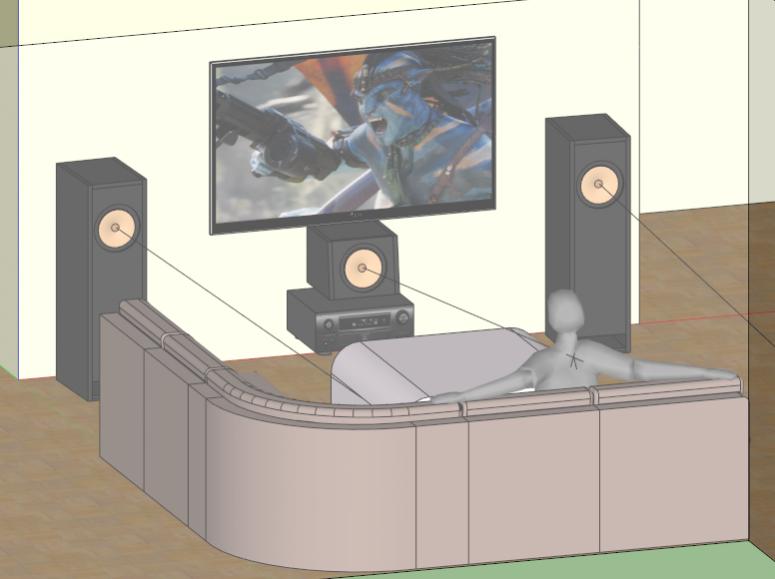

Thanks for all the help guys. I ended up picking 3x Alpair 12's in front. L/R in Pensil12's, center in the same sealed center as Graham's FR HT project (Graham's hifi page).
I was a bit worried about the off-axis comments, but I did a quick sketchup with the boxes I'm building and as far as I can tell it won't be an issue.
attachment.php
Rear's are 2x Alpair 7's in modified mMarS. I'm still not too sure how to situate them. I think it'll come down to experimentation with the awkward layout I'm faced with.
I probably won't have the drivers until the end of the week, but I finished cutting all the enclosures today. Just need to route and assemble. I'll be sure to post completed pics.
