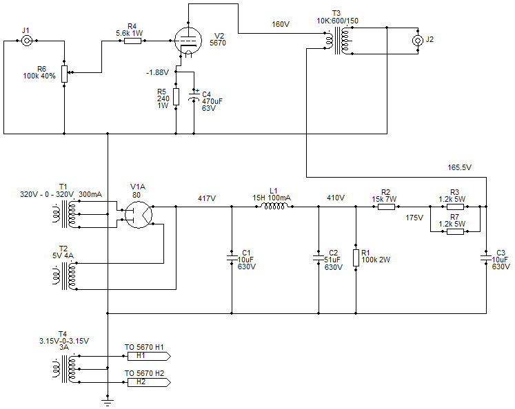

Been here for years but reading most of the time, now want to seek advise on my 5670 pre-amp, originally using 6x4 as rectifier, since I want to change it to 5Y3 (JJ have new 5Y3 tubes) , using 5U4G is an overkill, but I got better choice for quality tube.
I'm not good at the circuit, I can read but dare not to change, I know the value is different, they're not interchangeable. At that time I got help from a friend to finish it, I don't really know how to calculate. And he move to 80 and left no 6x4 circuit diagram for me, below was the "new version" already using 80, and "old version" of the pre-amp inside, I've already replace the power with Tango ISO and the sound become more solid and more energy. I've regret not taking a high resolution photo of the latest one.

5Y3 is directly heated and 5V, 6X4 is indirectly heated and 6.3V.
It will work fine, but you need an isolated 5V winding for it. Personally, I'd use UF5408 diodes and call it a day, or rewire it for 6Z4 since they are cheap and work fine.

As kodabmx said, the 6X4 is an indirectly heated cathode tube. One thing it does is Delay the time before B+ is alive. Type 80, 5Y3, etc. are Not delayed turn on. Just something to be aware of.

Perhaps (probably) the original design used a 6X4 because it can run off the common 6.3V filament winding of the other tubes. The 6X4 does not need a separate 5V winding.
The 80, 5Y3, etc. need a separate 5V winding (more transformer, more money).
Design to a price point.
The delayed B+ might be more important for Certain types of power output tubes, and not needed for most line preamp tubes, and for many output tube types.

Delayed heater can also mean the difference between needing 450V caps throughout the entire amp power supply vs only 250 downstream of the filter.
Saving a few bucks this way isn't optimal but it happens a lot in production hardware where a few bucks per amp means tens of thousands down the road.

Before considering this, you'll have to pay attention at two points:
- Does the x-former have a separate winding for the 6X4 heater? Otherwise your suggestion won't work.
- Does the new tube draw a heater current of not more than 0.6 amps? Otherwise most probably your suggestion won't work.

Yes,
Direct heated rectifiers do require a separate filament winding.
Otherwise, how would you like 350V on all the other tubes filaments in the amp.
Some indirect heated rectifiers have a direct connection from the cathode to one end of the filament. That also requires a separate filament winding. The 5AR4 is one such rectifier tube.
Some indirect heated rectifiers do not have a connection from the cathode to the filament. The 6X4 and 6X5 have those cathode connections that are separate from the filament connections.
That does not require a separate filament winding. Simple, and less expensive.
But . . . if that filament to cathode insulation ever breaks down, you will most likely need to replace all the other tubes too.
Now you know why I prefer directly heated rectifiers with separate filament windings.

If low HT sag is a must, directly heated rectifiers are a no-go. 5AR4's or even paralleled EZ80's, EZ81's or 6X4/EZ90's are preferable.
