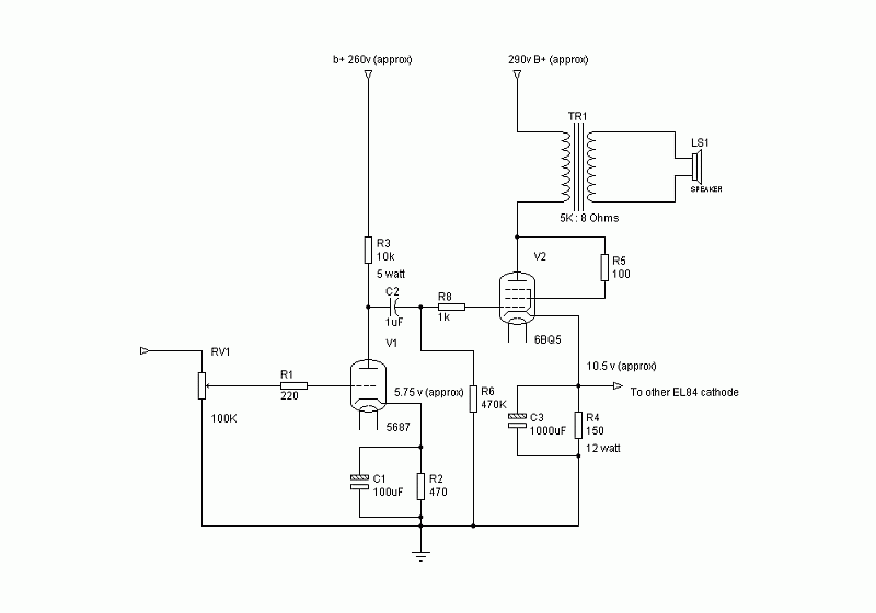

Basically the schematic is a Decware Zen using a 5687 in the gain stage instead of a 6N1P. The output power is about 3 watts. I didn't use a choke in the power supply of this amp so that won't be a problem. The attenuator would take the place of the 100K resistor. I had no problems with hum but if you want to go DC on the filaments I would start out with just a filtered DC supply. Keep the first project simple. Basically I need for you to measure the no load voltage on your power transformer from one lead to the center tap and then measure the winding resistance from one lead to the center tap and I can tweak the power supply to fit your transformer. The layout of the amp I built can be found here:

After downloading the schematic from Decware, I would have to say that this is definately the way to go. Everything I want is there and I could put all of it on my chassis with little or no modification. I did some measurements on my PT and came up with the following:

There are no center-taps on the filaments, and judging by the Decware schematic- that might be a problem. Also, the 01uf coupling cap seems a little small (add a 1uf?) What do you think?

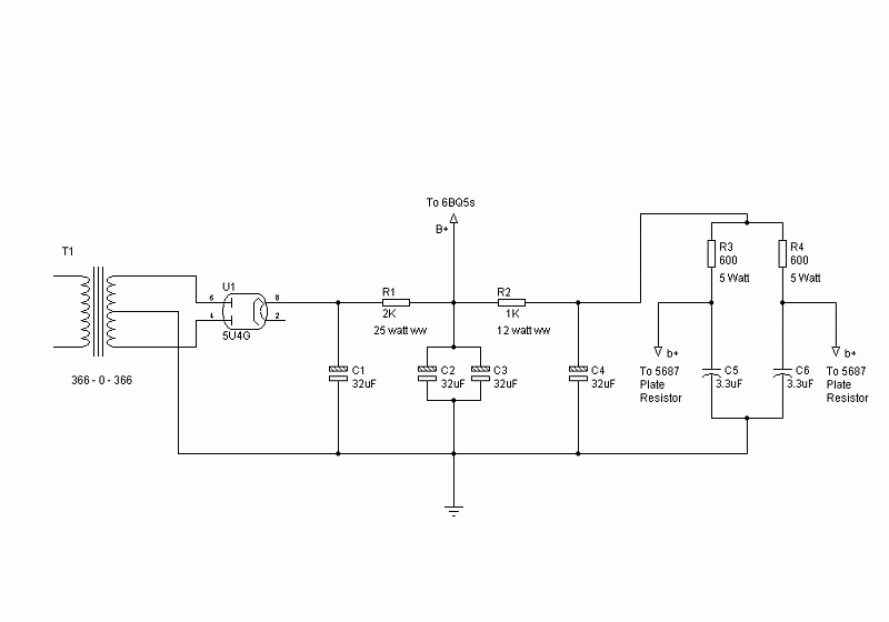

Well you can see the finished product for yourself below. No CT on the filament winding is not a problem. Especially if you are going to be using a regulated DC supply for the filaments. Yes the .1 cap is too small. Use a 1uF 600v cap. I will post the PSU in a few minutes.
Here is the PSU. Keep in mind that the first resistor (R1) is dropping a lot of voltage. Make sure to use a 25 watt wirewound resistor. Michael Percy Audio is a good place for the 25 watt ww and for Mill's 12 and 5 watt wirewounds. That is pretty much all I use in power supplies for power amps. He also sells Kiwame carbon film resistors that work very well in tube amps as plate and cathode resistors. The choice is yours.
Any particular reason why the cathode resistors of the 6BQ5s are shared between channels?

1µF into 470K?
0.220µF would already be much more low frequency than the OPT can pass.
Don't get me wrong, it will of course work but the higher the RC constant the slower the cap will be.
This could be something worth fiddling a little with. You may find the amp's transient improve with smaller value coupling caps, moreover I'd doubt you'd notice any difference in the bass response.
Cheers,😉
Damn. The .047 coupling cap should read 1uF. Later.

fdegrove said:Hi,
Cheers, 😉
Hi Frank,
No. Other than when I was building this amp the schematic model I used biased the output tubes this way. I have since built a different amp and used separate cathode resistors. You are correct in pointing that out. Separate resistors would probably be preferable. If you do use separate cathode resistors CadaverDog you should double the value to 300 ohms for each resistor as yo will only have half of the current flowing through the resistor and therefore only half of the desired voltage drop (10.5v - 11v).
