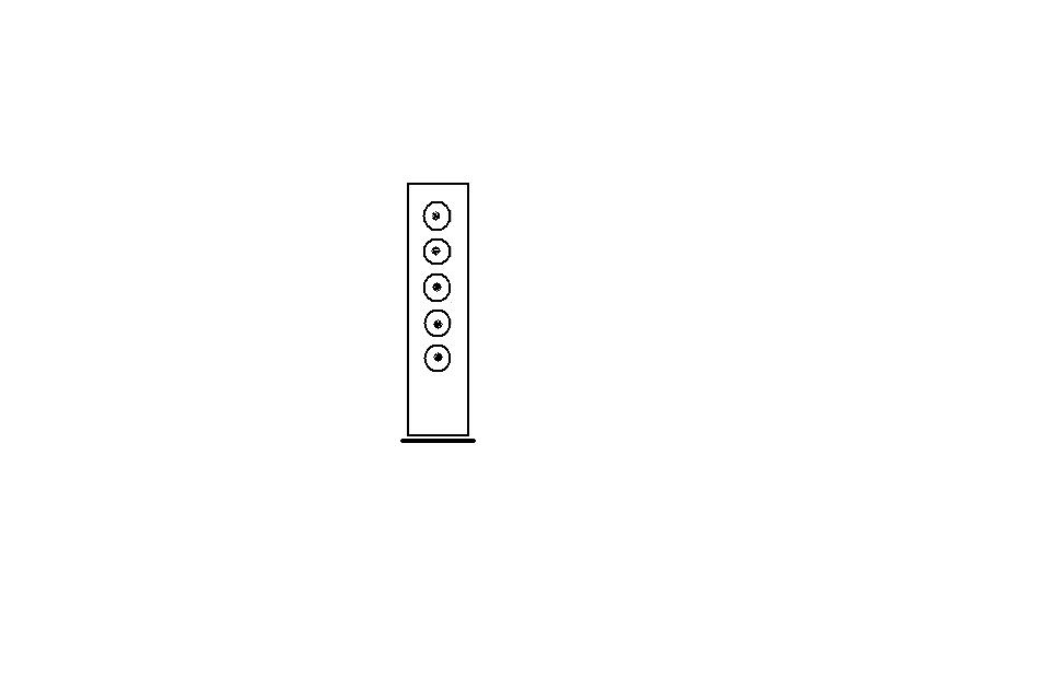

I can't decide what route to go for my main speakers.
Total budget for speaker drivers will be around 1000 USD.
My listening room is small, so speakers should have relatively compact footprint and unfortunately should be placed near wall.
After lot of experimenting with many multi-way sealed or ported designs during years, last few years I settled and listened full range Beyma horns ("Das Viech" project) as my main speakers, just to go fullrange route for a change. 🙂
These speakers are probably one of cheapest backloaded horn designs that you can made and during few years and many hours of listening, I'm still not sure what to do for next project - I really don't know should I go back to usual multi-way systems or start experiment with more serious (read expensive) fullrange drivers & even more complicated horn enclosures...🙁
Because even after searching and reading numerous posts dealing with good old debate "Fullrange vs. multi way drivers", it's even harder to decide what to do for next project , as both "sides" have some good and interesting arguments.
Maybe I could decide easier if I listened some high-end fullrange speakers - but problem is that I don't know anybody who is listening such speakers, neither have possibility to find some high-end dealer in the neigbourhood with such equipment.
What I do know are some crucial factors that my next design must include in order that I could live happily with it:
1. it must have ability to reproduce my biggest part of music collection (pop, rock, synth pop, new vave of 80s,etc) for long listening sessions without fatigue - and trust me, with some bad recordings (and unfortunately there were many in 80's), Beyma fullrangers could be painful to listen - midrange shout can be u-n-b-e-r-a-b-l-e...
I mean, if I buy two expensive fullrange drivers for 1000 USD and still have to live with ear piercing midrange shout - hm, that certainly isn't my cup of tea
2. it must play lower then Beyma's - that shouldn't be much of a trouble as they don't play anything worth mentioned under 60 Hz...
3. it should be at least a little bit smaller - these two floorstanders (125cm x 30 cm x 50cm) dominate my little listening room (16m2).
4. I wouldn't like to loose effortless dynamics, control and extremely tight & fast bass - that were features that I liked the most with Beyma's...and that's probably biggest reason that I still listened to Beyma's even with their midrange shout, uneven frequency response, lack of frequency extremes, lack of details... listening very loud to some recordings with real drums I can easily understand why horn freaks exists. 😀
But I would certainly like to avoid coloration in midbass that couldn't be avoided in horn mouth with some recordings (heavy, slow bass lines in Massive Attack for example).
And for conclusion - as I don't listen classical music so much or have musical background to have ability (or need) to recognize Stradivari or Amati violin when playing, I am perfectly aware that I don't need ultra analytical, studio monitor type of sound, that have to reveal all the tinest details in recording and will have ruler flat frequency response. (I heard once active Genelec monitor - and I didn't like it).
I just want speakers that can play many different type of music with ease, maybe slightly warm sounding with transparent midrange, fast, tight bass, with minimal box colorations.
I don't need bass extension to 20Hz - neither I have enough room to reproduce such frequencies correctly, neither I have recordings that go that low.
Now I would like your opinions, advices and ideas 🙂

if you like full range now, and apparently have no complaints about the directivity of a larger full range driver, I suggest you stick with a full range loudspeaker.

Small room = close listening distance = fairly wide dispersion required, ergo multi-way preferred along with either speaker toeing in capability or complex baffle angles/mirror image cabs after NHT 3.3 for widest 'sweet spot', though this doesn't mean I recommend cloning it pre se since I prefer 'FR' drivers to cover most of the BW with super tweeters and a multiple units sub system to fill in the top/bottom.

FAST systems offer a very useful middle ground between a traditional multi-way and a single driver system. A small "full-range" which compromises bass for midrange, top and good desperion, coupled with a midbass , or woofer to provide bottom end heft and relieve the little driver of bass duties can get remarkable performance. The XO is low enuff that many of the issues with XOs is pushed out of the areas where we are most sensitive.
Currently i'm listening to such an implementation... FF85 + SDX7 actively XOed at 333 Hz. They are called Tysen.
You'll also note off to the left an Alpair 5 experiment. I often end up sitting to the right of the rightmost speaker, and they still pull a decent image.
Martin King's passive OBs are another example. (we have one of those underway too)
Any number of small "FRs" can serve duty as the mid-tweeter, the FF85KeN i've used above, FE83/87, Alpair 5/6/10, any number of TBs ....
dave

Bubba Zanetti said:Tysen design has sealed box for woofer, if I am correct? How low can they go in your room?
Tysen is sealed bass, aperiodic TL for the mid-tweet. Bass to !40 Hz in room, 25 Hz with a touch of boost.
Could you make some comparisons with some of your previous designs? Was their lower sensitivity problem for louder listening?
They need bigger amps yes. The small SE amp that does fine on the FonkenPrime, doesn't really cut it for the FF85KeN. Currently using a 20w triode strapped KT88 PP that is a development mule. Bass has 150W dual mono MOSFET amp. I'd suggest 10+50 w minimum.
Their sound definitely puts them in the same family as our other regulars. More extended highs than the bigger drivers, more impact in the bottom (except compared to the double SDX7 TLs -- TLs don't go quite as low, but the 1st cut TL was size compromised).
Hm, Alpair 5 + SDX7 combination for woofer is very tempting...is there possibilty to integrate maybe 2 woofers (SDX7's for example) in tall TL enclosure in combination with Alpair 5 for mid/high duties ?
The original concept that Tysen came from had Jordan J6T. Alpair 5 or Alpair 6 could be used instead of the Fostex. We don't yet know if that will be as good, the fully treated Fostex is pretty amazing. Our Alpair 5 comparo enclosure is just being finished up. Alpair 6 should be here midweek.
As to 2 SDX7 why not... before i put Tysen back in i was running uFonken on top of the dual SDX7 fonkenWoofs. What i'd like to see someone do is to take the MTM version of this SDX7 ML-TL http://p10hifi.net/planet10/CSS/SDX7-ML-TLs-110708.pdf,run a piece of 4" ABS pipe from front all the way thru the back in the T position, and use an FF85KeN, Alpair 5 or 6

Bubba Zanetti said:And then I realized: "gee, I'm building 3-way fullrange system, am I an idiot or what ?...
Verdict: Fullrange - yes, but only in multi-way combination
I have been an advocate of this kind of thing all along. But i firmly believe that if you start with a "midrange" that by itself can give you a musical system then you are way ahead of a typical multi-way system... the XO(s) can be pushed out to where they are much less objectionable.
My big Fostex system has fonkenWoof with 2 SDX7 XOed at 100 Hz to FonkenPrime with FE127eN. I have been playing with supertweeters up above 15k, i haven't gotten far enuff to decide whether they'd be missed.
With Tysen the little "FR" extends well beyond 20 k (Fostex spec 32k), and bottom down below 40, and imagine like crazy (but then so does the big system)
Llistening to stock Fostex in no way reveals how good these drivers can be.
dave

the Tysen concept might just be what you are looking for... 😀
