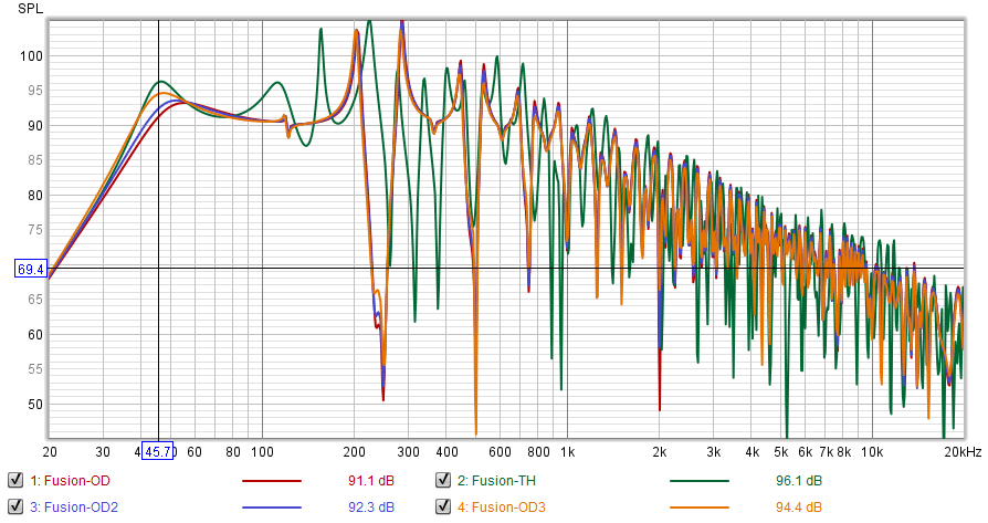

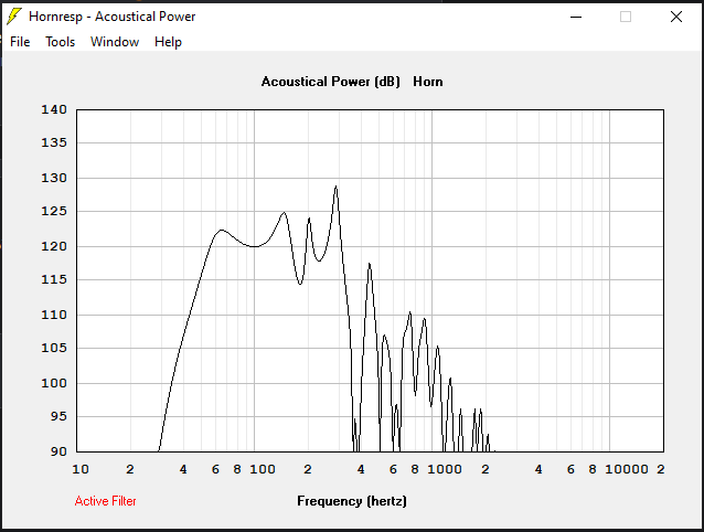

With the given Spec sheet it definitely sims better in the Tham 12 instead of the MTH 30 but still a bit peaky.
This is 32V 6mm xmax excursion 8th order LR 30hz Hi Pass

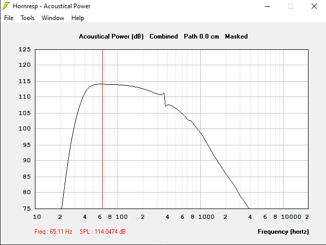

Looks good in a BR - with 50 60 litres tuned to 40Hz but about 91db/W
28V 6mm xmax excursion 8th order LR 27hz Hi Pass
Finally Tham 12 vs BR at 2V (1 watt nominal @ 4R) - no filters
My thoughts are build Tham 12 & have fun - If it does not reach expectation or blows - get a new driver & carry on!
