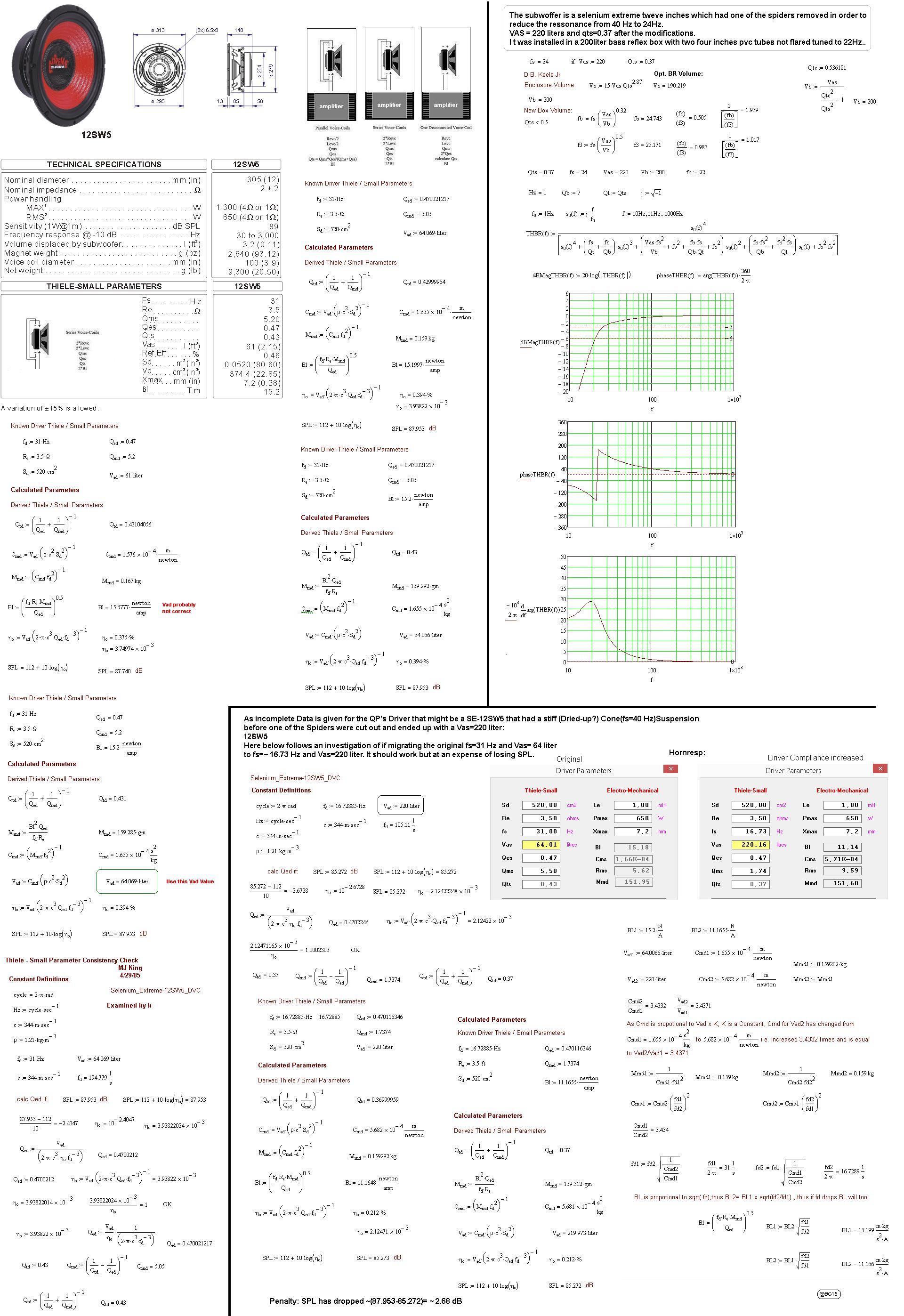

After a long time preparing myself , buying measurement equipment and the materials I built a subwoofer for low frequency effects in home theater.
My front and surround speakers are Behringer 2031A which have a nice output from 35 Hz up. They are externaly equalized and delayed to have similar response in all seats.
The subwoffer is a selenium extreme tweve inches which had one of the spidders removed in order to reduce the ressonance from 40 Hz to 24Hz. VAS = 220 liters and qts=0.37 after the modifications. I t was installed in a 200liter bass reflex box with two four inches pvc tubes not flared tuned to 22Hz..
According to my mini dsp usb microphone and REW software the frequency response and distortion are better than I deserve🙂.
The subwoofer is feed from a behringer 3000 dsp, equalized with several deeps to reduce the room ressonances.
The only problem: Ican not reach THX sound pressure levels due to the voice coil hitting the magnetic structure in high intensity passages of movies. Measurements indicate the hitting occurs even at the ressonance frequency of the bass reflex in high power.
My first diagnostic is : the high turbulence of the air in the 4inches tubes is taking the bass reflex out of tuning. Am i correct? Do you have any ideas how tochange the project?
Thanks for your time and help.

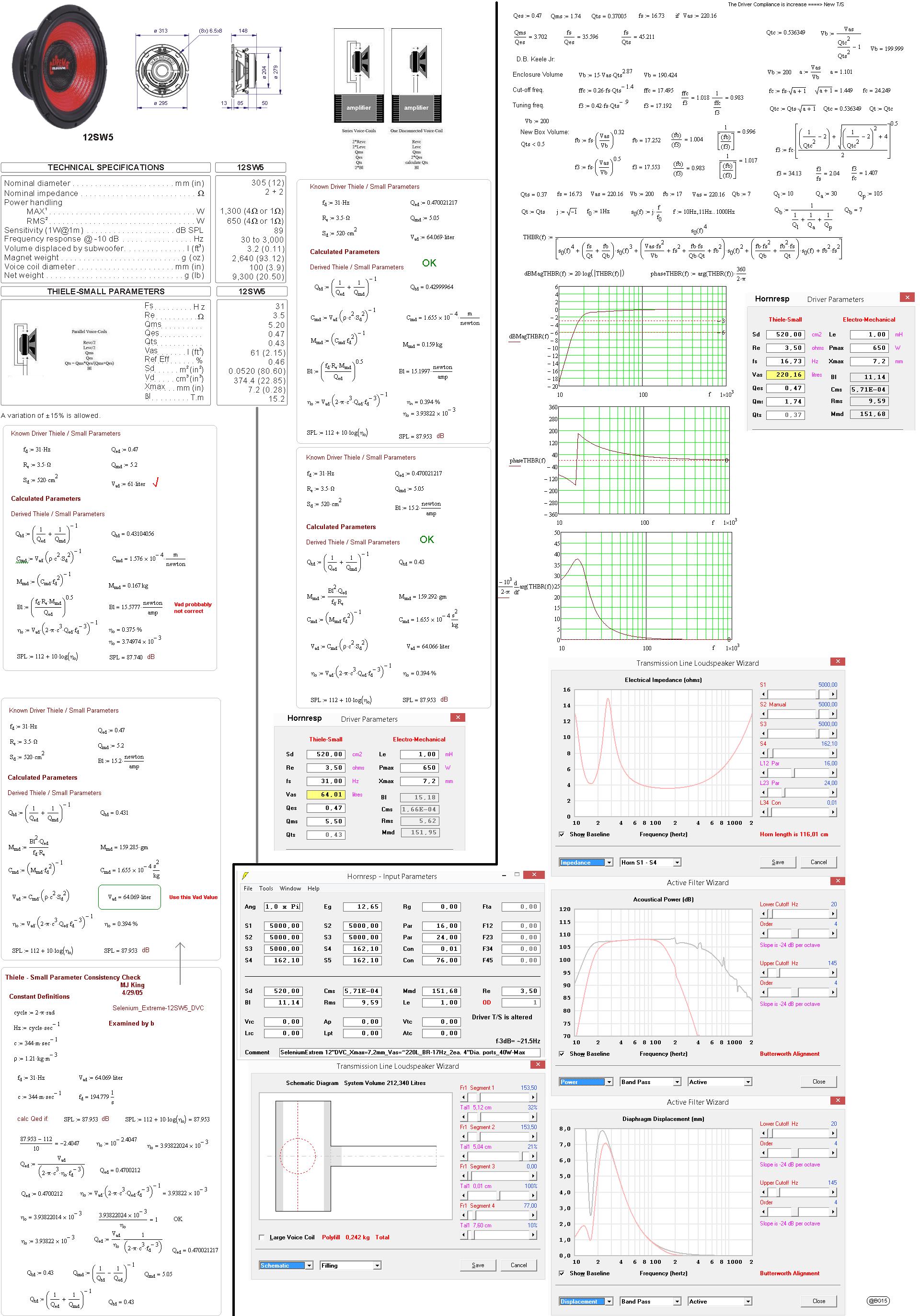

Post #1: "...reduce the resonance from 40 Hz to 24Hz. VAS = 220 liters and qts=0.37 after the modifications. I t was installed in a 200liter bass reflex box with two four inches pvc tubes not flared tuned to 22Hz..."
Vas=220L seems too high. I'll attach an example BR using the TC Sounds Epic 12", that one has Fs=24Hz, and Qts=.4. The Vas is 91.27L. Are your values measured?
Either way, you need to use a steep low cut (high pass) filter below Fb, or your driver will bottom out at just about any high power level signal below resonance.
Your ports may be a little too small, that depends on how much power you use. Try to keep the port particle velocity below 15m/sec in your designs. That would be a reasonable value, 10m/sec would be better. 🙂
I'll attach a Hornresp example (which should be Vrc=100L [or less]), you can just enter your T/S parameters, and take a look around.

I gave a second look at your thread and changing from a 12" to a 15" should be fine.
In top the priority (this if you are in the Brasil controlled market):
Selenium 15WS600
Selenium 15WS600 15" 600W Woofer
http://www.jblpro.com/ProductAttachments/15WS600_SpecSheet.pdf
Selenium WPU1505
http://www.selenium.com.br/sitenovo/admin/Documentos/WPU1505_i.pdf
Selenium WPU1509
http://www.parts-express.com/pedocs/specs/264-345-selenium-specifications-45221.pdf
Selenium 15SW1P (large Xmax, Xlim 9.3mm and 25.0mm. You can use to spec 800 RMS with right align/tuning on this one, maybe smaller box)
http://www.selenium.com.br/sitenovo/admin/Documentos/15SW1P_p.pdf

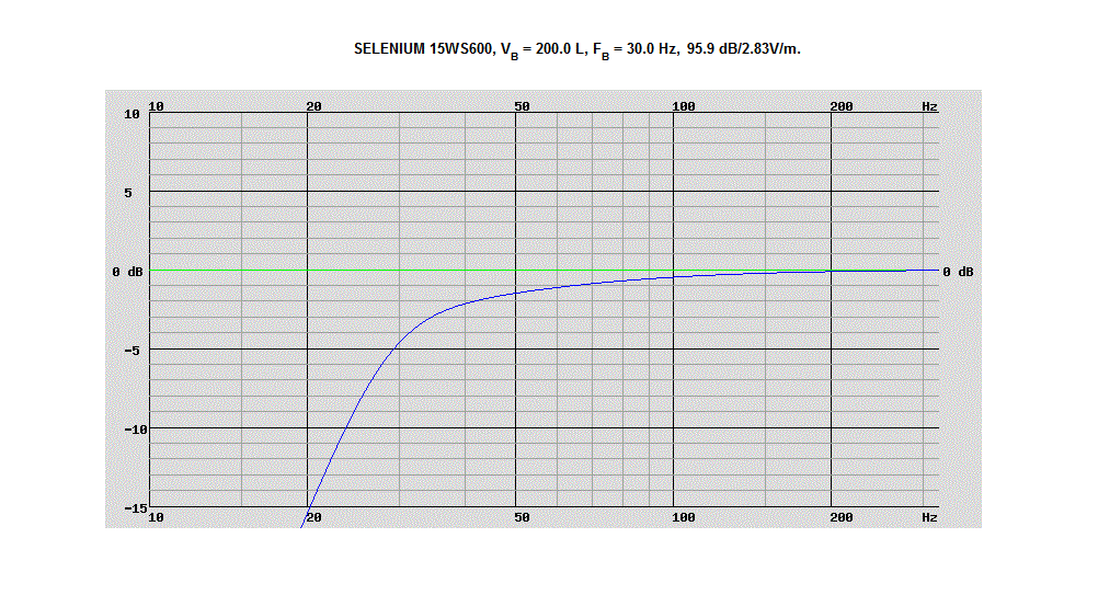

The problem with the SELENIUM 15WS600, VB = 200.0 L, FB = 30.0 Hz is that (with most of the Seleniums) you can use only RMS ~80W for Xmax... You can take your cup of venom!!!
If you opt for one of this drivers post it for further development. Have fun.

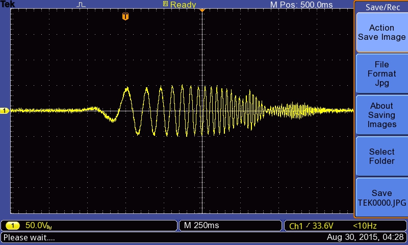

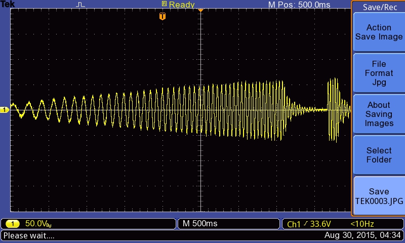

the project target is "just" THX ultra 2 spec - 130dB @ 30Hz, 122dB @ 20Hz, 112dB @ 15Hz 1/8 space, 1m with less than 10 % distortion.
In order to Measure this I use a calibrated microphone, which clips at 118 dBSPL, so I measure at 4 meters in the garden ( open field).

you were correct about the Inuke clipping... using sweeps from 10Hz to 200 Hz I got some very nice problems, as you can see in the picture attached.
Not sure if it is just clipping or a protection circuit being engaged due to the HIGH inductance of the speaker.
The sweep should be like in the tek0001 picutre, but the sound produced when playing the sweep in lower volume produced the voltage showed in tek0003, and it really sounds like a ehnnn let`s say loud Shot or speaker bottoning..
Thanks for the tip.
