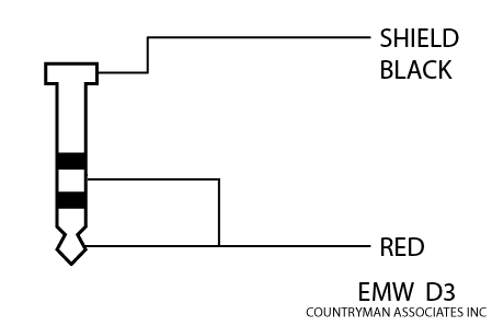

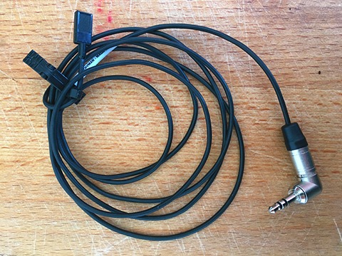

So, I finally decided to cut the existing TA4F connector and replaced it with a Neutrik 3.5mm male connector, soldered using a diagram for Zoom recorders 3.5mm plugin powered from https://countryman.com/microphone-wiring/.
Image from https://countryman.com/images/wiring/EMW_D3.png
From MEMWP05BAX (AX Diagram) to MEMWP05BD3 (D3 Diagram)
Working perfectly plugged directly into my audio interface (5v DC). Will use it with my custom XLR phantom power to 3.5mm bodypack hooked with XLR cable to my Zoom F4 Field Recorder.
