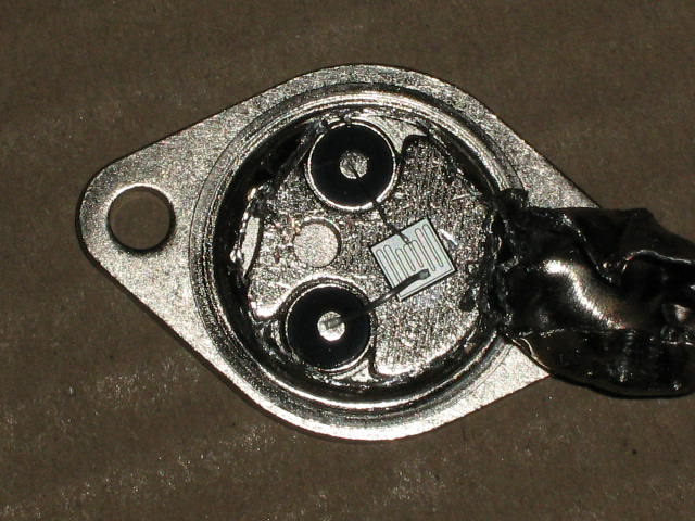

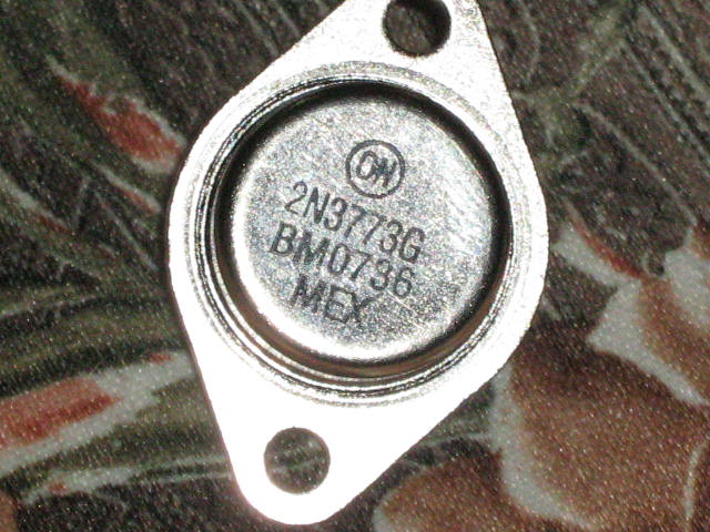

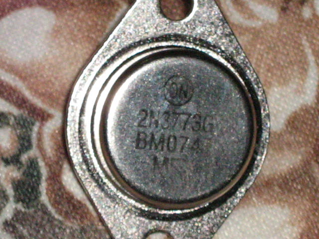

Hi all,
I just bought 2N3773s from a shop today. The shop I bought it from is a reputed one and the shopkeeper assured me that they are genuine On Semi transistors.
I came home and used nail polish remover and the marking began to rub off after some really hard rubbing. The liquid does not contain acetone but ethyl acetate, isopropyl alcohol, estasol, panthenol, tocopheryl acetate etc etc. Now, with so many chemicals in it, is it natural or am I possibly looking at counterfeit transistors. I could open up one but I don't want to unless there is really no other way I can tell.
Pics attached.
Pics attached.
If they are genuine ON Semiconductor they will be 4Mhz, they discontinued the slow parts years ago.
RCA (and others) made both slow and fast 3773s, Newark used to list both in the catalog. I only bought Motorola (which at that time only made the 4Mhz devices), so I couldn't tell you how the RCAs were marked. I did buy some Solitron 3773 that were so slow they wouldn't work in a BGW 750, hence the word of caution.
I would buy one extra part from your supplier and cut it open to make sure it's real, the $3 you waste is cheap insurance.
