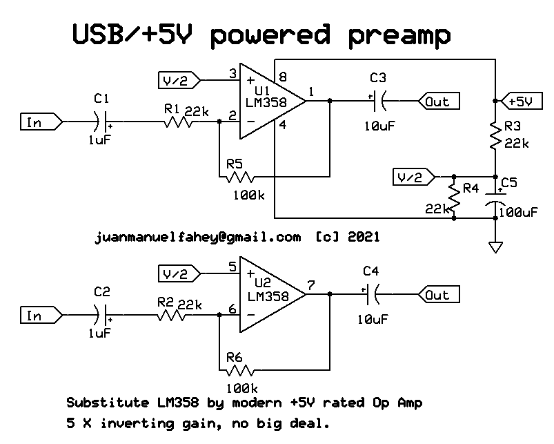

Computer/tablet/phone wants to drive singleton input amp with 50k load (there is no need for gain divider to use same resistor values, but it should have same proportion)
Previous efforts of buy another sound card, buy another sound card, buy another sound card, build simple amp with complex supply, build complex amp with simple supply all failed because of LTP caused a shortfall because computer things don't like it at all. Those are steadfast enemies.
So, I thought maybe it would be more doable to do the 'strap on' single transistor integrated buffer in front of a chip (the transistor is buffer for chip and is within global feedback loop). Then the computer/phone/tablet is driving that one transistor and the chip can do the amplification.

What is the original signal source?
Level? (in mV) Impedance?
Desired/needed level out?
A humble LM358 can do that, and be happy with +5V single supply, in fact it was designed for that task, over 30 years ago.
That´s the absolute minimum, there are far better ones today, but until you give us more details .....

2)
Also, the output of phone/tablet wasn't enough for line level even at max.
Now we are talking 😉
Try this:

So, I don't know what the output figure is and may vary by phone/tablet. . . but much to the point, being able to use it as a line level device without going past the headphone/ear/nanny level of most new phone/tablet output (which automatically resets back to nanny level periodically). At least it is determined to operate down below distortion levels. . . even though inconveniently not a line level device.
I though that I needed either singleton input preamp or 1-transistor buffer so the phone/tablet/PC need not 'bust a gut' with aggressive EQ settings. I really wish for small-signal version of TDA2003, but don't know if a tiny version was made not the model number for it.
Your example is absolutely brilliant! To get an average chip tamed, either very low current loops with non-inverting; OR!, for the easiest way for practical/useful tonality and low gain as well, just invert it. Awesome! That is another way to use the cheap phone/tablet source devices without overworking their onboard EQ.

358 slew rate may be low for audio...find a device with a rate of at least 8 and preferably 10 us/V, beyond 20 you will have problems.
Basically 5 V / 12 V versions of the TL072 / AD 797 / NEC 5532 / OPA 2134 series.
If not for audio, above circuit is perfectly acceptable.

OP is asking for a Preamp, not a small Power Amp.
And as clearly stated in the schematic, the LM358 is a "baseline" component which "will" work happily with only a single +5V supply; in the same schematic user is strongly encouraged to get a better one, BUT it MUST meet the very restricted 5V supply available.
TL072 / AD 797 / NEC 5532 / OPA 2134 do NOT work with +5V single supply and if they do, performance is abysmal.
As of typical Headphone out level, I regularly measure around 200mV RMS; not bad fr a Mixer Line In or Home Audio Aux input, definitely not enough for direct Power Amp drive.
+5V supply is very restrictive in the Analog World, but hey, OP asked for it, so ....
So kids, homework is go searching low voltage Op Amp datasheets and report back findings 😉

The datasheets usually say 'do-all' probably to sell more. But actually if wound up too tight it is unstable/shouts or if too chillaxin then it is dull; And, every chip is that way. I suppose that with small gain, there is not so much risk of getting the 358 overly relaxed/dull. Just sayin--it probably works better as a preamp than it could as a mic/turntable amp.
