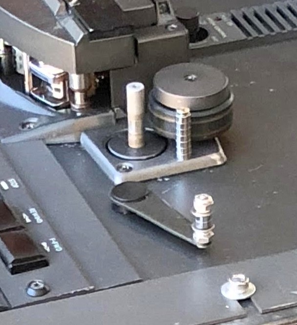

What you MUST do is the mod for the tape path:
Otari MX-5050/BII/BIII Tape Path Modification Kit Specs | Bottlehead
With ten bucks you can do it: eBay 6x3x3mm miniature ball bearings and M3 iron bolt and nuts. The washers should be non-metallic though.
