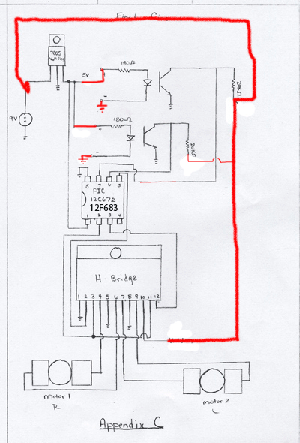

But I have a PIC12F683, which I wanna use in building a coooool line following robot. I got this circuit...
And this code was written for PIC12C671, but I'm using new flash based PIC12F683. Can I use the same code for PIC12F683////the code is

The short answer is: probably. If you feel like winging it, just change the target and see if it compiles in MPASM.
But for the sake of learning something, you should go through the code step by step and understand what it does. Look at the datasheets for the two parts and compare the register settings. Ultimately, you should aim to understand the entire design.
Dear Paswa,
Don't bother. MPASM is the Assembler inside MPLAB. Do you know how to write Program in MPLAB IDE? Do you have programmer to load the Hex File from MPLAB to the PIC? You should have, otherwise no use of writing the Program.
There is some difference between pic 12c671/672 and pic 12f683. 12c672 is having 4mb internal oscillator but 12f683 is having internal oscillator of 8 mb. So, timing calculation will be different.
Whenever changing over to new pic, you have to change the header file.
So, when you go to pic 12f683 from 12c672, you should write,
list p = pic12f683
#include <p12f683.inc>
config???
If you don't mention configuration bits according to pic 12f683, program will not respond.
Then change the program according to pic 12f683.
Your schematic is also not clear to me.
What is the purpose of 2x 9v inputs to Pic?
Try to find the full schematic.
Thanks.
The program of 12c672 you have given is not fully correct and hence if it is converted to pic 12f683, it will not work.
In the Header File, Configuration bits are not given and hence Programmer can not detect what type of PIC it is.
After org 0x00, it is written reset. In PIC 16F series, there is no instruction as reset. Moreover, you cannot reset the PIC after 0x00, because 0x00 is the reset vector address and hence whenever pic resets with Master Clear switch or any other means, it will return to 0x00 address.So, it will remain in reset vector address and will not move forward to carryout further instructions. Reset should not be used and after org 0x00, next should be goto start.
In your schematic, it is found that pin2 and pin3 of Pic 12c672 is used as input/output pin and hence it is clear that external oscillator is not used and so internal oscillator is used. But in the Program, there is no instruction is written to bring the internal calibrated frequency through bringing the data incorporated in the Program memory. So, the Pic will not work as it will not have any oscillator working for it.
Find out the original schematic and the program. If you are not acquainted yourself, in most cases you will find difficulties in following the program/schematics in the Net.
With thanks.

I've changed the schematic a bit...I hope now it is correct. And again, the scheamtic is not mine it's just from a website. there was only one 9V battery but the schematic-drawer made a error, he put 2 9V batt. I've a more advanced plan to use 2*AAA batteries instead of a bulky 9v batt. and 7805.
If you can write out the code for me or correct the previous one, there would be a lots of help...because I have a plenty of xperience in analog and digital circuity(though I'm a school student) but I'm just a learner of Microcontroller programming..Please help here... 🙂
