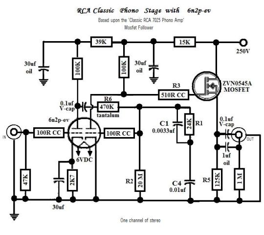

Kevin has made 2 important points: you don't need a line stage, as the Simple SE has control over the listening volume and a budget of approx. $250 is extremely tight.
About 65 dB. of NET gain are needed with a 500 μV. LOMC cartridge. Due to cost, SUTs are out and you can't get satisfactory noise performance employing 100% tubed circuitry. IMO, the only option is tube/SS hybrid circuitry. Allen Wright's hybrid cascode will provide sufficient 1st block gain. Follow with "all in 1" passive RIAA EQ and a MOSFET buffered 2nd gain block.
A single ElectroHarmonix (EH) 6922 will do quite nicely at the top of the hybrid cascode, for both channels. You can appropriate the 2nd gain block and buffer circuitry from the schematic I've uploaded, but that is 1 option among many.
