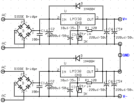

Hi Jarros, if you still wanted to do P2P maybe this would help.
Stan

One thing I noticed in digi01's post regarding the regulator was that the trim pot allows the output voltage to be adjusted from 20V to 32V, which is a little high for the range I'm looking at.
I just noticed that in the Class D forums motherone also used digi01's regulator board, but made a few small changes as noted in this post. I'm a little unsure as to where these changes take place in the schematic, so I asked in that thread as well. One change includes using a LM1085 regulator instead of the LM338 that digi uses. Would this enable me to set the regulator to 13V, or should the LM338 be able to do this aswell?
