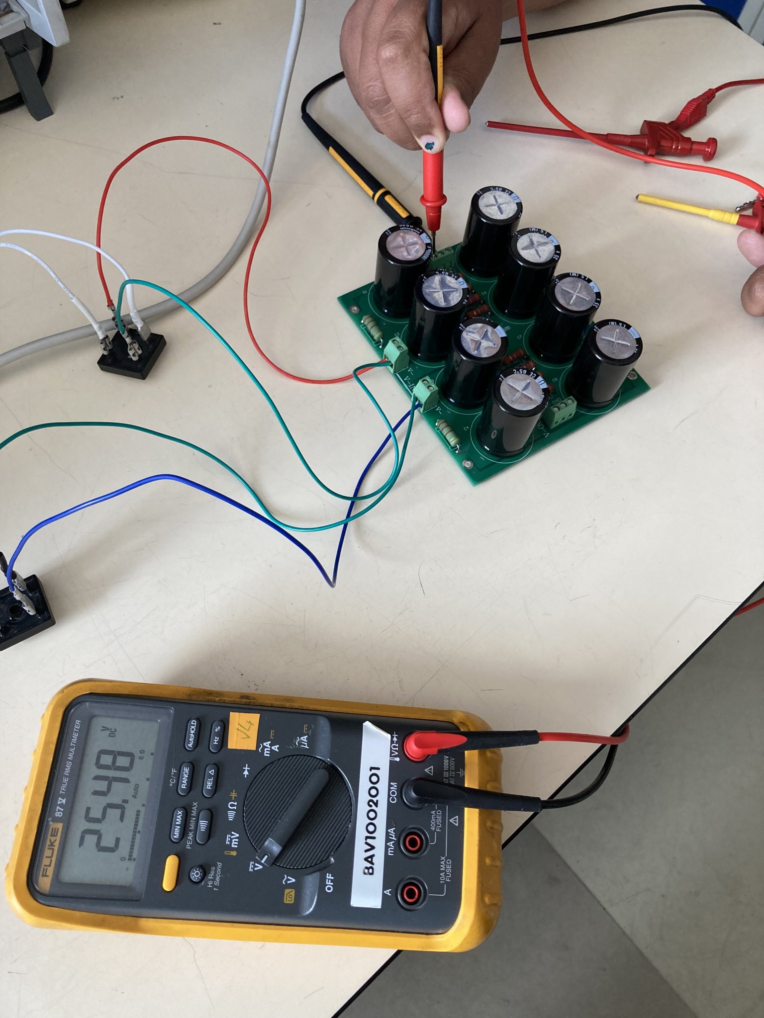

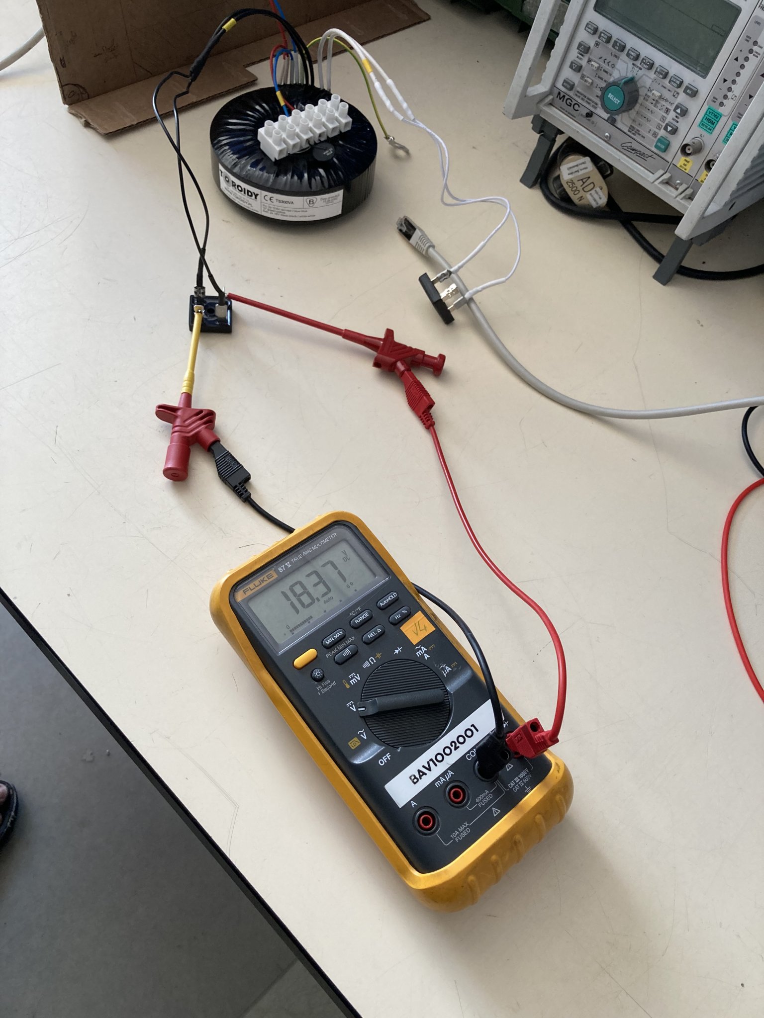

Hi.
Just to close the subject properly:
Did the check with somebody experimented. Works as intended with 18v after the rectifiers and around +/- 25v after the capacitors bank.
