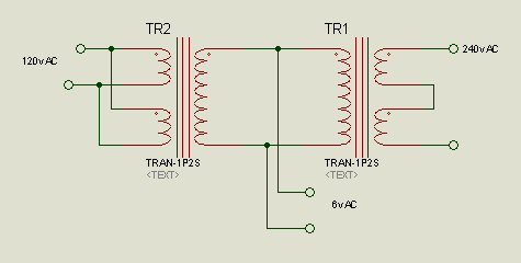

You can almost always get the voltages you want by combining 2 transformers.
Here's an arrangement with 2 * 120/240 -> 6vAC transformers. Due to inefficiencies the voltages you get may not be quite as high as nominal, but you can overrate the transformers. Better to use a voltage higher than 6v for the intermediary, if you can run your heaters in series. Don't forget that supply voltages also vary, so at some times the output voltages may be higher than you anticipate. The range can be determined by asking your supplier and using this information in conjunction with the transformer datasheet which will tell you how the transformer output will vary with loading.
One 50VA + one 25VA will give you ~4A @6v and ~100mA @ 330v
w
