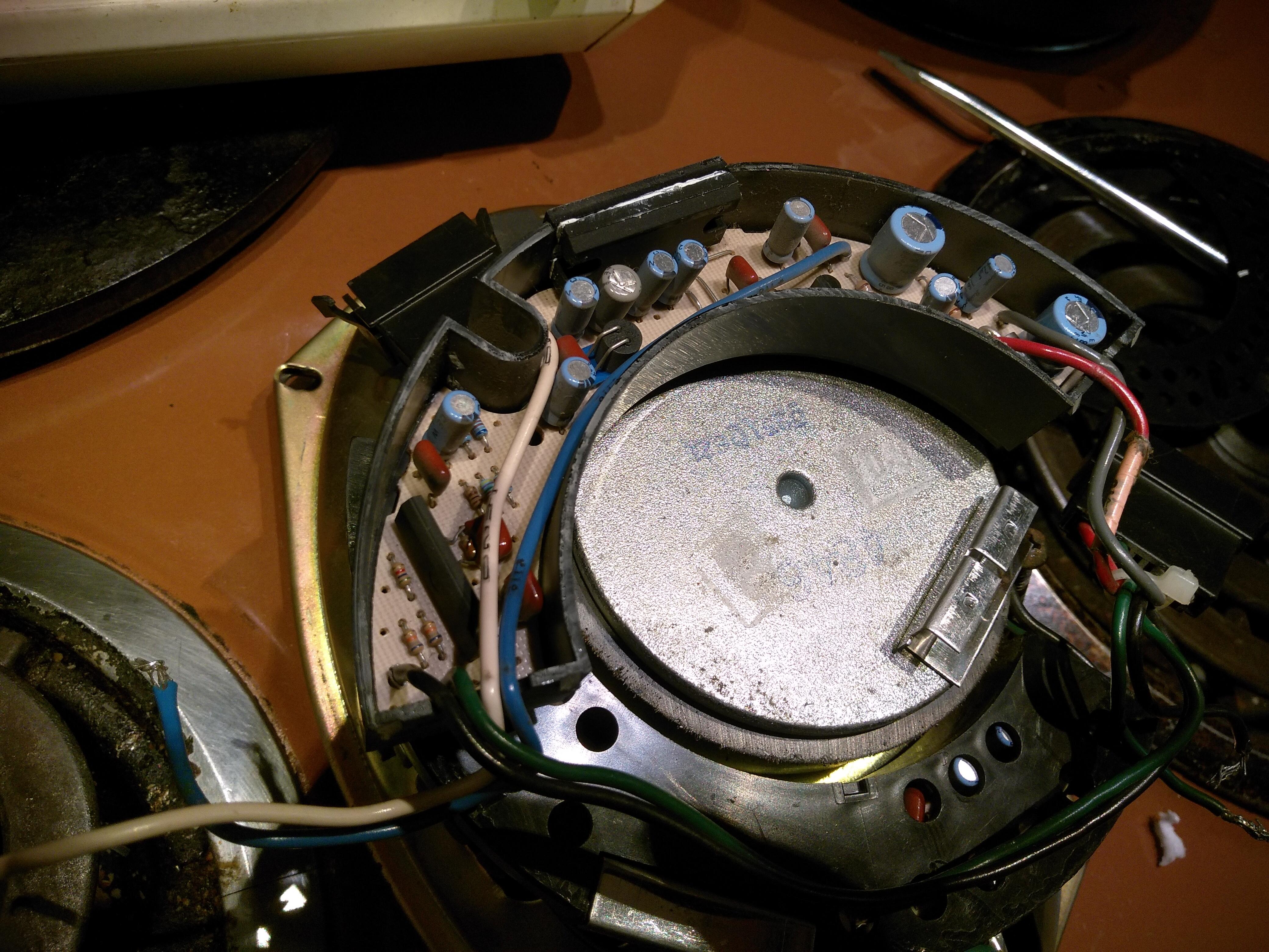

I did a forum search on the NEC Chip used in Chrysler Minivans from 1991 to 2000 & the Infinity Acoustic 10 equipped Cars & system. only found I think 2 posts about this chip. There is an Nice post about the History of these systems here on ALLPAR if you are a Mopar fan.
There is also a Blurb on how to fix these speakers that came with the amps if you are into that sort of thing. But it covers a few more tips on how to repair them.
if you take a look at them, here is the Wire diagram of how these complete units get hooked up if you want to just pull a set and go with it for projects.
  • Red – amplifier 12V input
  • Green – speaker level audio input from head unit, positive
  • Black – speaker level audio input from head unit, negative
  • Gray – amplifier ground
